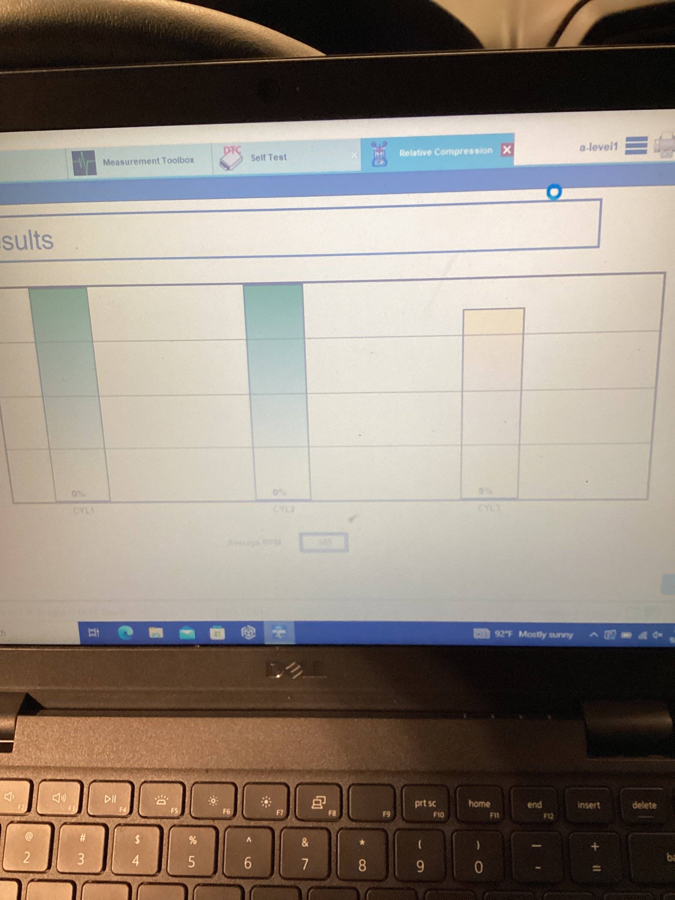

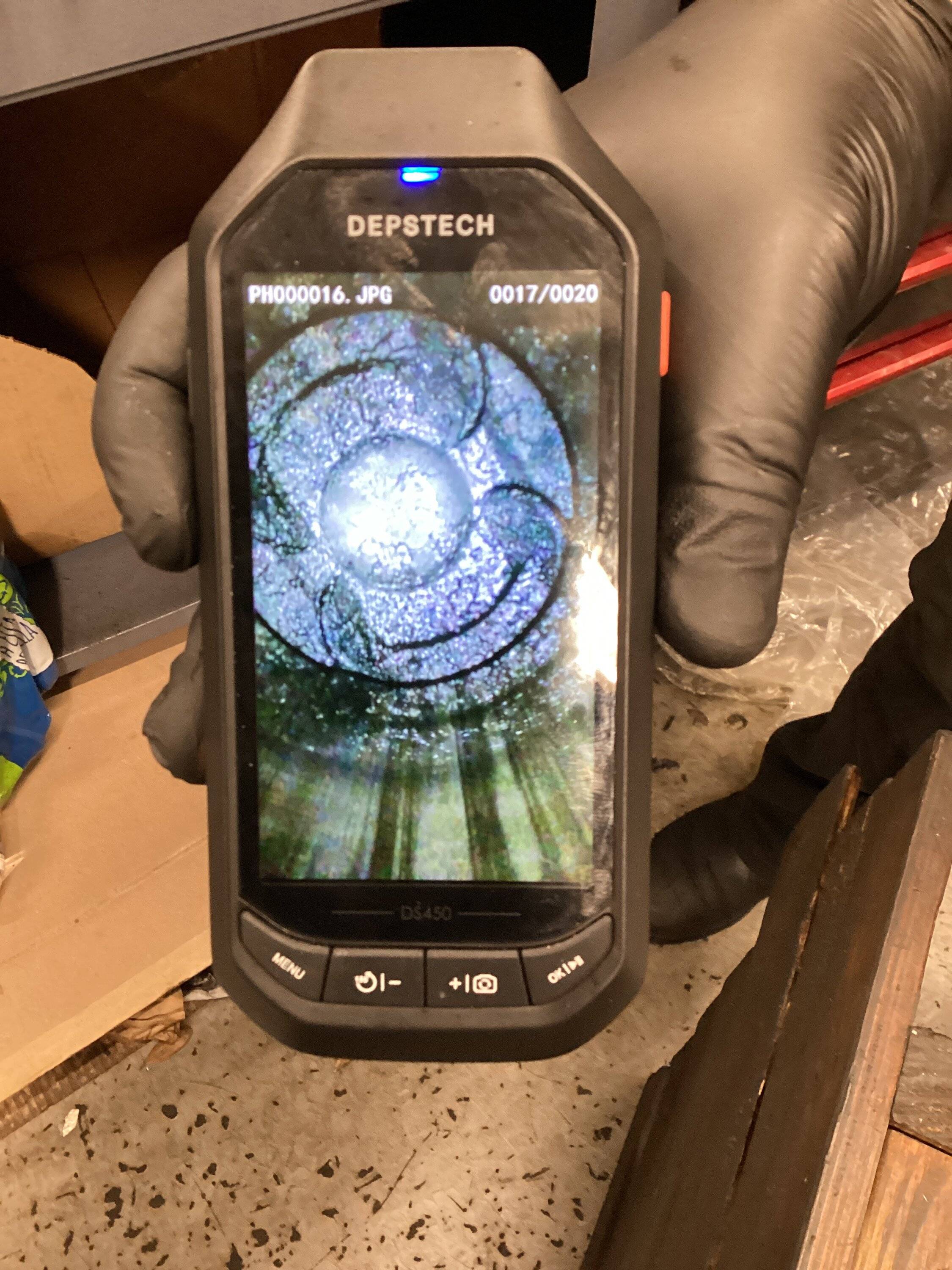

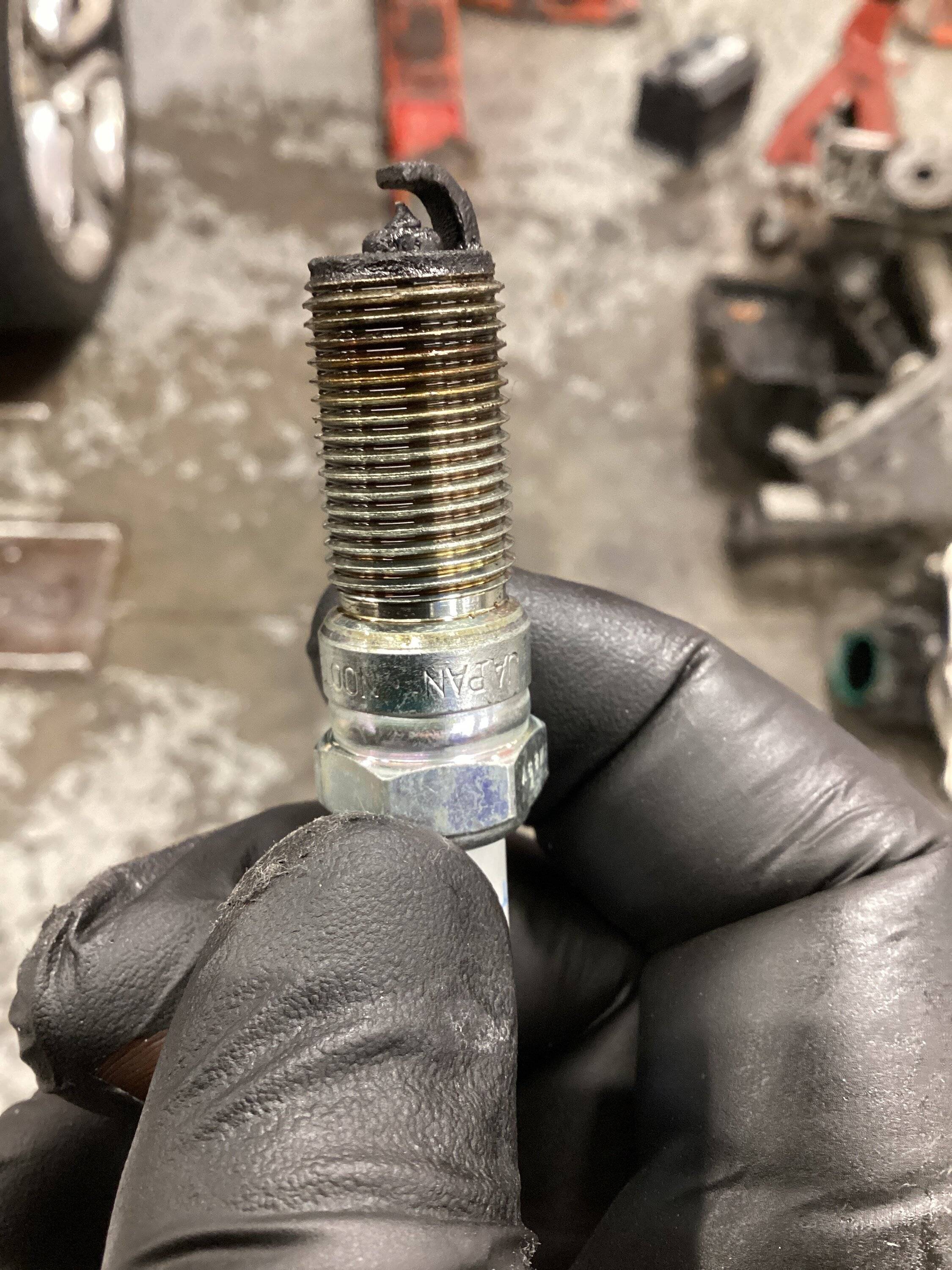

Hi everyone! I've searched this site for an issue like mine. I do apologize if this has been done before. Took my 2023 BS Outer Banks to my Ford dealership as it was hesitating badly when accelerating. There was also a knocking sound coming out of the engine and the vehicle would buck when stopped (I turn off the start/stop). They told me I needed a new engine as one of the cylinders was scored. Seems one of the gaskets was defective and leaked oil into it and burned it all up. I won't be getting my BS back until early November hopefully. Anyone else with this issue? I attached the photos the dealership sent me.

Don't see too many Sports having major engine issues. Hopefully dealer is providing a loaner car. Also they need to repair the vehicle within the time frame specified by your states lemon laws so I would look into that.
