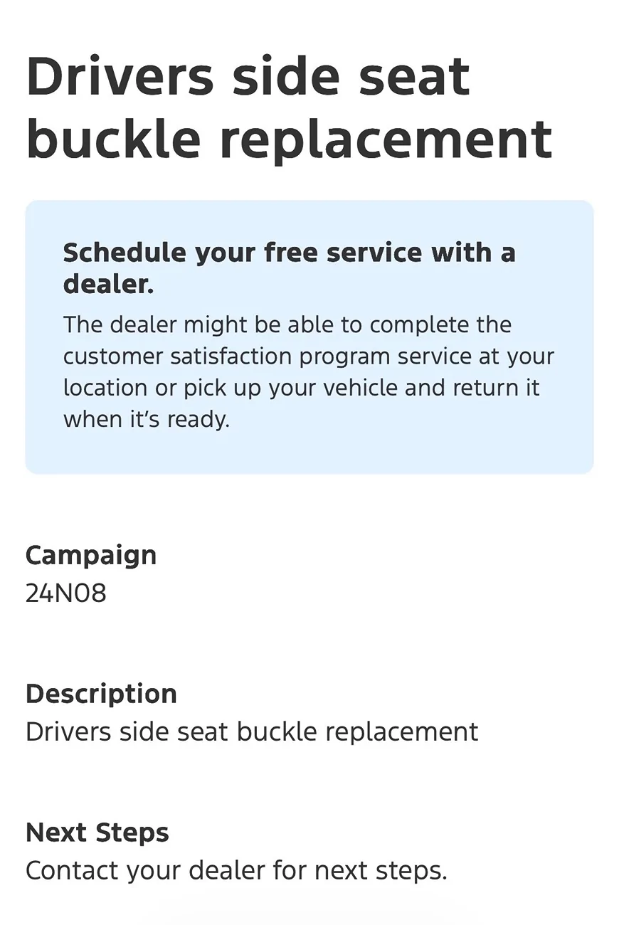

I'v had my 23 Badlands for 3-4 months now, and have had the noise appear 2-3 times. Annoying sound more than anything. I'll see if i can have that taken care of in the coming weeks along with my Recall for the driver side seat buckle.
112
4,465
5,269
If you are referring to customer satisfaction program 24N08 other owners reported the dealership told them the driver side seat buckle will only be replaced if found to be defective

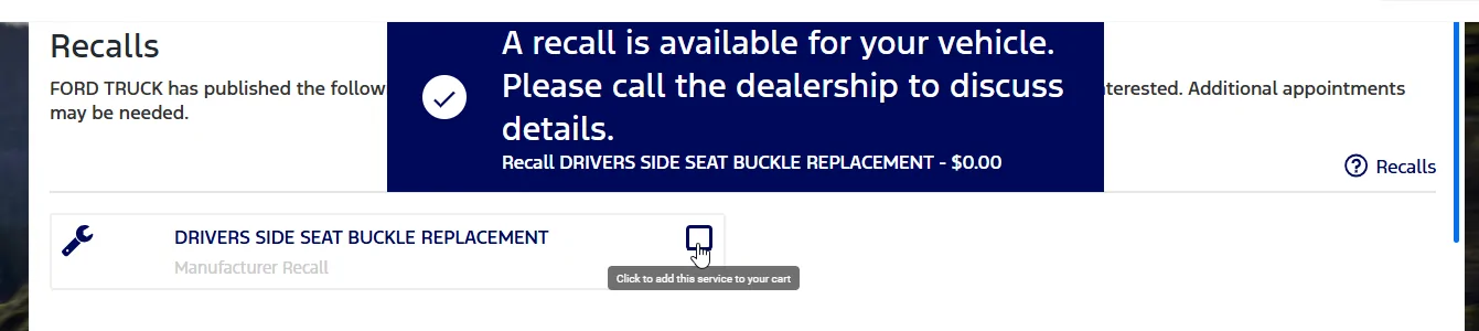

Agreed. However, when I was looking to schedule service, it said I had a Recall for the seat buckle.
