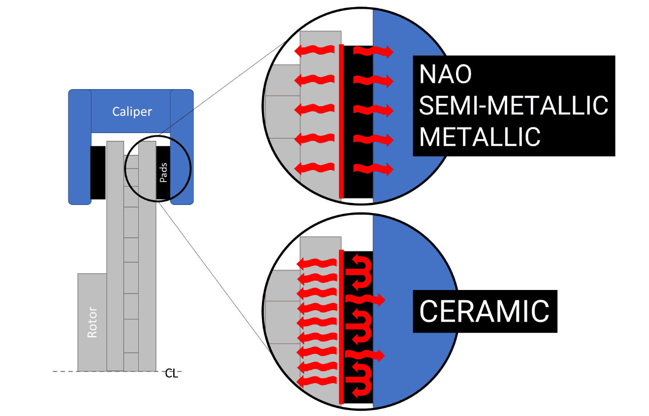

The more heat the pads absorb, the more heat will get passed on into the caliper/fluid/lines.
Makes sense. This graphic is a good illustration:

Ceramic is a great insulator, which is why they used it on the Space Shuttle. You can see in the video below that the heat simply doesn't go through to the other side of the tile.
I think the primary danger is overheating the rotor, since heat that would have transferred to the calipers stays in the rotor.
