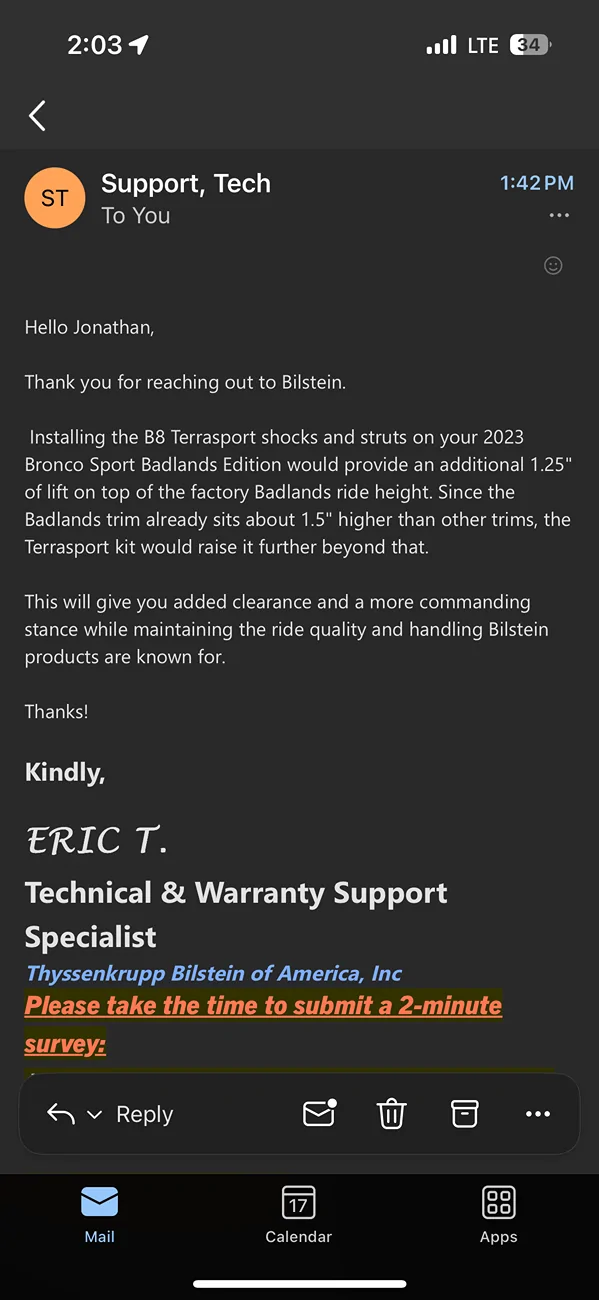

I am currently between two different lift options for my MY23 Bronco Sport Badlands. I am either considering the Bilstein B8 Terrasport Shocks / Struts or the Eibach Springs. Now The B8 Terrasport Shocks say they provide 1.25" inches of lift. Does this mean for any Bronco Sport or specifically the badlands? Their website doesn't make it entirely clear as the badlands already comes 1.5" higher than the OBX & BB.
Eibach Springs specifically say for the badlands its +1.0" in front and .75" in the rear.
Has anyone had the chance to swap out their shocks for the Bilstein B8 Terrasport / or done the Eibach spring swap? Looks for pros and cons of both and overall best for longevity.

@jonsfiend this one piece of info in Bilstein’s email “the Badlands trim already sits about 1.5" higher than other trims“ (regarding B8 Terrasport shocks and struts for 2023 Bronco Sport Badlands Edition) … the ‘23 Badlands doesn’t sit about 1.5” higher than other trims (as far as I know) so is it possible Bilstein answered for the full-size Bronco?
The Bronco Sport Badlands does sit about 1.5 higher than the outer banks, big bend, and base model from factory some refer to it as a "lift" . This is coming from a former MY22 OBX Owner I had them side by side before I traded one for the other 😂
On the badlands Its a spring lift system because it has the HOSS 2.0 System that's why Bilstein stated you must use factory springs. Also - he specifically says in the email Bronco SPORT badlands. I have a lot of faith in them I doubt they didn't do their R&D and responded with info they where not certain of. I will totally be going down this road sometime after the Holidays and keep everyone updated! (Money is a tad tight at this moment)

Yeah I was going to do the Eibach Spring lift with 245 tires made me feel best since it wouldn't put too much stress on any components of the vehicle. But with Bilstein dropping their shock set I knew it was the most reliable and non warrantee voiding option around. No disrespect to Flat-out - HRG or any of these company's offering these lift kits with spacers and other questionable longevity issues. I had Bilstein's on my 150 and it was an overlanding off-roading monster. They always get my vote of confidence and surprisingly not costly install or material!
