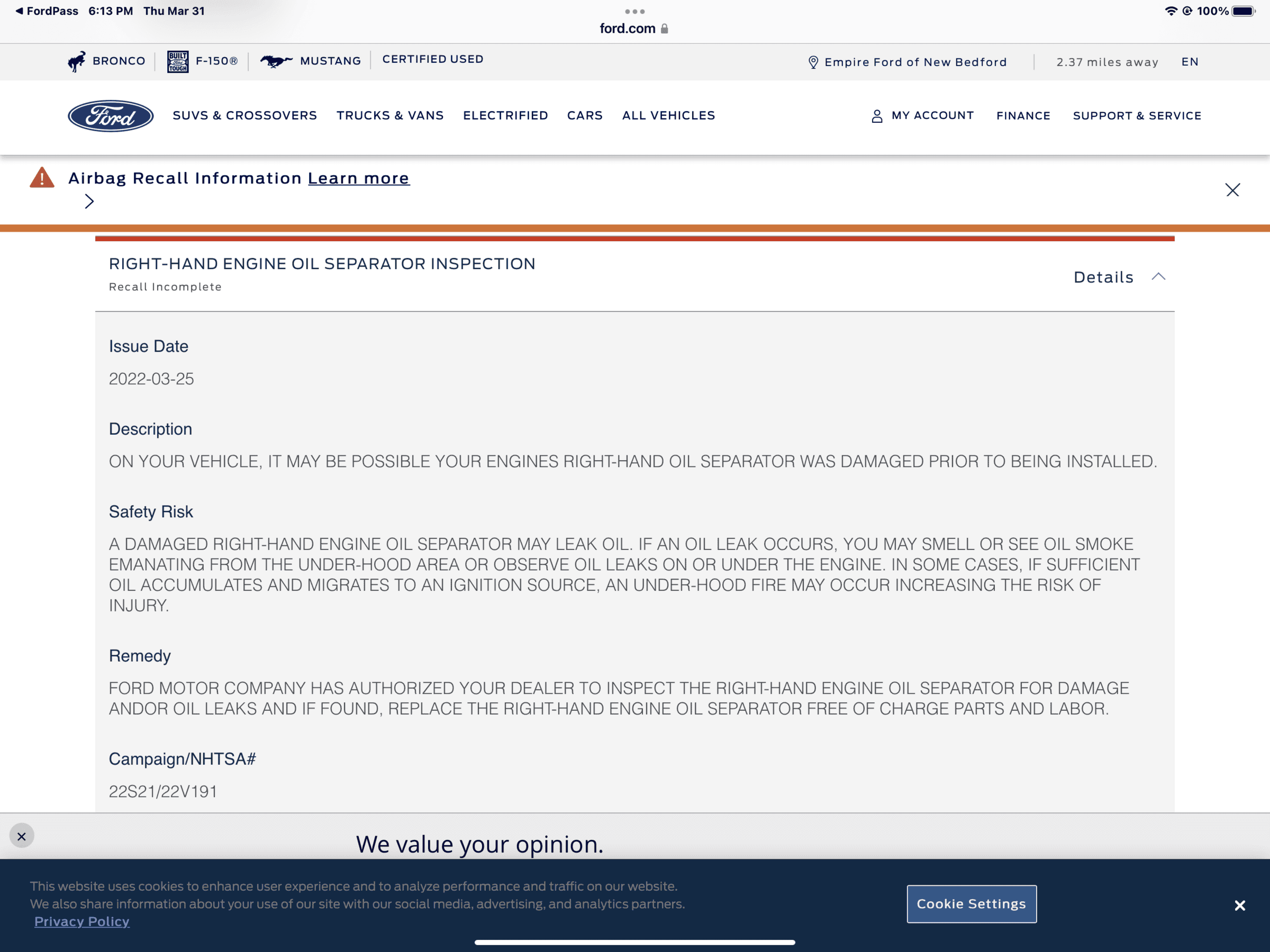

Has anyone received this recall also ? What is the fix for this ?
Mar 25,2022
Manufacturer Recall Number22S21
NHTSA Recall Number22V191
Recall StatusRecall Incomplete
SummaryON YOUR VEHICLE, IT MAY BE POSSIBLE YOUR ENGINES RIGHT-HAND OIL SEPARATOR WAS DAMAGED PRIOR TO BEING INSTALLED.
Safety RiskA DAMAGED RIGHT-HAND ENGINE OIL SEPARATOR MAY LEAK OIL. IF AN OIL LEAK OCCURS, YOU MAY SMELL OR SEE OIL SMOKE EMANATING FROM THE UNDER-HOOD AREA OR OBSERVE OIL LEAKS ON OR UNDER THE ENGINE. IN SOME CASES, IF SUFFICIENT OIL ACCUMULATES AND MIGRATES TO AN IGNITION SOURCE, AN UNDER-HOOD FIRE MAY OCCUR INCREASING THE RISK OF INJURY.

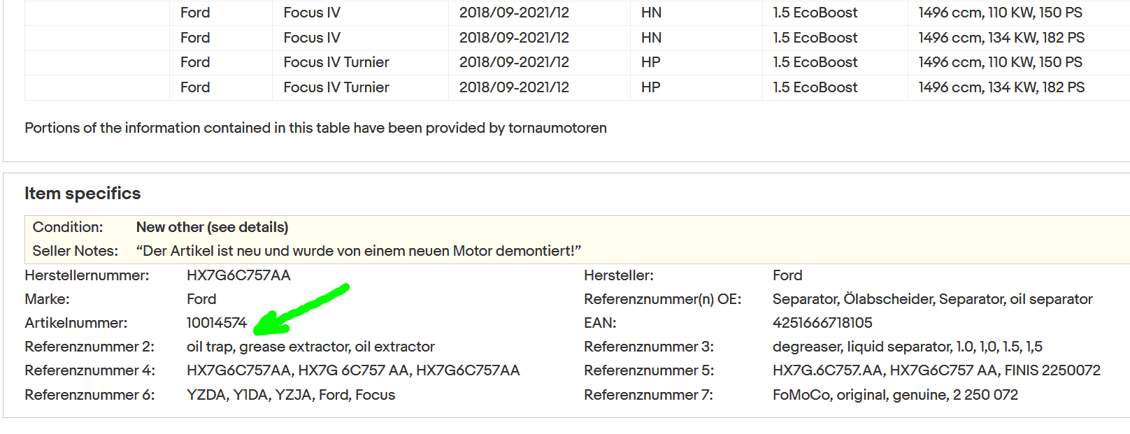

Wondering if this is the culprit???
If so, stating right-hand might imply there is also a left-hand separator?
Outward appearance doesn't show a catch-can waste valve or removable collector. I'm curious if this is the Ford version of a catch-can.

Well that's cool. I wasn't notified but I do see it was added to Ford Pass on 3/25. I don't have smoke billowing out and I'm not leaking oil, so I'm going to guess I'm good here.
Thanks for posting.

This recall only affects the 1.5L engine and not the 2.0L that is in the Badlands and the First Edition.
Ford Bronco Sport RECALL on oil separator 1648764755293
Ford Bronco Sport RECALL on oil separator 1648764995374
No, it's not (directly) related to a catch can; an oil separator is a normal part of many of these modern engines, my VW one similar to this right on top of the engine. It condenses the oil and sends it back to the crankcase, while the air and remaining vapors go back to the intake. The can catches oil plus a lot of water often, and you routinely empty that yourself (and do what with it?).
