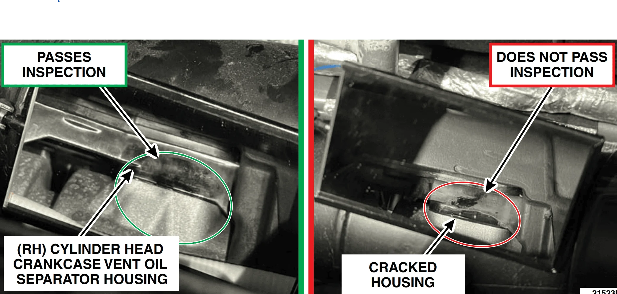

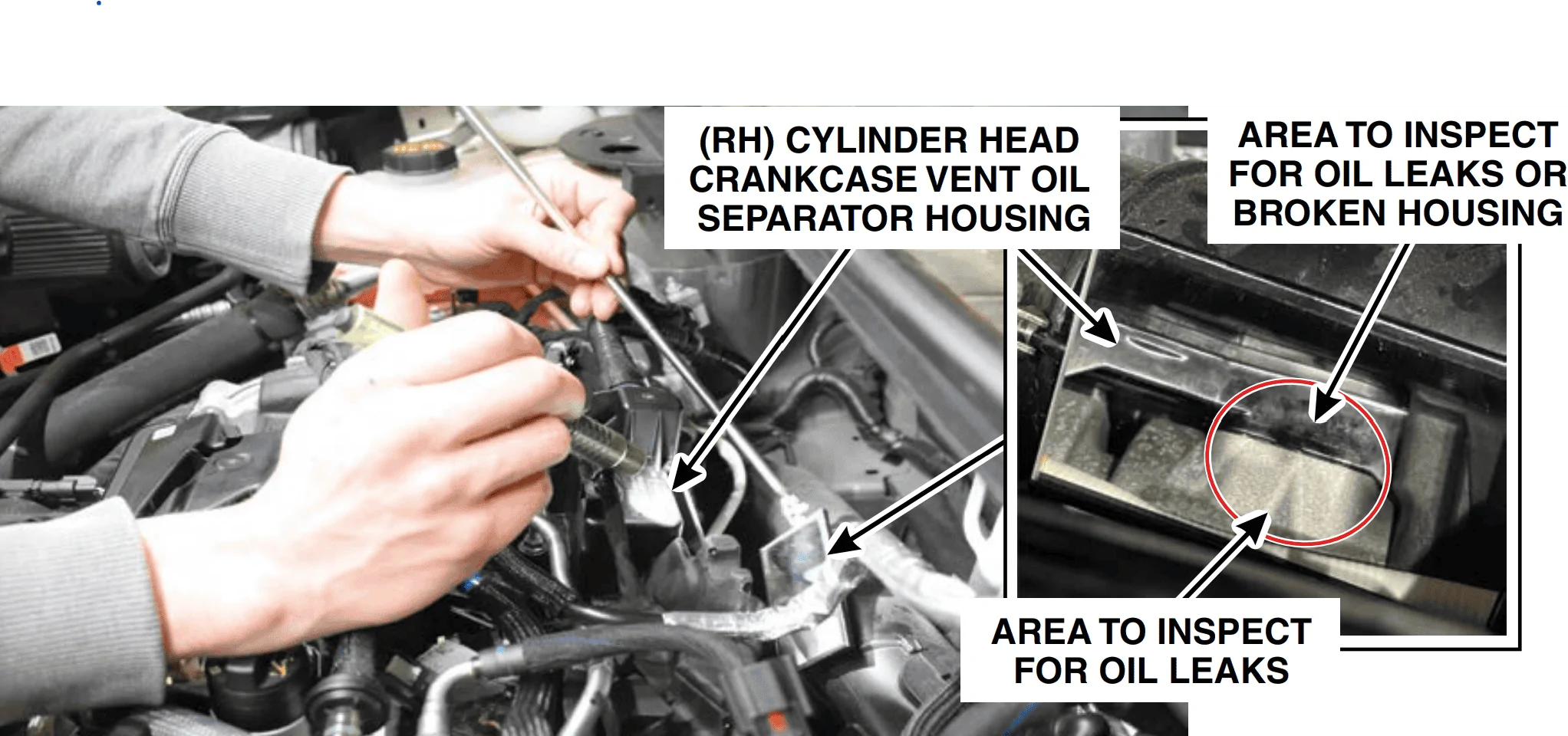

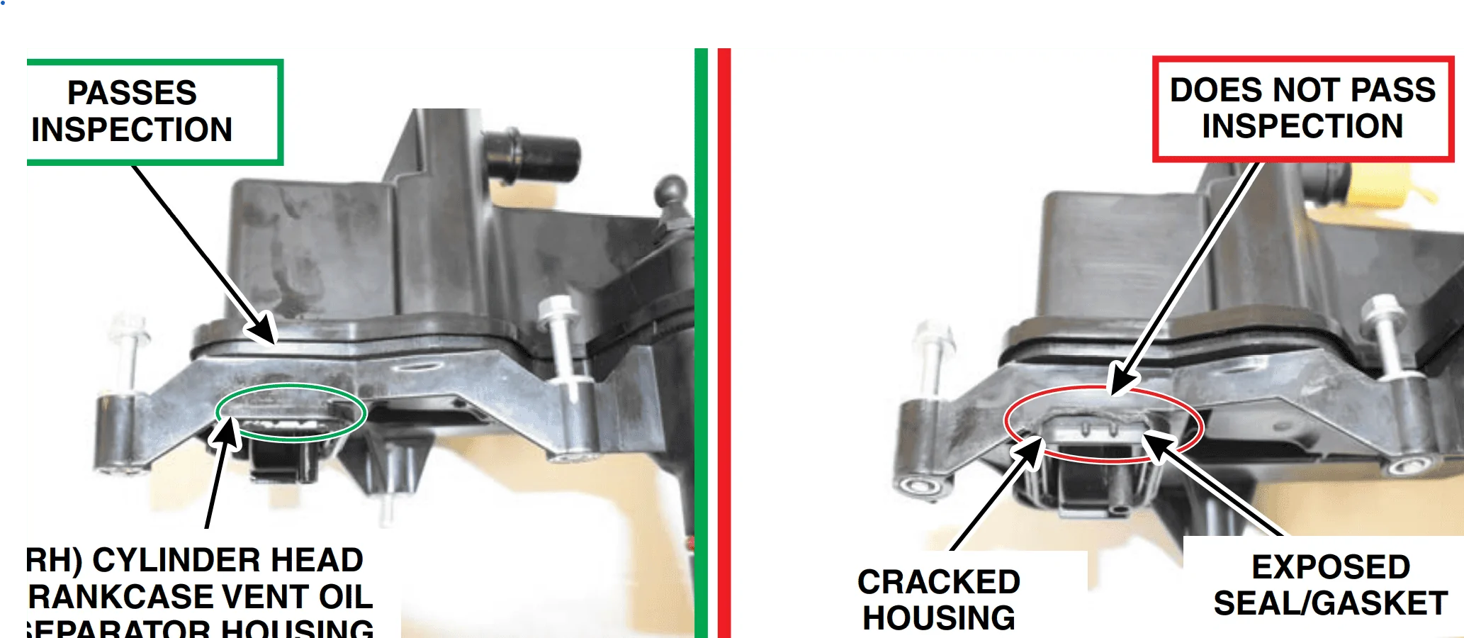

It is Not the front separator that has the potential problem, it is the one in the rear. It is called the (RH) Cylinder head crankcase vent oil separator.
Ford Bronco Sport RECALL on oil separator 1651263483615
You will need to look at the back. You can use a mirror to make it easier. We lucked out and ours is ok. Earlier Jan. build.
Potential problem:
Ford Bronco Sport RECALL on oil separator 1651263587729
If this was the Front separator, probably wouldn't have been a safety recall.

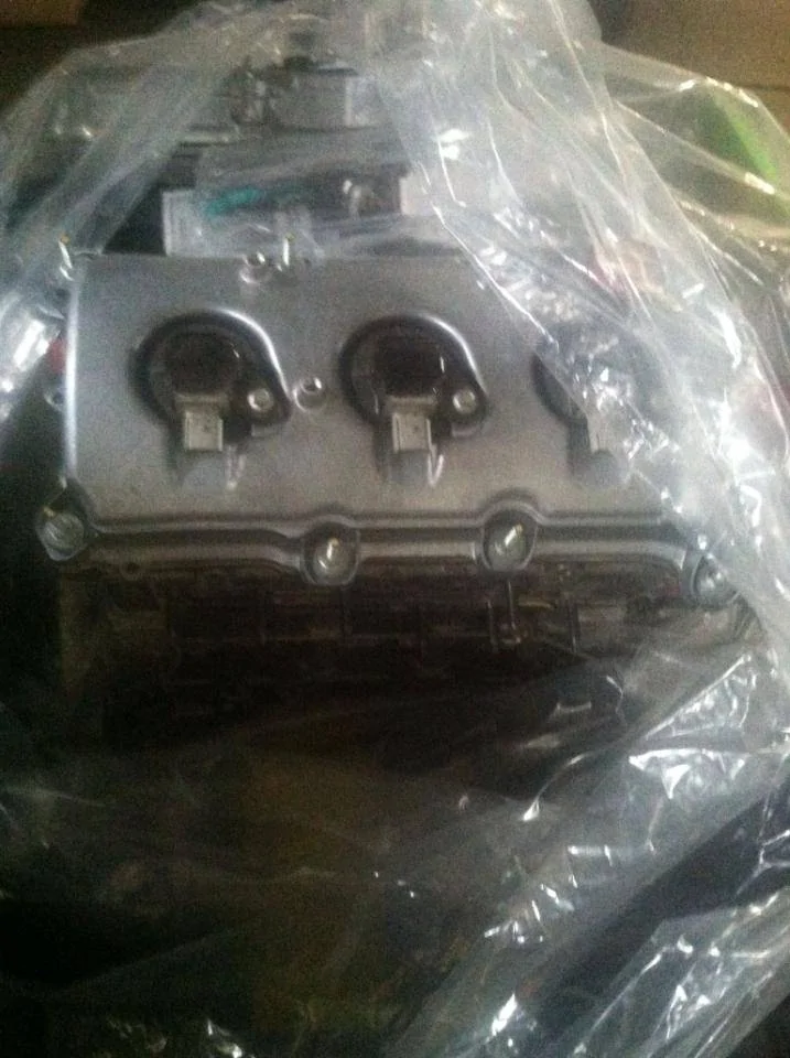

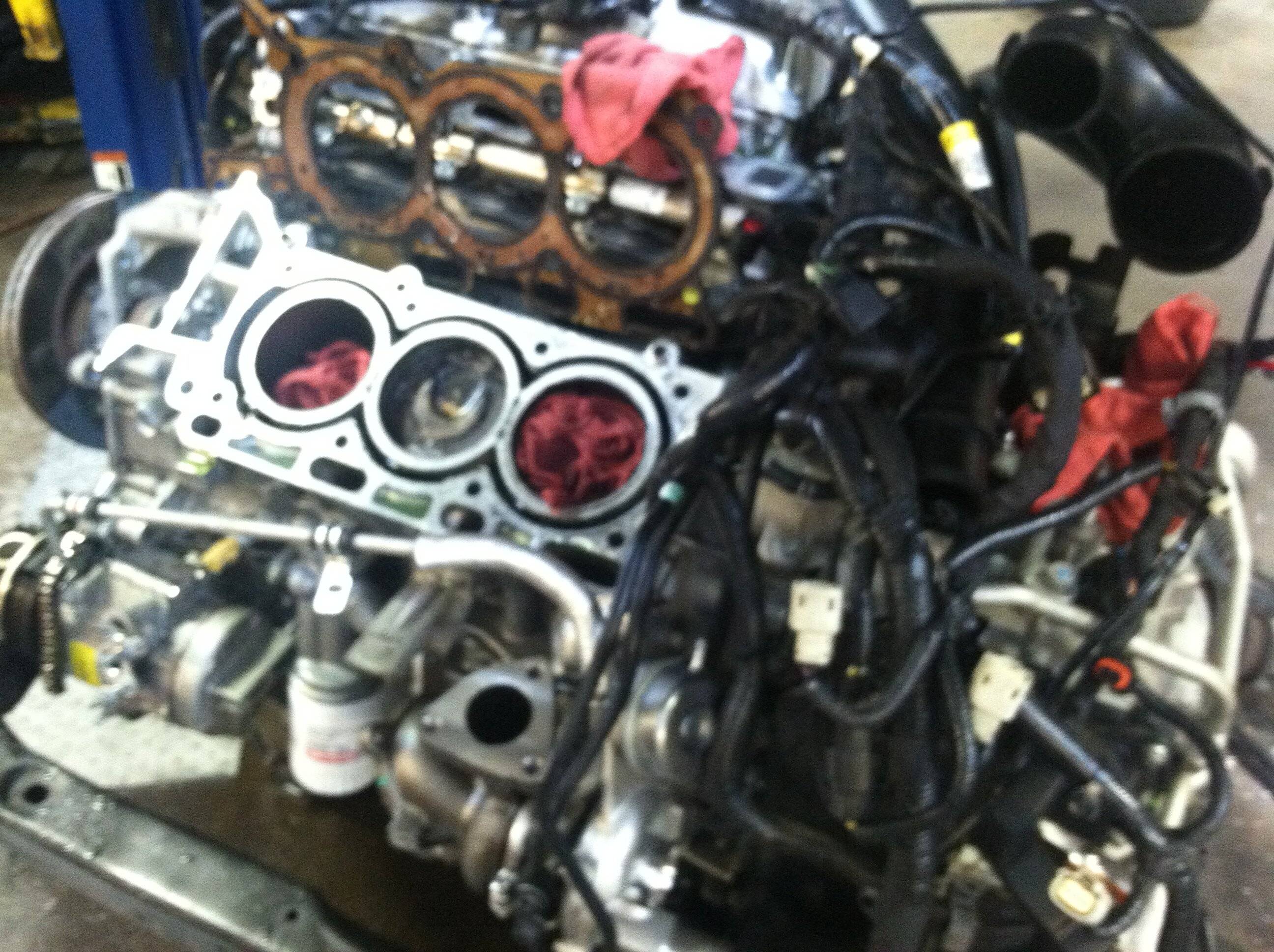

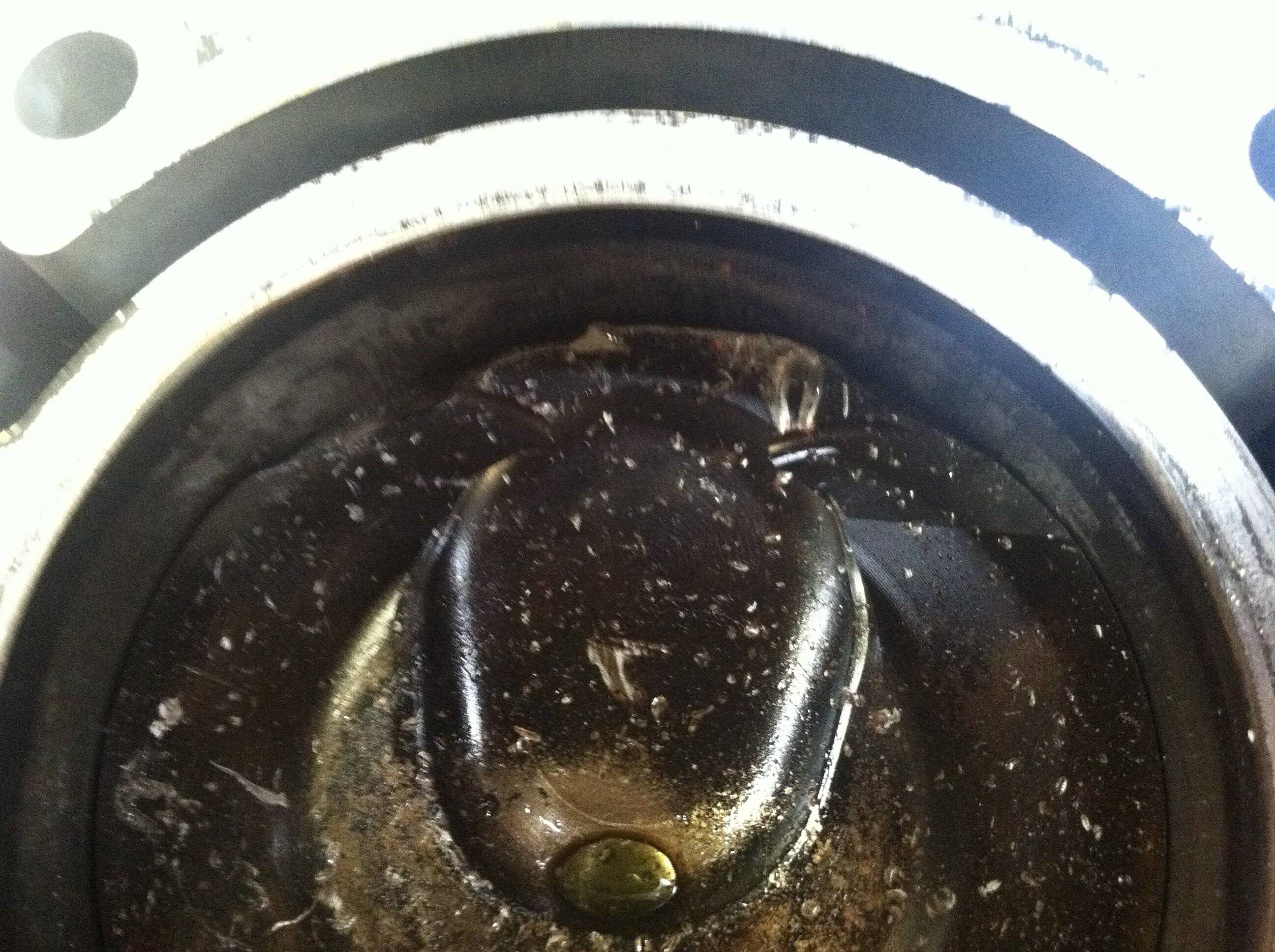

I trashed my 3.5 Lincoln MKS engine with 18000 miles, smoked it on the highway at 70 mph . It was 1 1/2 years old , ford dropped a new engine in it . All good after that . Oil separator was the issue. This was back in 2012 / 13 . You would have thought by now they would have come up with a better material to manufacture that part .
