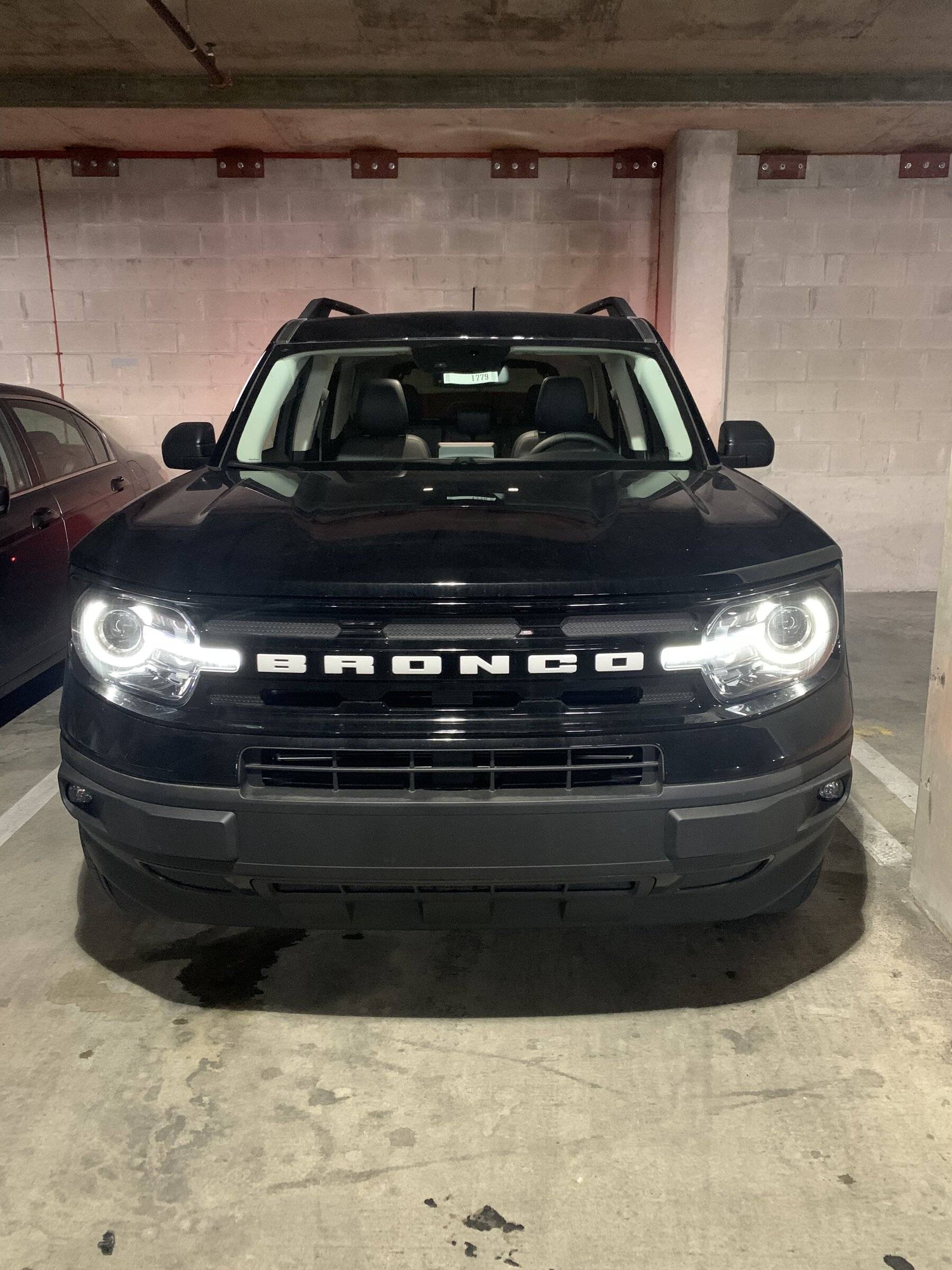

I did. Went after work on Monday and picked it up. In a weird way I can’t believe it’s finally mine after thinking I wouldn’t be able to drive it until July.
I’ll see y’all around the board. Pics soon.
