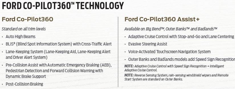

Here's the differences in the 360 option:
Ford Bronco Sport co-pilot 360 vs 360+ co-pilot differences

Hey everyone! I'm sure this has been discussed before but I couldn't find it in a quick search. I'm just making sure I understand the differences. My understanding is the BS comes with co-pilot 360 which includes the adaptive cruise control and lane monitoring, where as the 360+ adds to that with the speed limit sign detection as well as the lane centering and evasive maneuvering if necessary. We went with the regular 360 since as we really wanted was the adaptive cruise control, I'm just making sure I didn't goof in that decision.
Thats the breakdown I was looking for originally. Too late now, but I think the only thing I'll miss is the adaptive cruise control but the way we'll use the vehicle I think we'll be alright. If not....I can always order another one lol

So, with 360+ it detects things like parked cars when backing up. But with those additional front cameras, does it detect or warn you of things in front of you when parking?
I’m curious because this would help in parking in the garage.
The rear parking sensors are separate from co pilot 360 and 360+ and part of the convenience package (big bend package on 2021). It adds a couple more bumper sensors like the ones that are used for blind spot monitoring and cross traffic alert. I don't believe there is a front sensing system available on the Bronco Sport. The camera in the windshield is used for lane keeping and collision assist. There is a camera in the grill on the badlands that could be used for parking I suppose but that isn't available on any other trim.

I use my front camera for parking CONSTANTLY. big fan.
Yes, when I found out there were no front sensors available on the BS in any trim, that pretty much made my decision to go BL easy. The front camera should be more widely available even as An option.
