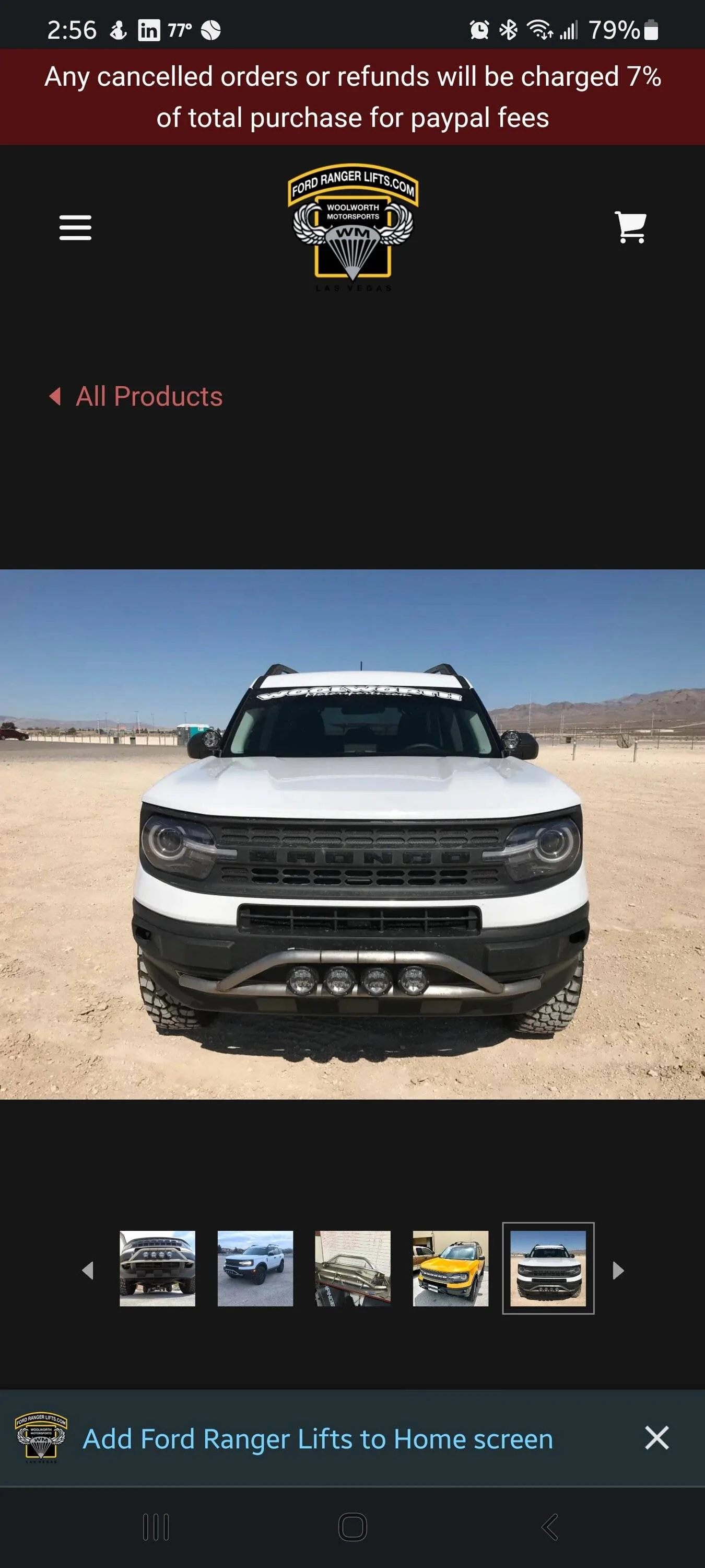

There are 2 options, on the roof or behind the sensor... this is a possible option for the grille bar
https://fordrangerlifts.com/shop/ols/products/nudge-bar-light-bar

That's a great idea! Thanks for that.
It does look like it completely covers the front license plate though. Hmmm... It even shows covering it up on their website. haha

Be creative it can work. 360+ works perfect with the right setup. My light bar sits a little higher than the lower opening and doesn't effect adaptive cruise. I did hang the lights down but I believe everything would work fine if I put the on top instead. Need to pop that sensor cover off to see what's going on under it. I also notice a cover in the upper grille opening, wonder if the sensor is actually up there.
