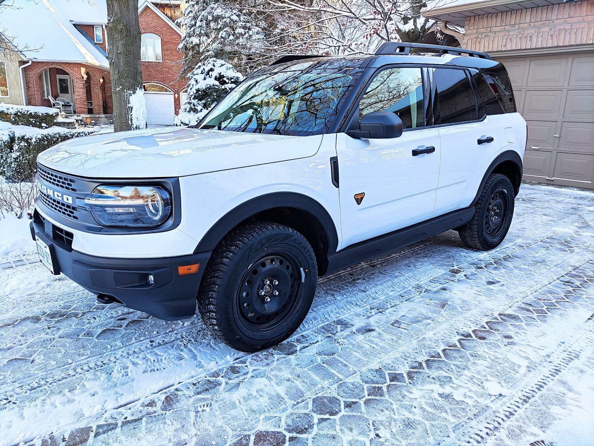

Just picked up my BL and wanted dedicated snow tires mounted on their own rims. The dealership didn't have available rims on hand. For your info, Steelies made for the Escape, as you might expect, are a perfect fit. Very happy with my Bronco Sport.

Please take a look at the inside of the wheels that came on your BL and confirm the stock wheel offset. The number with the ET next to it. I’m pretty sure that Escape wheels have greater offset than the Bronco Sport. If so, the wheel track on your BL will be reduced and may look a bit off when running the steel wheels.
I think the stock offset is +37.5, these look to be +52.5. So something like a 1 3/4" narrower track overall with these?

Had a look at the original wheels, no "ET" displayed but rather "J+37.5". I'll take that as the offset.
Yeah the 37.5 is the offset

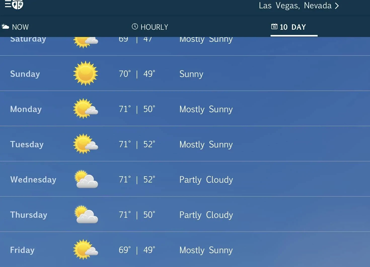

Me thinks I dont have to worry about winter tires where I am! LMAO :crackup:
