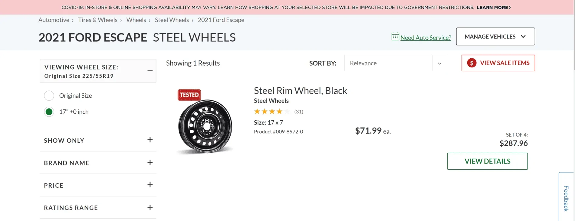

Your rims are actually steel? What's the cost for a set of four? They look great.
I think I found it online:

Dear All,
I picked these rims up at Canadian tire. I'm sure you'll have no problem finding an equivalent in the US (O'Reilly's ?). Prices here shown in Canuck bucks. Yes, they are steel.
Cheers
