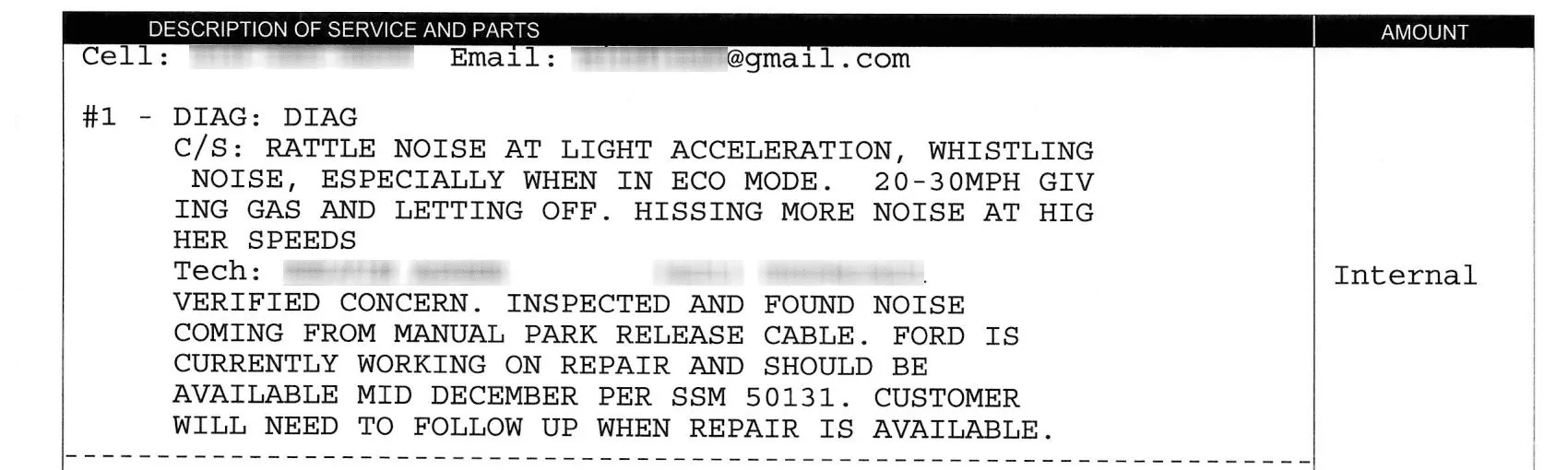

Just an FYI
Took mine to my dealer and said there is an SMM for the shift cable/manual park release cable. they checked and apparently ford has released a replacement part to alleviate the problem.

Check to make sure that the hose(s) to the oil separator are fully connected and look for defects in them.
SMM? Have a link to that?
