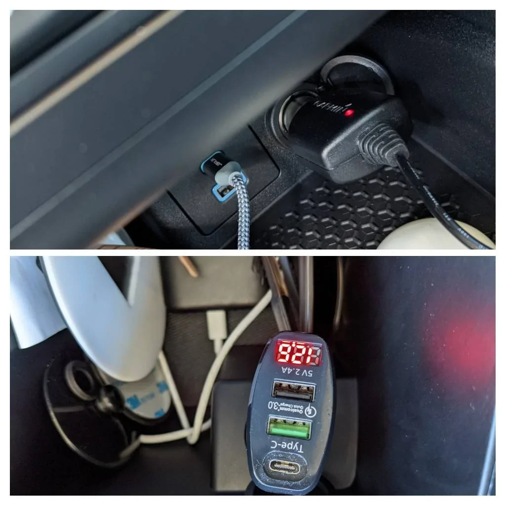

Hi everyone
I just noticed that the DC power outlet (Cigg lighter port) does not shut off when I turn off the car. I plugged the GPS device , Phone charger or dashcam (it keeps power to whatever is plugged into the outlet even when the vehicle is off) Checked it after 30 minutes of having the car off and it was still getting power.
Is it normal?
So it's mean I need to unplug every devices every time?

Update: It's always on, sort of. The car determines when to shut it off. I plugged a USB adapter/voltmeter into it and watch when it shuts off. Sometimes it's right away, other times it takes a couple minutes. I think it's related to how soon you close the door and if you leave it open or lock it and maybe if something is charging/drawing power.
