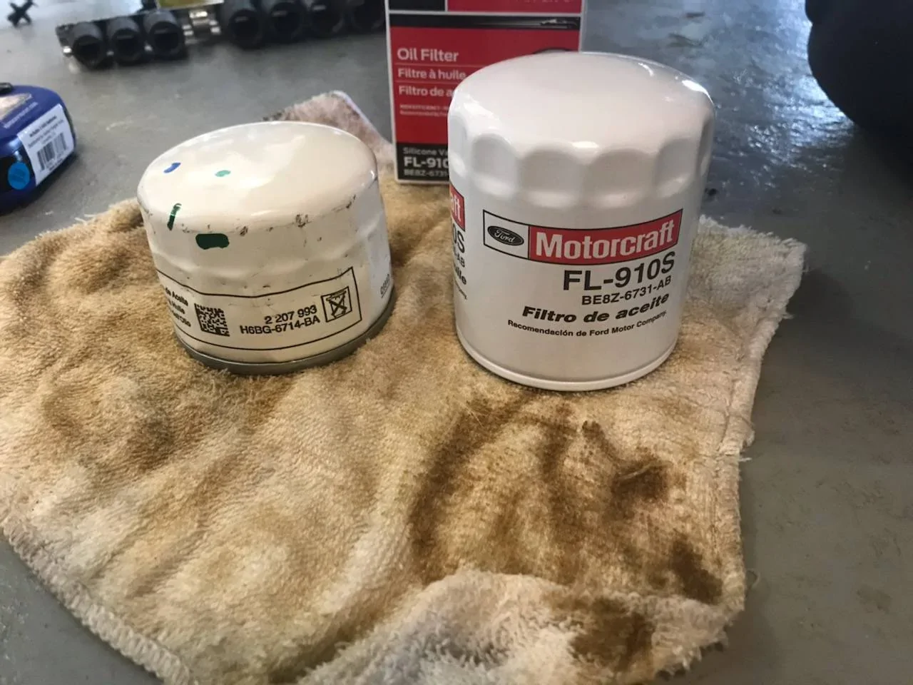

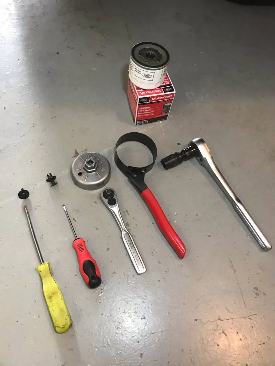

The online part description and the owner's manual both call for FL-910-S, which I happen to have plenty of because that is what fits my Escape. I used 5-20 full synthetic for the oil. The tools are shown below in the picture. T-30 Torx driver for underbody cover screws (13x), 2 push pins need to be removed too. 16 MM socket for oil pan drain plug and oil filter removal tools. My question is, if the owner's manual and ford parts both recommend the same oil filter (FL-910-S) why was my BB shipped with the little short one in this picture? Has anyone else seen this on theirs? Wondering why it would ship with a different filter (smaller) than what it calls for. 1.5L engine.

Very odd, that 910S filter is normally put on 2.0L GTDI engines, but the owner's manual does indeed call for that filter on both engines. Not sure where the disconnect is, maybe I can find out.
Did you notice the filter was too close to a coolant hose coming off of the oil cooler housing?
the original filter was not even close, the new one does stick out a little further and the coolant line lays against it. No moving parts, but i plan on monitoring it to see if any wear marks form.

Does the OEM filter have any identifying part numbers that resemble a Ford filter number (e.g FL-nnn)? Is it possible that the OEM filter is a domestic-market product from the country of origin and not available in the U.S.?
I'm just speculating and may be way off, it just doesn't look like a typical Motorcraft filter.
If you zoom in on the picture with the tools, you can see the Ford logo on the original filter. It's a Ford part. I have never seen a manufacturer use parts that, to me, seem inadequate.

Probably more info that anyone wants, but look HERE and HERE . For years that type of generic looking filter has been on all Fords from the factory. There are lots of theories why that is i.e. it being an indication someone has done a first service. Most likely its just that Ford negotiates a bulk contract globally and they use these. Years ago, they were a slightly cheaper , less robust designed filter than that of the mainstream Motorcraft counterparts, recently it looks like they are similar with the exception of the can size on some engines.
Thanks for the info. My thinking is....filter is obviously ok for the engine, but smaller in size. maybe the 1/4 of a quart of oil, less per vehicle multiplied by the 100s of thousand vehicles produced equals cost savings of "X" per year by going with a smaller filter from the factory.
I never meant to imply that it was inadequate, rather a Ford part not marketed in the US, since it was different than what the manual specified. It has been a while since I purchased a new Ford, but the six or seven I purchased in the 90's through 2006 had recognizable Motorcraft filters that could be purchased retail (FL-400 and FL-910's were common). All of this was pre-Ecoboost and likely before they started using the generic-looking filters described a few posts up.
I once purchased a Ford OEM serpentine belt from Rock Auto that was a Ford part, but it had an odd number. I researched it and found that it was a Ford belt used in Europe with the same spec as the one that I was replacing but with a much different number.
