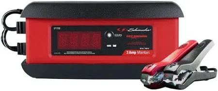

+1 for Schumacher. A lot of brands have sold their name and slapped it on some garbage products. IDK who actually holds the name, but the Schumacher equipment is good. I have one like this. It works as both a charger and tender on both LA and AGM batteries and the output is high enough to handle anything from a jetski to a large size truck battery. Its a good tool to have in the garage for most conceivable vehicles going forward.
And don't ask me why, but this particular one seems to be on sale right now at Home Depot for the disgusting low price of under $40. It usually runs in the $70-$80 range.
