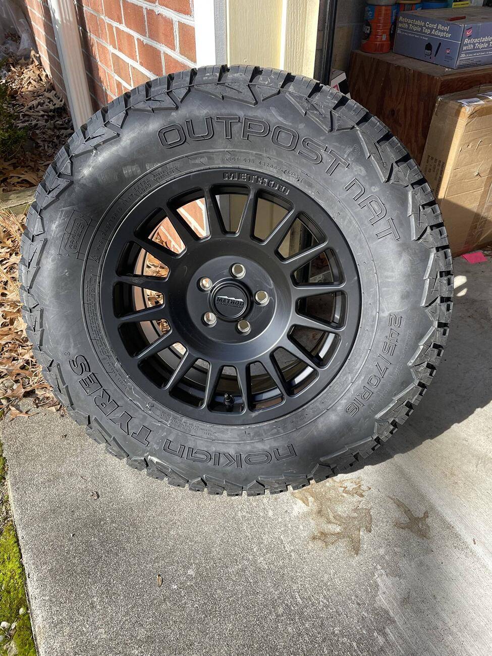

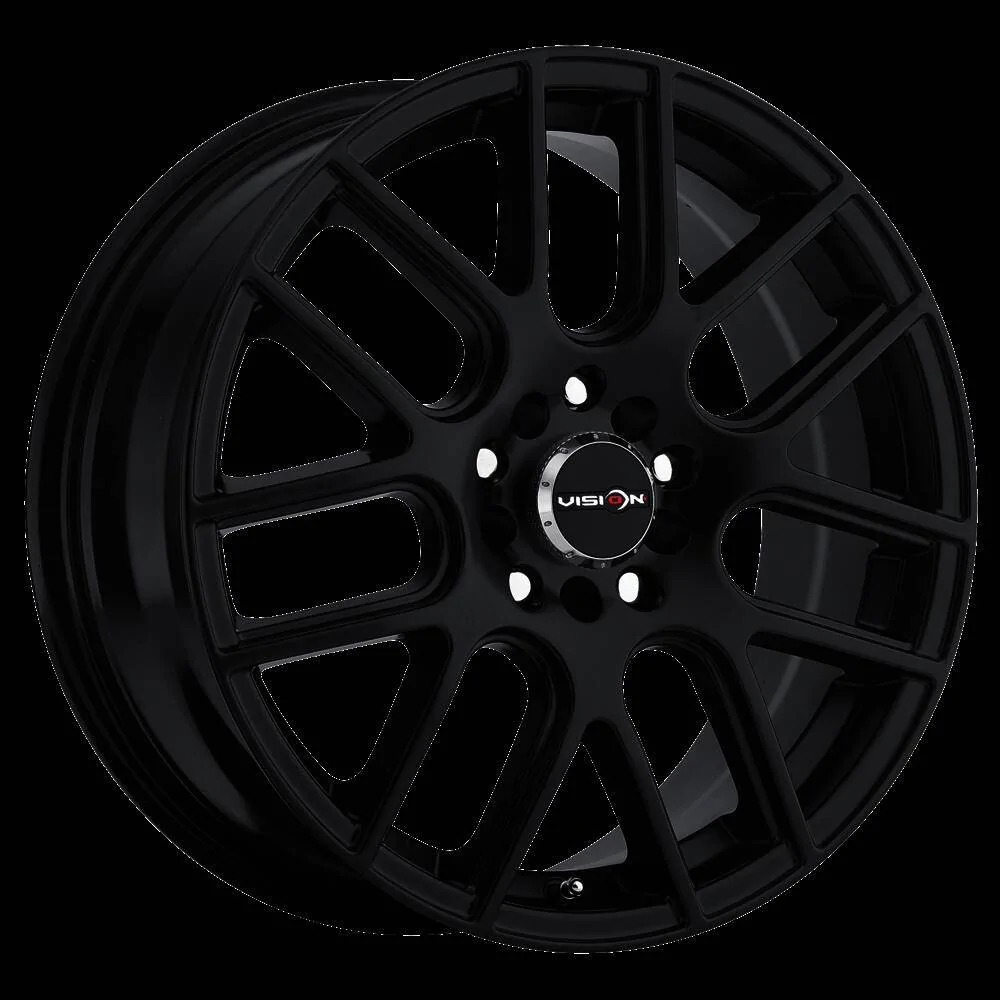

I'll address wheels first. the Tire rack currently shows 5, 16" wheels that fit and @Discount Tire shows none but they did show a fairly good number, at one time. I would search for 16x7, +30 to +40, in a 5x108 bolt pattern on Discount's site. They let me order one wheel for test fitting. As long as you don't mount a tire, on it, they will take it back, for a full refund, if it doesn't fit! The first of my 2, 16" wheel purchases was for a spare and was a 16x7, +38, Vision Cross, it fits. Very similar and they said it would fit, was their MB CRUX, also a 16x7, +38 and both have a 1800lbs load rating. Many 16" wheels have a lower load rating, some way less and I wouldn't consider lower, if off-roading is in your future. My 2nd 16" purchase was a now discontinued Method Bead grip 16x7, +30 wheel, it also fit and I mounted so 245/70/16 Nokian Outpost NAT's. Even with my 2" lift, these tires barley fit, which I attribute mainly to their +30 offset but somewhat to what I believe is their somewhat above average diameter, for a theoretical 29.5" diameter tire. The Method DX4, 16x7, +30 also fits.

Nokian Outpost NAT
also available in a 235/70/16. Vision Cross and MB CRUX available in 3 colors

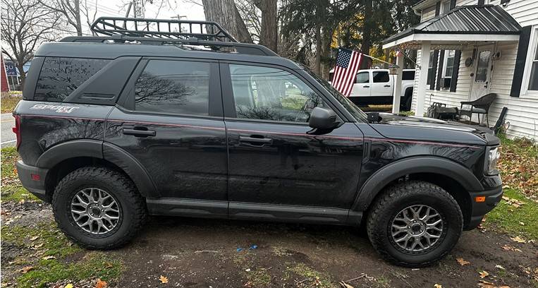

Ford Bronco Sport 255/65-16  Anyone tried this size ? 1745073984986-ua
Ford Bronco Sport 255/65-16  Anyone tried this size ? 1745072833898-a2

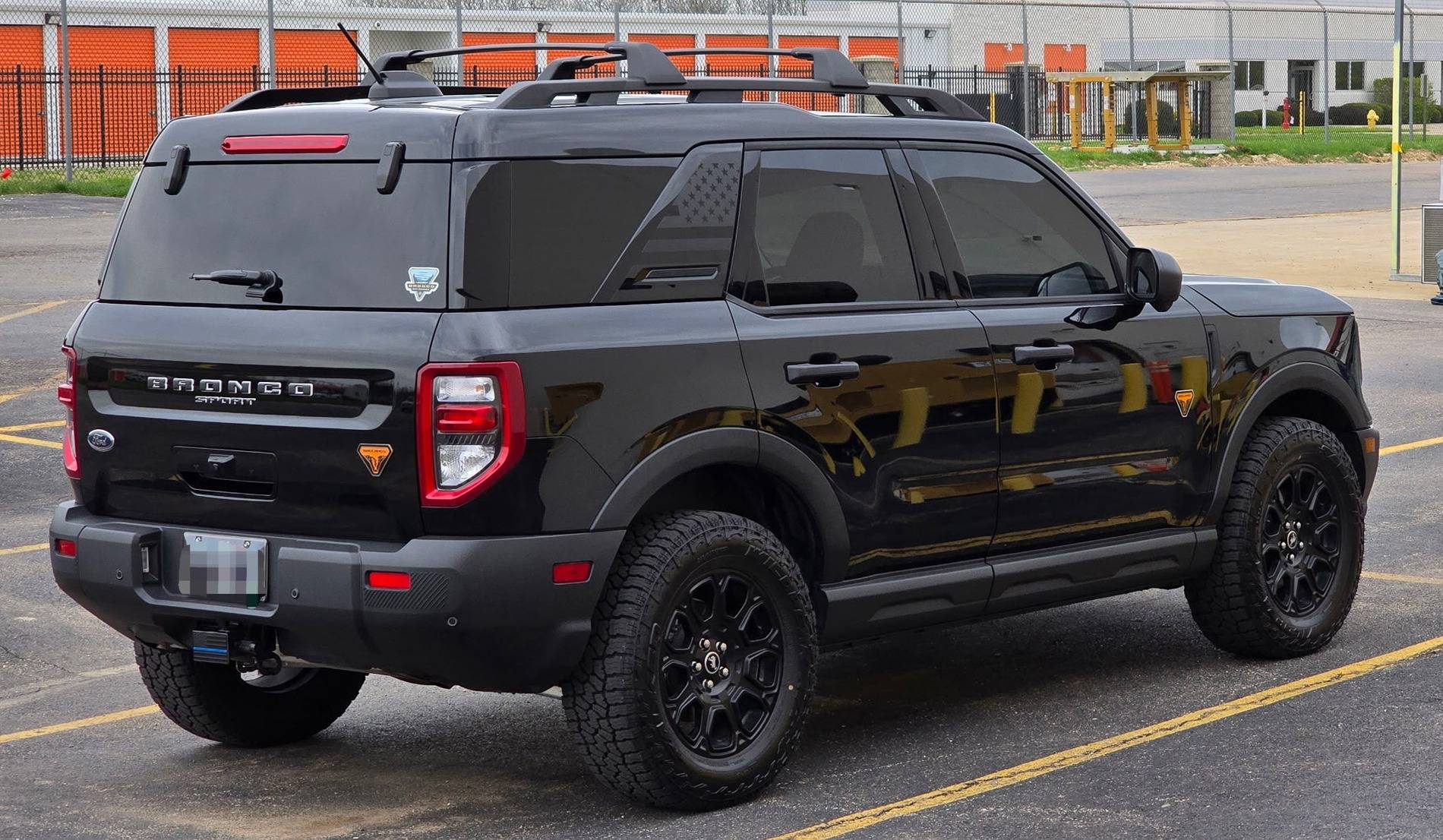

I have not, and I'm not sure if it's helpful to you but I do have 245/65/R17's and they're a perfect fit
