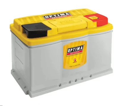

So I know that most of my trucks came with an adequate battery when purchased new. I've always upgraded before battery was ending its' service.
I usually get Optima because I use power inverters for tools when out up in the mountains.
I've read quite a bit of the battery posts here at the forum and there appears to be a possible problem with the stock battery in a premature time period.
So I figure I might as well start looking now and be ready. I found this posted on the net:
Regardless of which engine came in your Bronco Sport, the replacement battery is the same- an H6 or Group 48. Whether your Bronco Sport came from the factory with an Enhanced Flooded Battery (EFB) or Absorbed Glass Mat (AGM) battery, OPTIMA offers a direct-fit upgrade for either battery with our DH6 YELLOWTOP.
I usually purchase the red top for most my trucks when replacing but they offer the yellow top for the Bronco Sport.
I'm all ears for any thoughts about Battery upgrade applied when using power inverter service occasionally.
