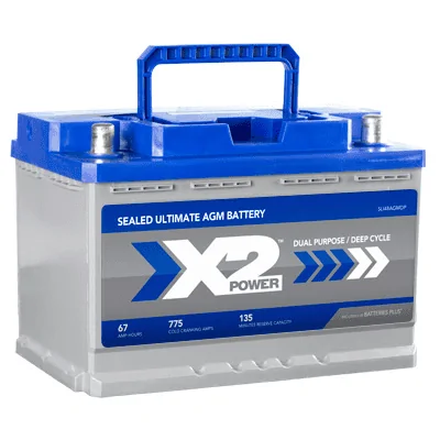

This may be an option

I had looked and found many links. I did not check to see if there is a specific X2 battery for the bronco sport. There’s also lots of reviews for X2 batteries but I haven’t had time to research those. (EDITED)
https://x2powerbattery.com/
https://www.batteriesplus.com/brand-shops/x2power
Warranty stated: The warranty coverage available is a free replacement period, which extends for a period of Ten (10) years or 2000 cycles, whichever is earlier. Should the battery fail due to a manufacturing defect within the free replacement period, the battery will be replaced at no cost with a new battery of comparable performance.
Not sure what 2,000 cycles exactly means for X2 but on my Ebike battery I’m familiar with a limit on battery full charge cycles allowed under warranty.
6,725
13,162
I had looked and found many links. I did not check to see if there is a specific X2 battery for the bronco sport but I’m guessing no (pure guess… will need to check). There’s also lots of reviews for X2 batteries but I haven’t had time to research those.

Thanks! I see it comes with this warranty: Comes with a 4 year free replacement limited warranty. See SLI limited warranty Policy for details.
I could not find the spec for Reserve Capacity. Did you see that spec?
67 AH.

67AH would be related to Reserve Capacity. I’m looking for the more accurate Reserve Capacity spec in minutes for the SLI48AGMDP X2Power Premium AGM. I do see it says “ Capacity 20hr: 67AH “ (sometimes that is not the same as Reserve Capacity if the battery manufacturer does not test to the spec)
Reserve Capacity: a time measurement in minutes that defines how long a fully-charged battery can deliver 25 amps of current in an 80°F environment, before the battery is discharged down to 10.5 volts.
Examples:
Motorcraft BHEF-48H6 lead-acid
Dimensions: 10.9" L x 6.9" W x 7.5" H
700 CCA Cold Cranking Amps
Reserve Capacity: 120 minutes.
Motorcraft BAGM-48H6-760
Dimensions: 10.94" L x 6.89" W x 7.48" H
760 CCA Cold Cranking Amps
