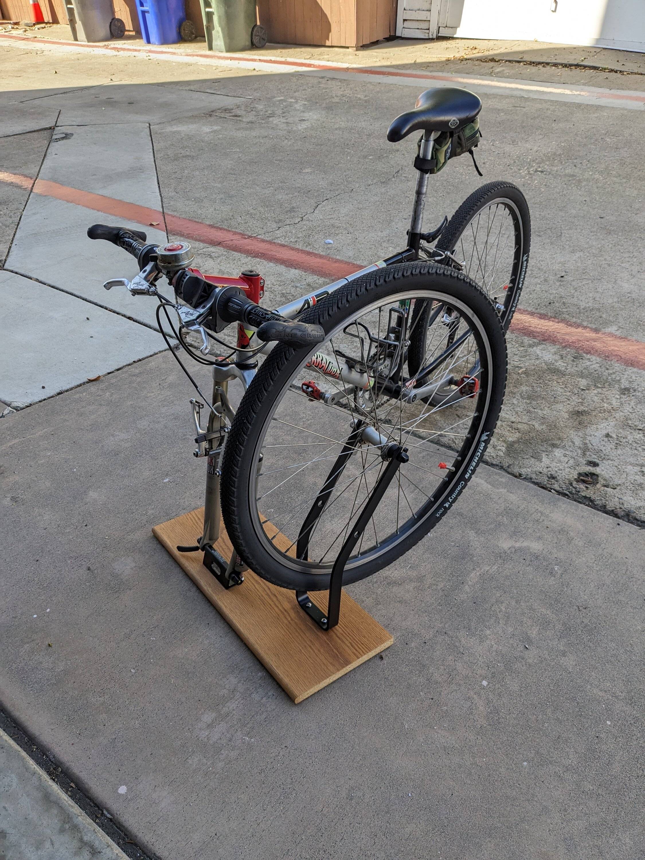

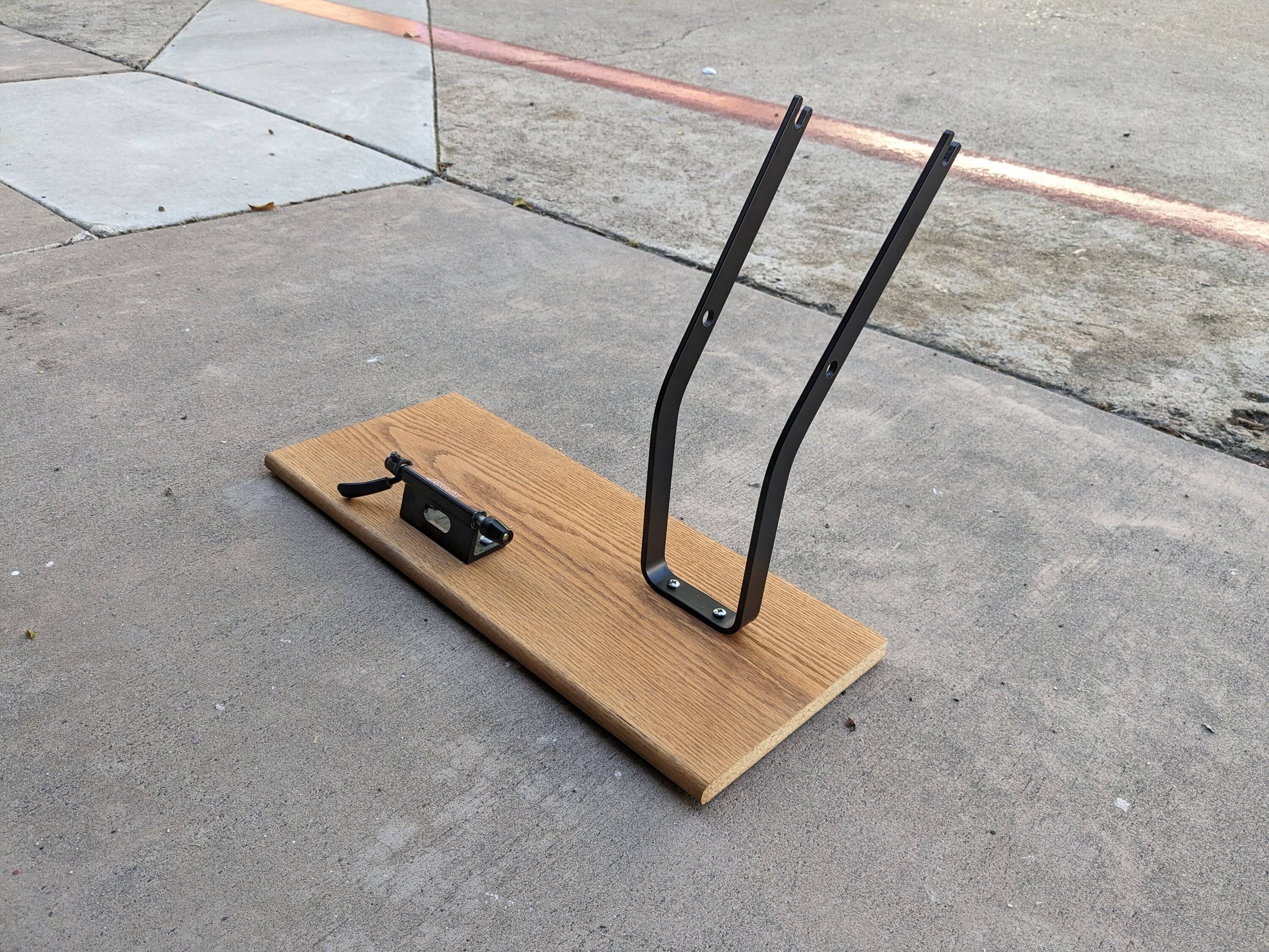

The fork holder (on left) was less than $20, the wheel holder was $27 or so. Wood was free. The wheel holder is offset because the wheel needs to clear the bike handlebars.
Ford Bronco Sport DIY Interior Bike Rack PXL_20231208_183120126
See why there's an offset?
You can skip the wheel holder if you just want to toss the wheel back there somewhere, I like it to know it isn't moving around while I'm driving.

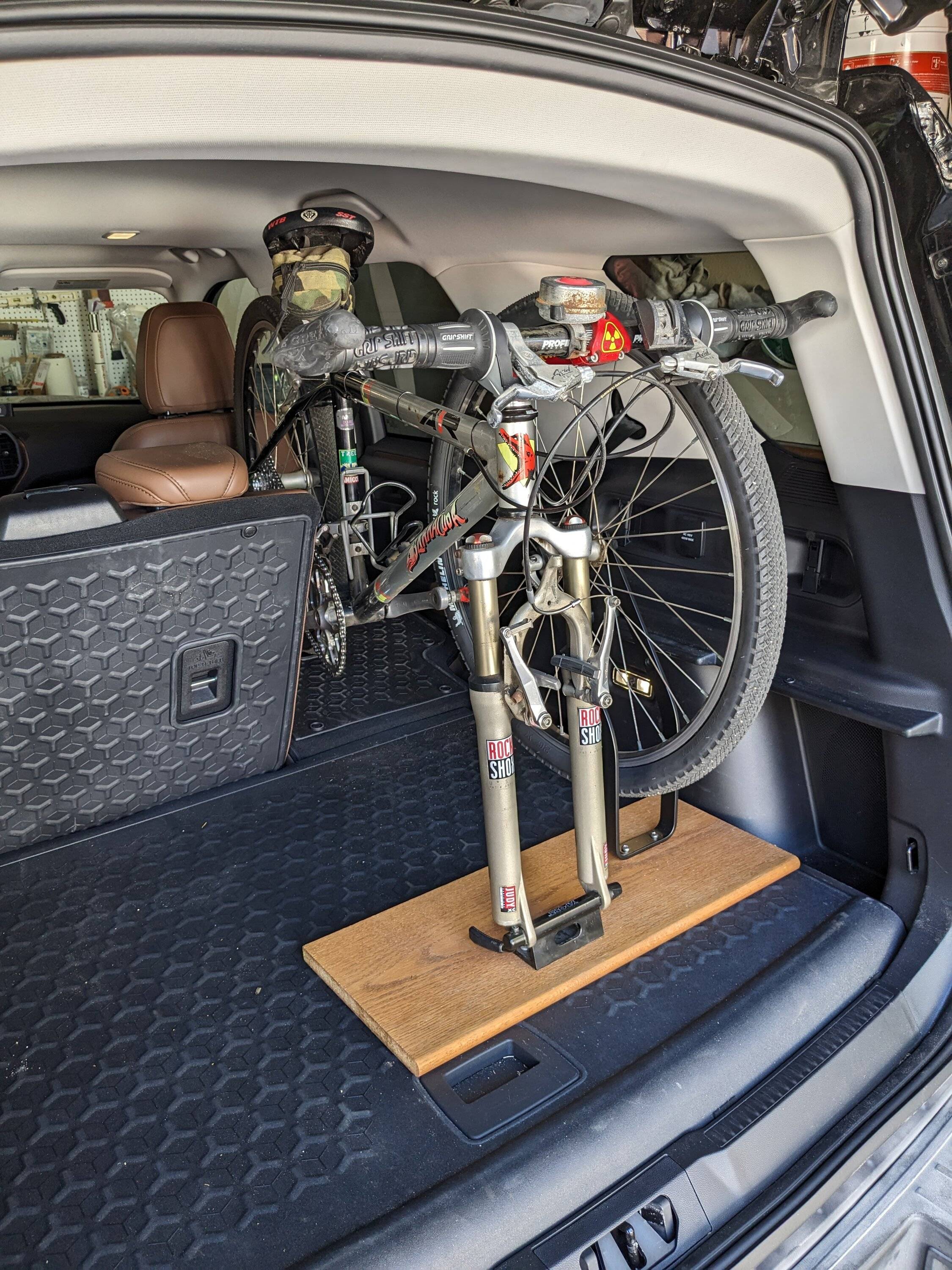

Bike in the Bronco, it'll fit on either side with one car seat up. Seat has been lowered-- I've got a quick release lever on the seat tube.
Ford Bronco Sport DIY Interior Bike Rack PXL_20231208_184444119
The wood base is large enough that the bike doesn't need to be be tied down, it won't tip over in turns or even on a rutted dirt road.
Ford Bronco Sport DIY Interior Bike Rack PXL_20231208_184504828

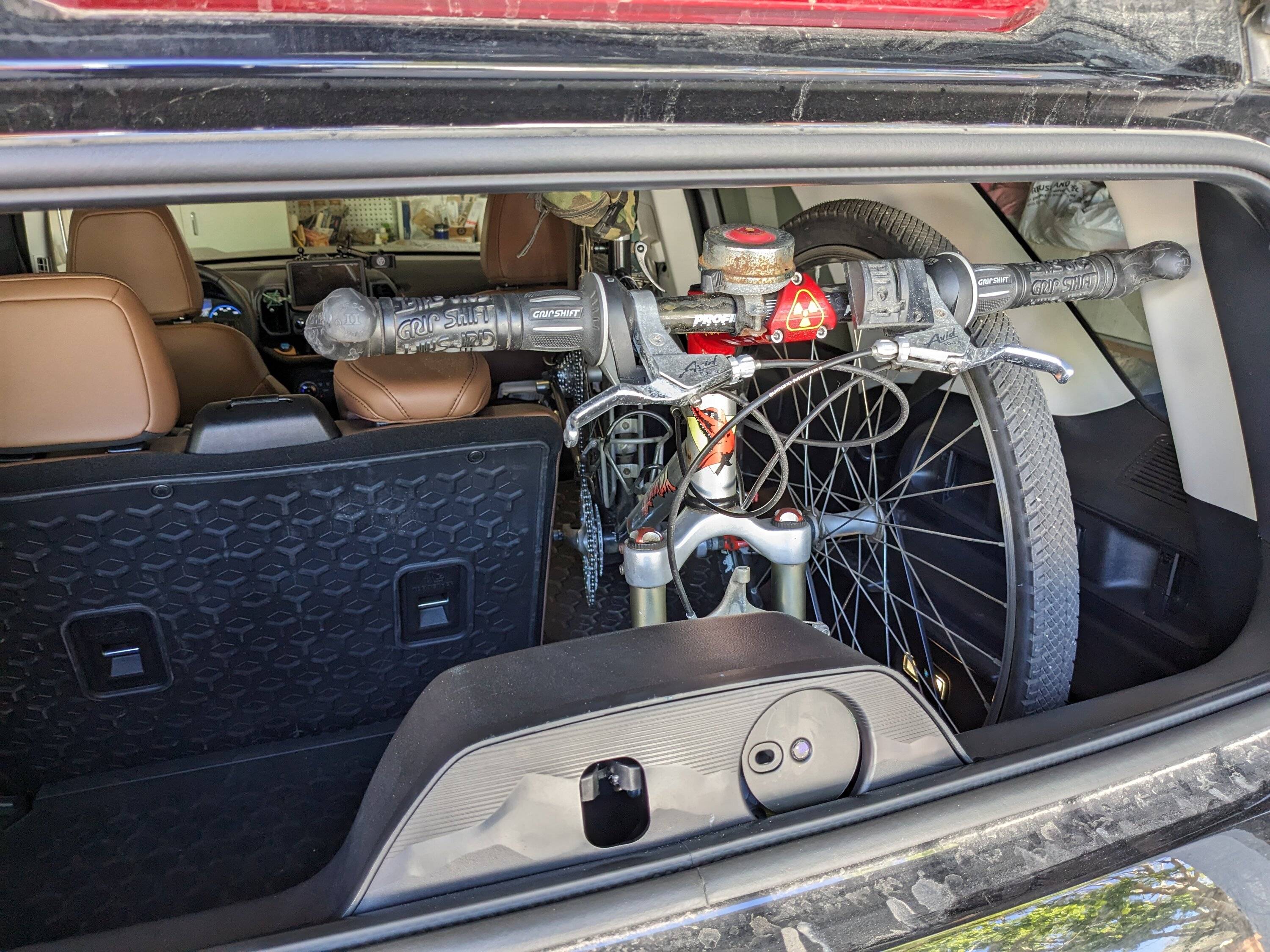

Fits in with a couple inches clear front and back. The rear tire is 100% behind the passenger seat, it doesn't intrude between the 2 front seats.

You might consider a means to secure the base. It appears the handlebars might contact the liftgate window if the bike shifts.
Part of the reason for this design vice the official Ford solution is that it is very easy to remove it when the bike is not back there. I accept the ease of use vs risk trade off. If I want to, I can always add bungees (always carried in spare tire space) for tie downs.
