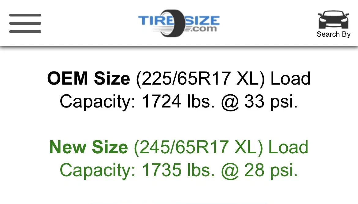

Hi. I changed the tires for 245/65 17. Do you think that inflation pressure is correct (29") with the new size?

No. I would do one of these three and keep in mind cold wether could need a couple extra psi:
- 33 as in the door jam for this vehicle
- 80% of max psi for your tire and never any more
- somewhere between the first two options (this is my personal recommendation)
28 psi is too low unless you are off-roading

The Badlands can come with 235/65r17 and is also spec'ed to 33psi cold.
I have replaced with 235/70r17, and run slightly lower 30psi cold just to make the bumby roads and potholes around town smoother. When Im really offroading I go down to ~25, I dont have beadlocks so I dont go lower. Long interstate trips I go up to 35psi.

I have read and seen things suggesting lower pressure when going with bigger tires. However I also agree with staying within 33-35 the TPMS doesn’t know you have different tires and being at 28 could result in TPMS alerts that aren’t needed.

What are the tires? What kind? What ply? Etc. that changes things.
I’m running 245/65/17 wildpeaks that are 6 ply and run 32lbs cold. Wear perfect. After 10k. Rotated three times. Just because did lift at 1k miles

I don't believe the system is looking for a specific PSI. I believe it's looking for a difference between tires.

I believe it is based on both weight and volume. The fact that the BS door sill sticker does not change between the offered tire sizes, shows that it is somewhat insensitive. That is also backed up by people being able to run tire pressures in the high 30’s and others in the low 30’s and both are happy and have good tire wear.
Just as an extreme example, look at bicycle tires. A road bike has narrower/lower volume tires and needs a tire pressure of around 90-110 psi. Now move to “townie” bike with a little wider/more volume tire and the pressure needed comes down to 40-60 psi. Move to a Mountain bike and tires are even wider and even more volume and the pressure needs drop to 15-25 psi. Go to a fat bike and the pressures drop to 10-15 psi. All of these are really just changing the volume without changing the weight substantially. The person on the bike is the primary contributor to the weight across all of the examples.
There is a post here somewhere from @Falken QA that does say that with larger tires you could run a lower psi but they shy away from recommending a tire pressure less than what Ford specs. I’m sure that is because they don’t want to accept responsibility if something goes wrong.

Let’s be clear here, we are only talking about relatively small changes in air pressure. Like maybe 3-5 psi less than the sill sticker for a larger tire. I don’t think that anyone should be running around on the street with 25 psi air pressure (or less). I think about 30 psi would be the least I would say anyone should run in a 245 wide tire on the BS. That is roughly a 10% change which is about the same change as the increase in tire width (10%).
That being said, I have mine set to 33 psi with a 245 tire. Not that I have done any comparative “testing” to find what feels the best.
I really hate things like the door sill stickers that present it as a single number. This leads people to believe it has to be that exact number. As load conditions change or even road surface conditions change, you may want to change the tire pressure. It doesn’t necessarily mean that you have to but you could get better traction or a better ride with a different tire pressure. I think that they should show more of a range of appropriate tire pressures for different conditions.
