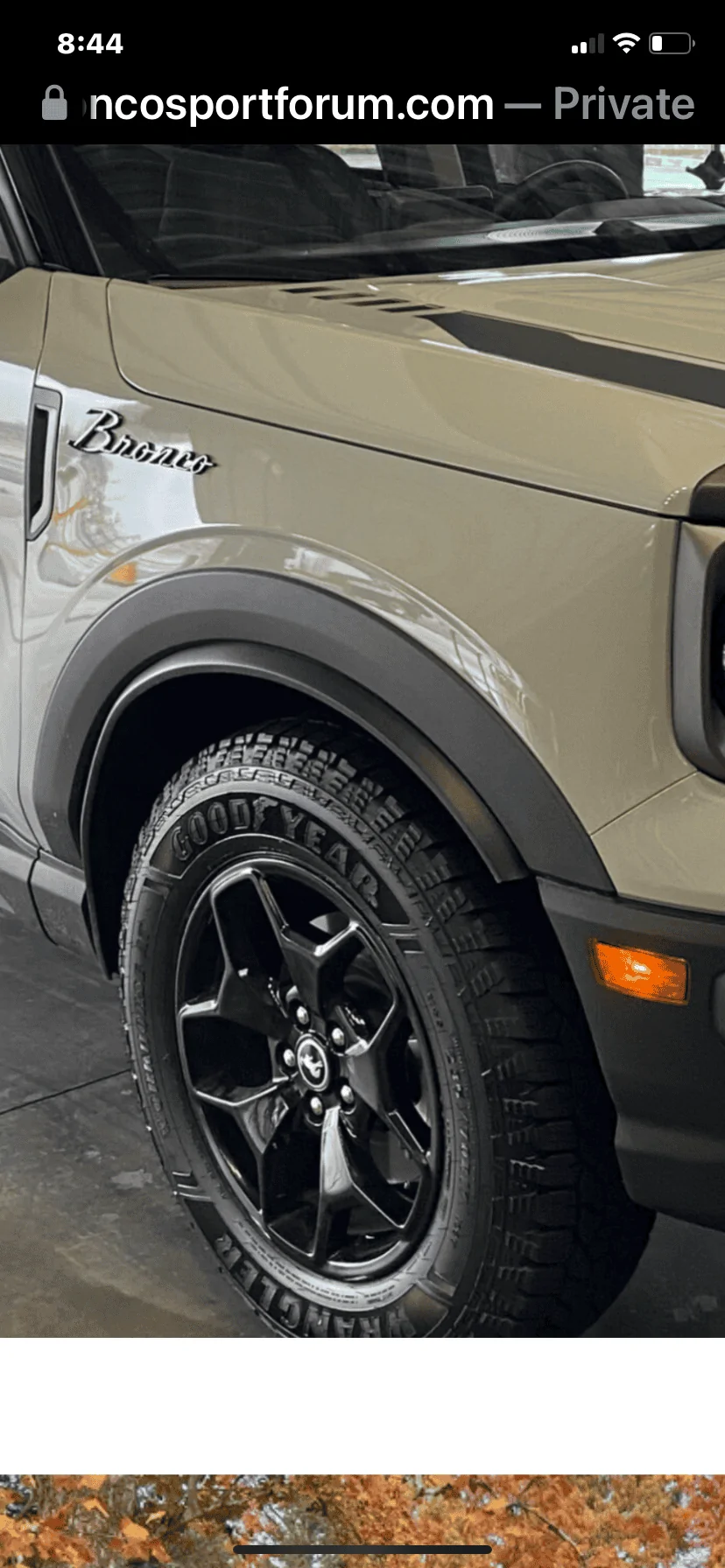

From what I have learned from Eric as soon as you step out side of 235/70/17 dimensions with stock rims that is the problem zone . I have changed nothing to my suspension and have stayed with in the specs that ford has stated and Eric has agreed with that you can fit 30 inch and no more , I went with Goodyear wrangler at 30 inch exactly with not a issue , now I must say that I am no rock climber but that was never my goal. I do know that myself and a few others on this forum have kept to the same formula with out issues, I have 1/2 inch clearance front and back of the front tires , is it close hell yes , one thing that I have learned from Eric’s detailed build is that one thing is constant and that is the front to back dimensions they remain constant, if you are having rub problems look at the exact dimensions and diameter of the tires example good year 30. (Not 30. Something. ). My spin .
Ford Bronco Sport Comparison pics of OEM and Modified Badlands 6925526C-9843-463A-97DF-C10FF21FF552
Ford Bronco Sport Comparison pics of OEM and Modified Badlands 2381D3A1-9D2B-4DEA-8C15-03446DABC5CD
Ford Bronco Sport Comparison pics of OEM and Modified Badlands 10047C31-CC4C-4DF1-87B1-CD089289B81B
Ford Bronco Sport Comparison pics of OEM and Modified Badlands AC8B3E4E-B02F-45BF-ADB8-612AC8041347
Ford Bronco Sport Comparison pics of OEM and Modified Badlands 896B3BFA-9710-4455-9BDC-C028C02B2113
