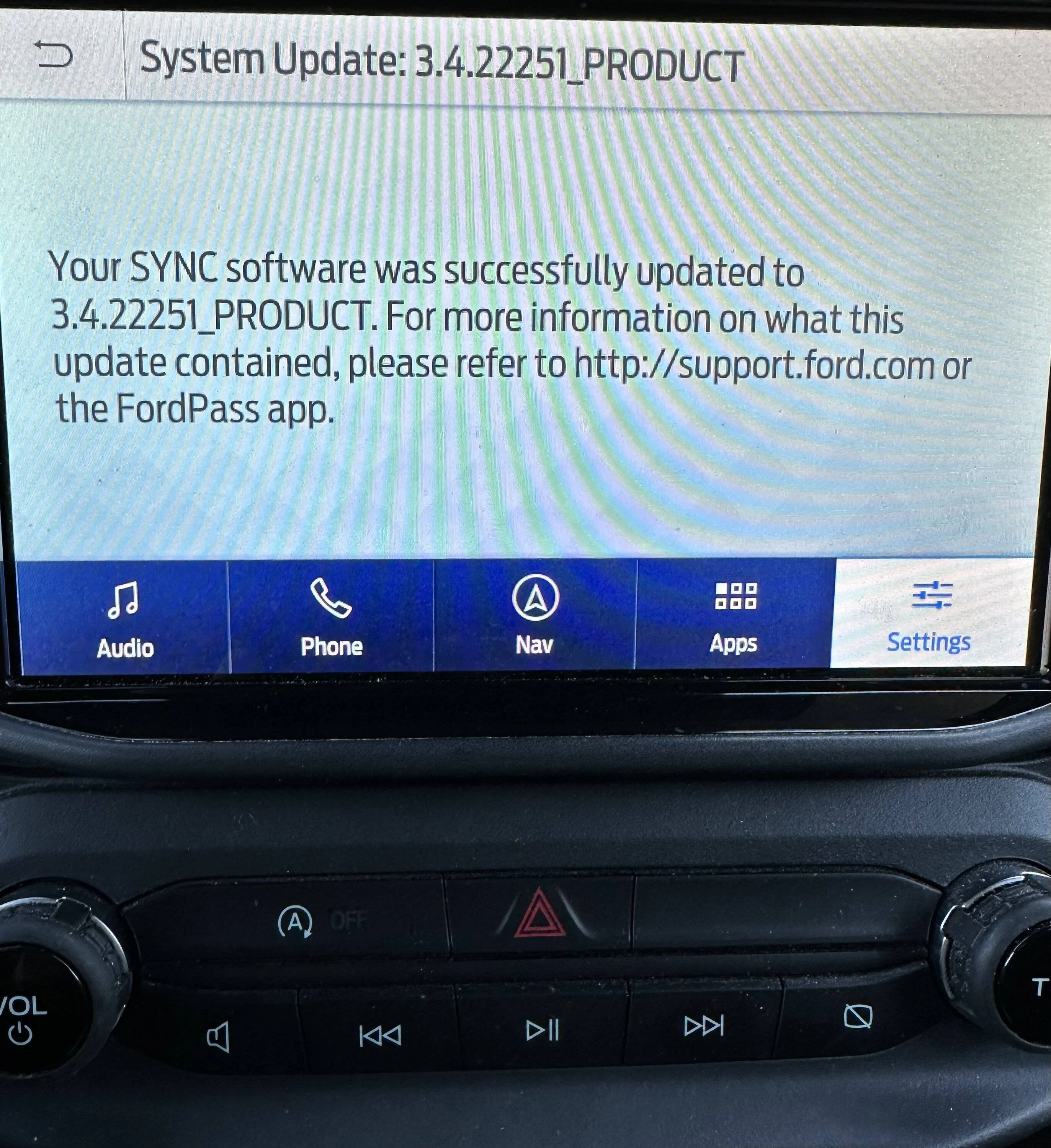

The update is now available for download through Wi-Fi with the head unit. I used the above link and followed instructions to copy the files to a USB-A or USB-C flash drive to update.
Ford Bronco Sport SYNC 3.4 Build 22251 Now Available 1/22/23 2515F777-4546-49D9-BCC1-B607BB3F3DC3
It seems zippier. SiriusXM screen detail refreshes faster. SiriusXM Travel Link is much faster and smoother.

Followed online instructions with USB. After having to remove it once and plug back in, finally the update got done.

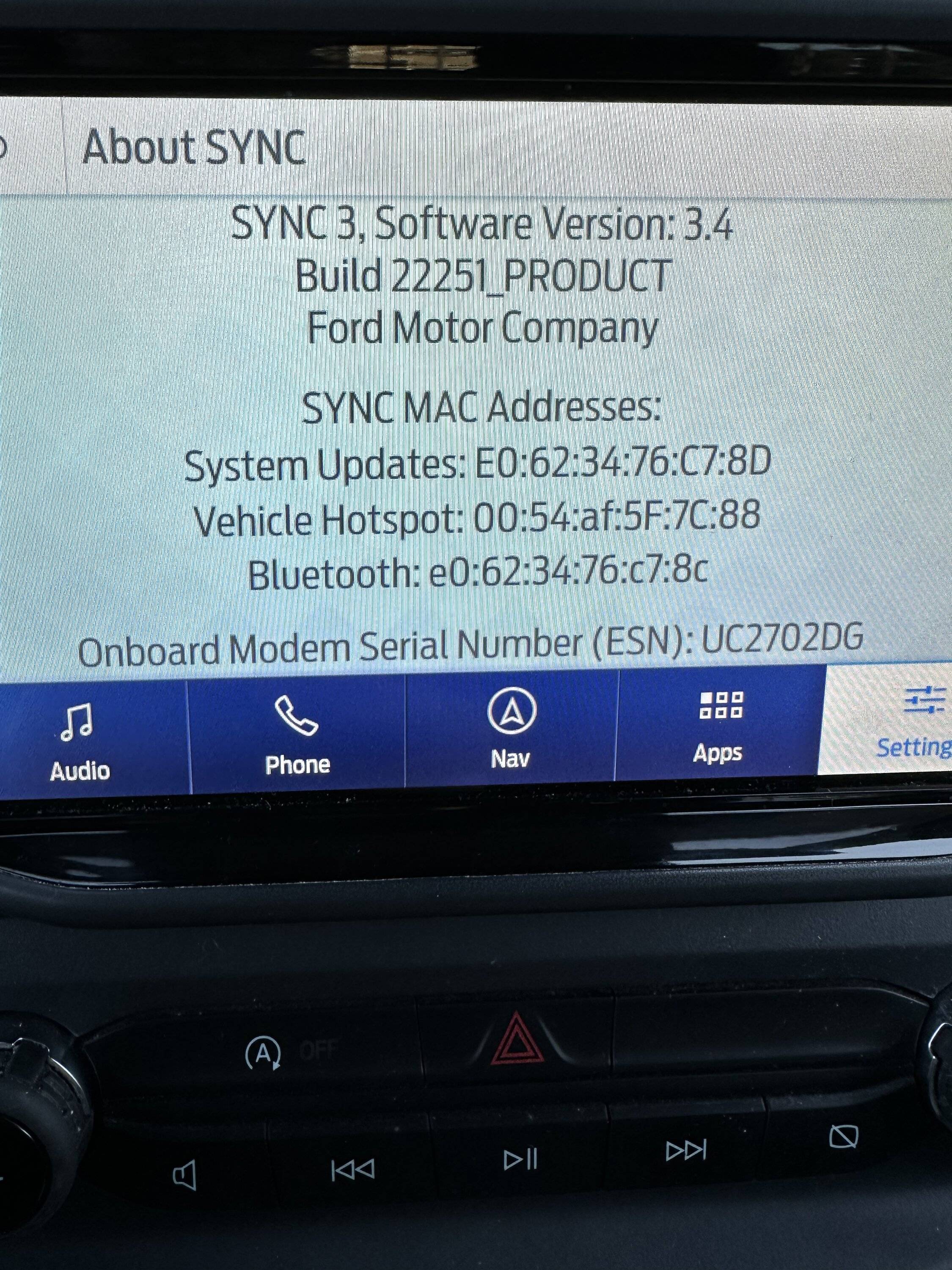

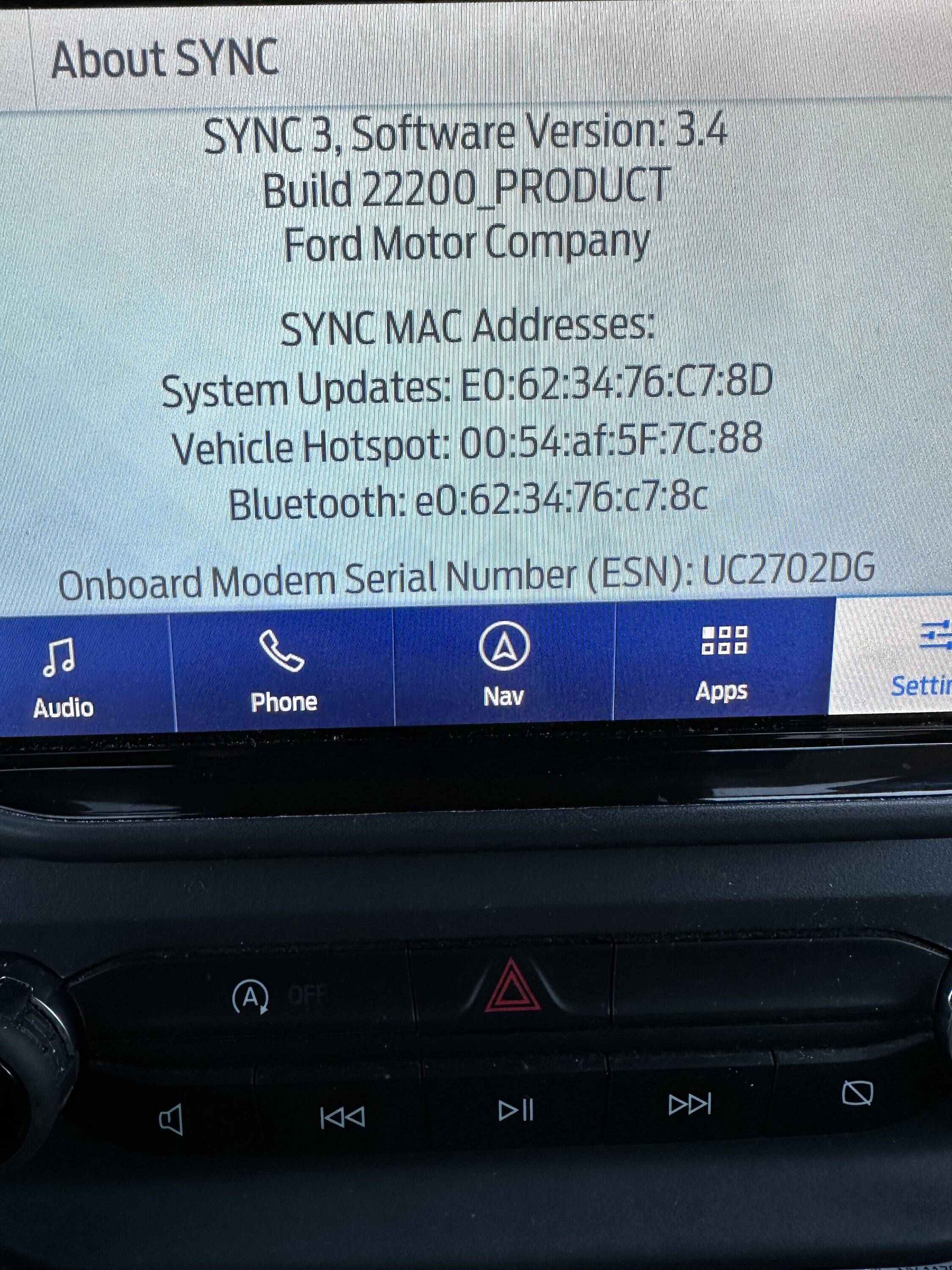

Is the downloads page (attached) displays the build before the update?
Ford Bronco Sport SYNC 3.4 Build 22251 Now Available 1/22/23 Doc1
The SYNC 3 version is not always displayed on Ford’s download site
My ‘22 Badlands came from the factory with version 21194.
In October 2022 I installed version 22200 via USB Device but after the 22200 install completed, i was not able to upload the created file from the USB Device to the Ford site due to a known issue with Fords website. So my download page showed “blank” at the spot in your pic where you show 3.4 22200. I contacted the Ford software support team in October 2022 but they could only explain it is a known issue.
Today 1/23/2023 I installed version 22251 via USB Device but after the 22251 install completed, i was not able to upload the created file from the USB Device to the Ford site due to that known issue with Fords website as I mentioned earlier.
And my download page shows “blank” at the spot in your pic where you show 3.4 22200. But I do have 22251 installed as confirmed by the setting on the 8” Display.
