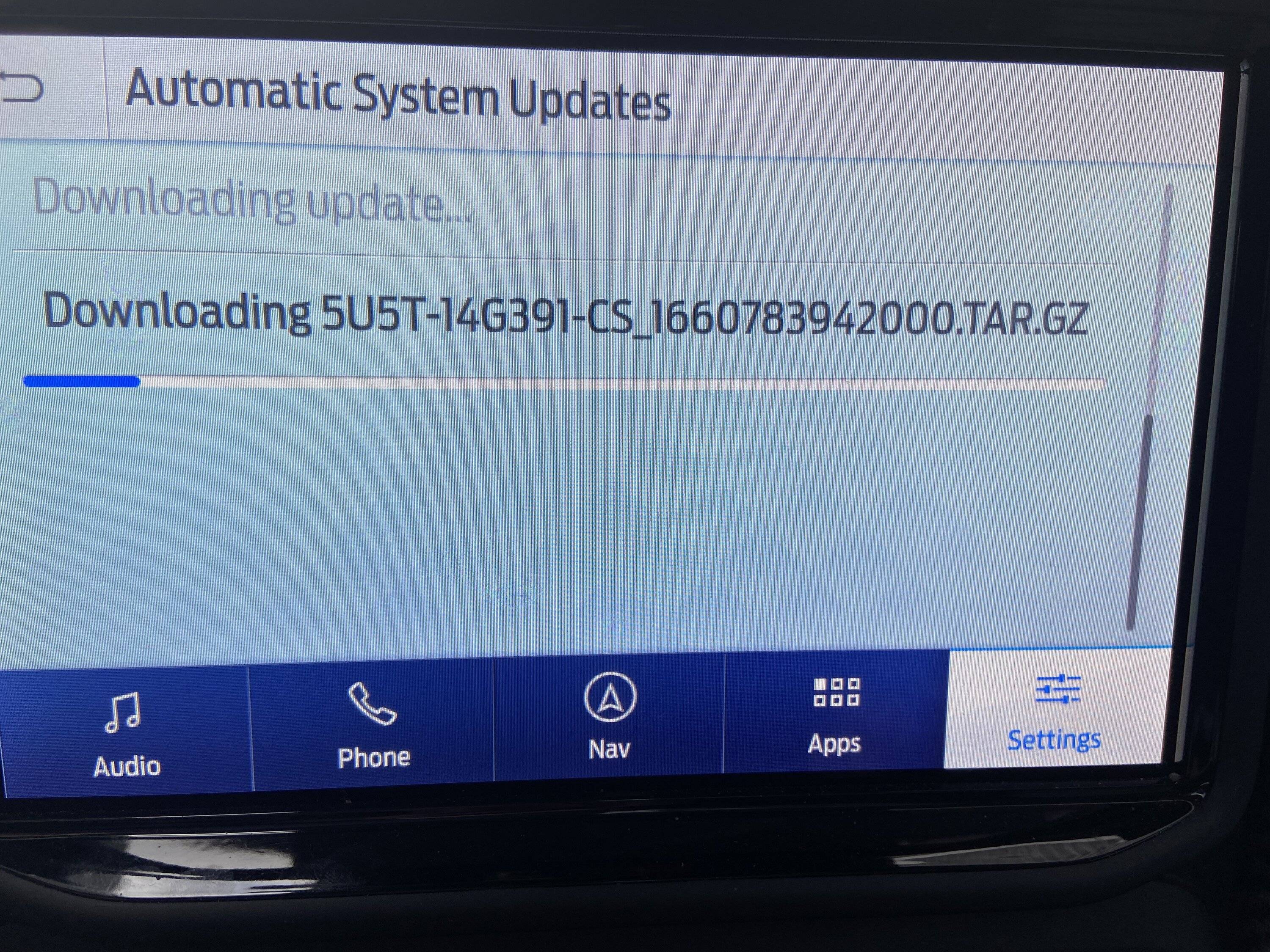

I did a re-install late yesterday. This time it went right into updating system as shown on the screen display, and I got a couple info screens pop up telling me it was complete and to shut down and restart my vehicle to complete it. All seems good now. Also I had deleted that ******.xlm file from the first attempt, and this time a subfolder marked 'log" and a log file within it showed up. I tried to sent the confirm to Ford but still got an error message. It asked for the "log" this time, not the xlm file.
We will see how it is now for a few days.

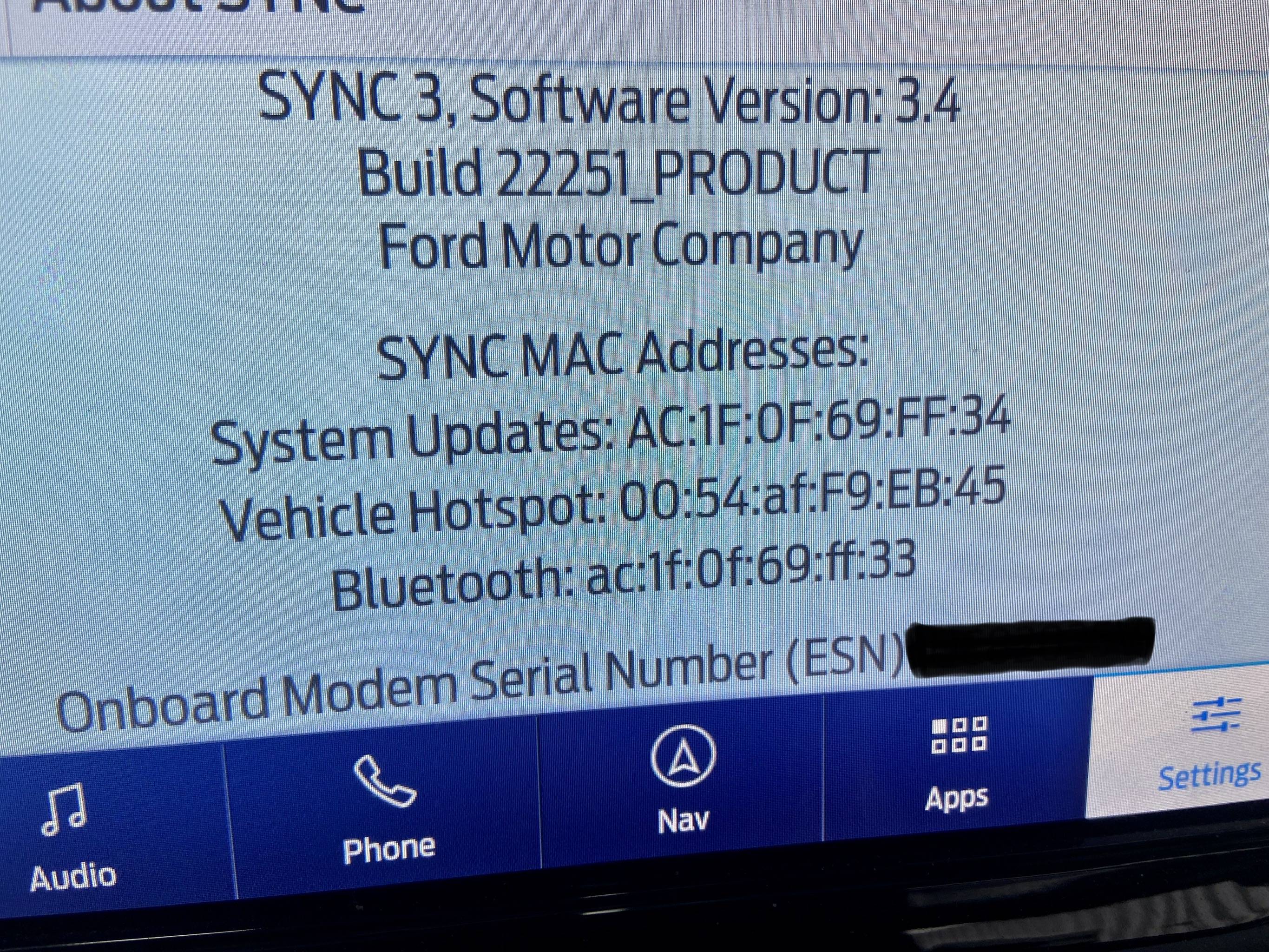

The SYNC 3 version is not always displayed on Fordā€™s download site
My ā€˜22 Badlands came from the factory with version 21194.
In October 2022 I installed version 22200 via USB Device but after the 22200 install completed, i was not able to upload the created file from the USB Device to the Ford site due to a known issue with Fords website. So my download page showed ā€œblankā€ at the spot in your pic where you show 3.4 22200. I contacted the Ford software support team in October 2022 but they could only explain it is a known issue.
Today 1/23/2023 I installed version 22251 via USB Device but after the 22251 install completed, i was not able to upload the created file from the USB Device to the Ford site due to that known issue with Fords website as I mentioned earlier.
And my download page shows ā€œblankā€ at the spot in your pic where you show 3.4 22200. But I do have 22251 installed as confirmed by the setting on the 8ā€ Display.
