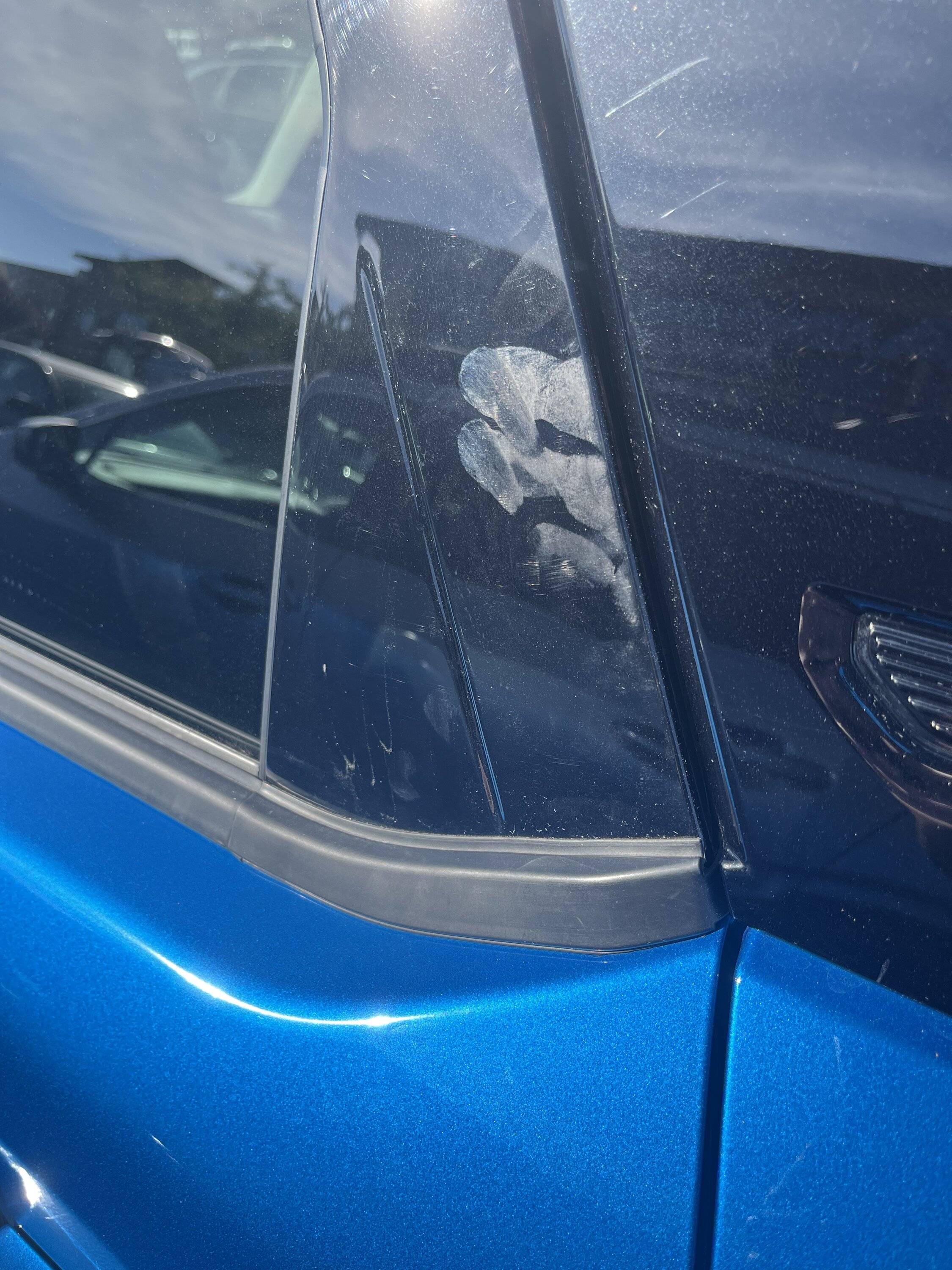

At some point over the summer, these stubborn fingerprints appeared on the black mirrored part of my Bronco Sport. Pretty sure it was a friend who had freshly sprayed sunscreen and then opened the door. I can’t seem to get them off! I’ve tried using a sudsy car wash mitt with light pressure, and Windex too, but they aren’t budging.
Any recommendations to get these off? I’m afraid of using anything weird on the black mirrored part as I don’t want to scratch it or create those nasty swirls, but I’m at a loss here.
Thanks in advance!

If your still unsure maybe a stop at your local body shop and ask them for Help.

Alcohol pad? Just another suggestion. ?

Thanks @atlsrt44 and @JAD67428 for your input. I've never used a clay bar but I will look into that option. I did think about stopping by my dealership and getting their recommendation, but maybe I won't need to now.

I thought about trying that, or some sort of rubbing alcohol mixture, but was afraid it would damage the piano black trim.

Isopropyl alcohol would be alright. do NOT try acetone.
Maybe a Cleaner wax type, it will have petroleum distillates in it, I just wouldn't keep it on for too long.

Sorry to say that your mirror black trim is already covered in swirl marks, clearly visible in your photo. These parts are pretty easy to buff to a mirror shine again, if you have a buffer. I would think that would take the hand print off. The other options (clay or alcohol) are easy to try but I doubt they will make a difference. I’m guessing whatever was on that hand has etched the surface and so there is nothing to clean off.

since you suspect oily use a soap designed to cut grease. I'd Go Dawn, it gentle enough and no abrasives.

My body work place that applied my ceramic coating, knows everything about this kind of stuff. I second going to one of those kinds of places and asking for advice. Good luck!

@AV99GT @Fossil Thanks for the suggestions, I just tried alcohol and Dawn and unfortunately no luck.
@Meanderthal I suspect you are probably right as anything I’ve tried doesn’t seem to get at the spot, it’s like the marks are embedded below the surface.
Probably going to take @missOutsyder advice and take it into a shop to see what they say.

If you were local, I’d offer to buff out all those black plastics and then you could apply a ceramic coating to keep them in top shape.

I appreciate that! I will look into that option locally for sure.
