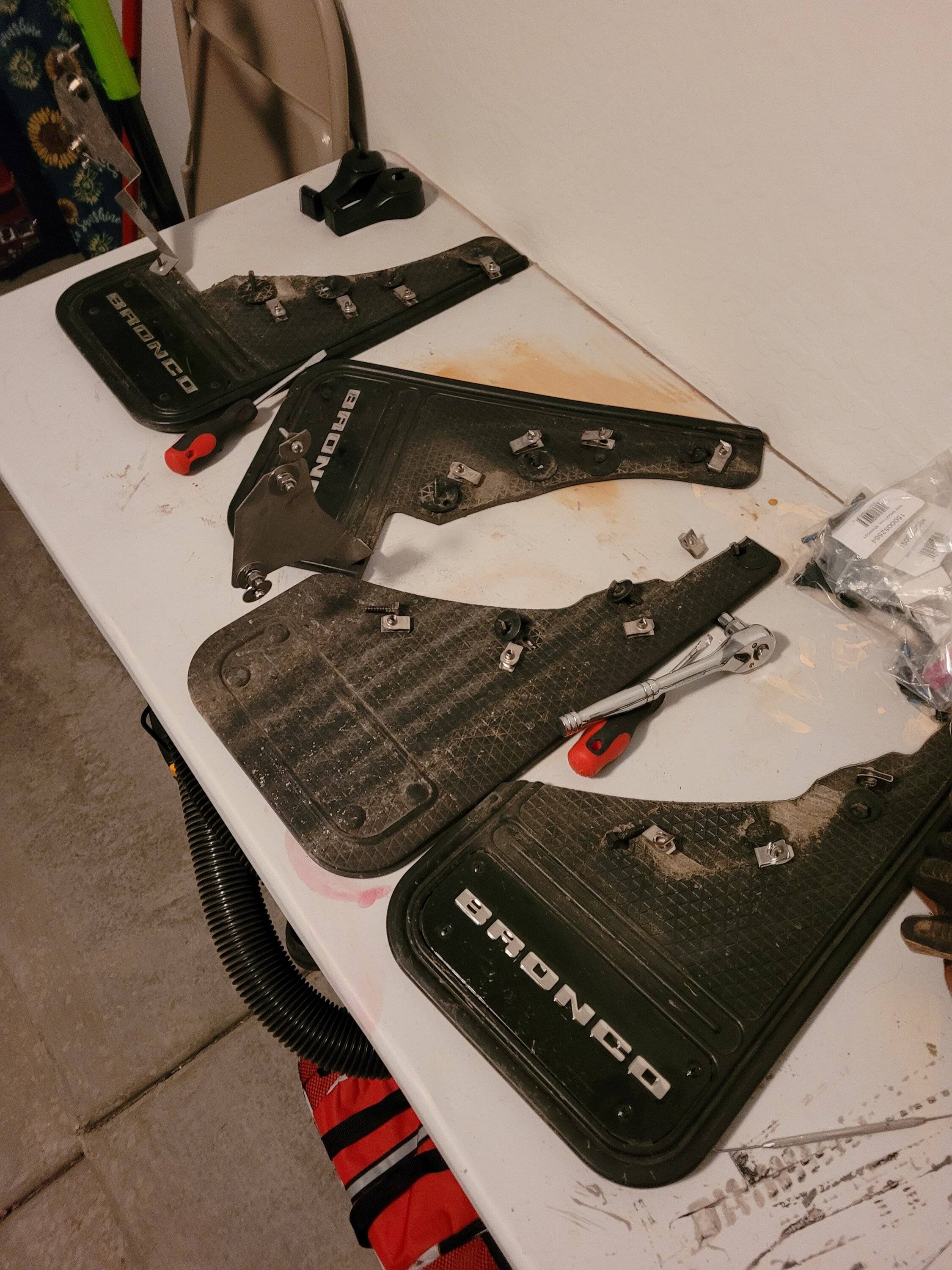

Removed my Gatorback mud flaps from my Big Bend to be installed onto my Badlands. Pretty nasty process, lots of gunk caught between the flaps and the felt liners. Excited to give them a thorough scrubbing.
Also discovered the dealership kept the little plastic pins which hold in the felt liners when they installed my flaps. Now they're not super secure, but I'm sure if they notice, those plastic pins are something the dealer has on hand to replace. Doubt they'll even see it when inspecting on trade-in day.

You can pick the push pins up on Amazon pretty cheap I think. I have some as well but might be quicker to get them from Amazon.

Just found them, but I genuinely don't think the dealership will even notice. Just took a drive and the liners didn't move at all. I'll just let it ride since I'll only be driving it for another week or two, and only here in town.

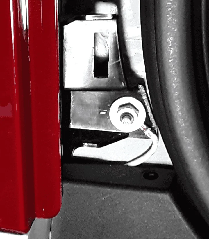

wiring in curt trailer harness
directions call for drill and self tap ground screw
really dislike overhead drilling
even with safety goggles
caught steel in the eye twice
so we look for options
spot the 10mm screw holding muffler
might do the job
decided to ground at the driver side rear light
stud and nut looked like steel
went for it
advantage: shielded from elements
seems like all trailer lighting fails for me have been ground related
power cord videos say underneath route
I'll do an exploratory roof liner run to "A" pillar

follow up to yesterdays post
checked stud used for grounding harness controller
Battery 12.59 volts
Battery through voltmeter to grounding stud 12.59 volts ✅
