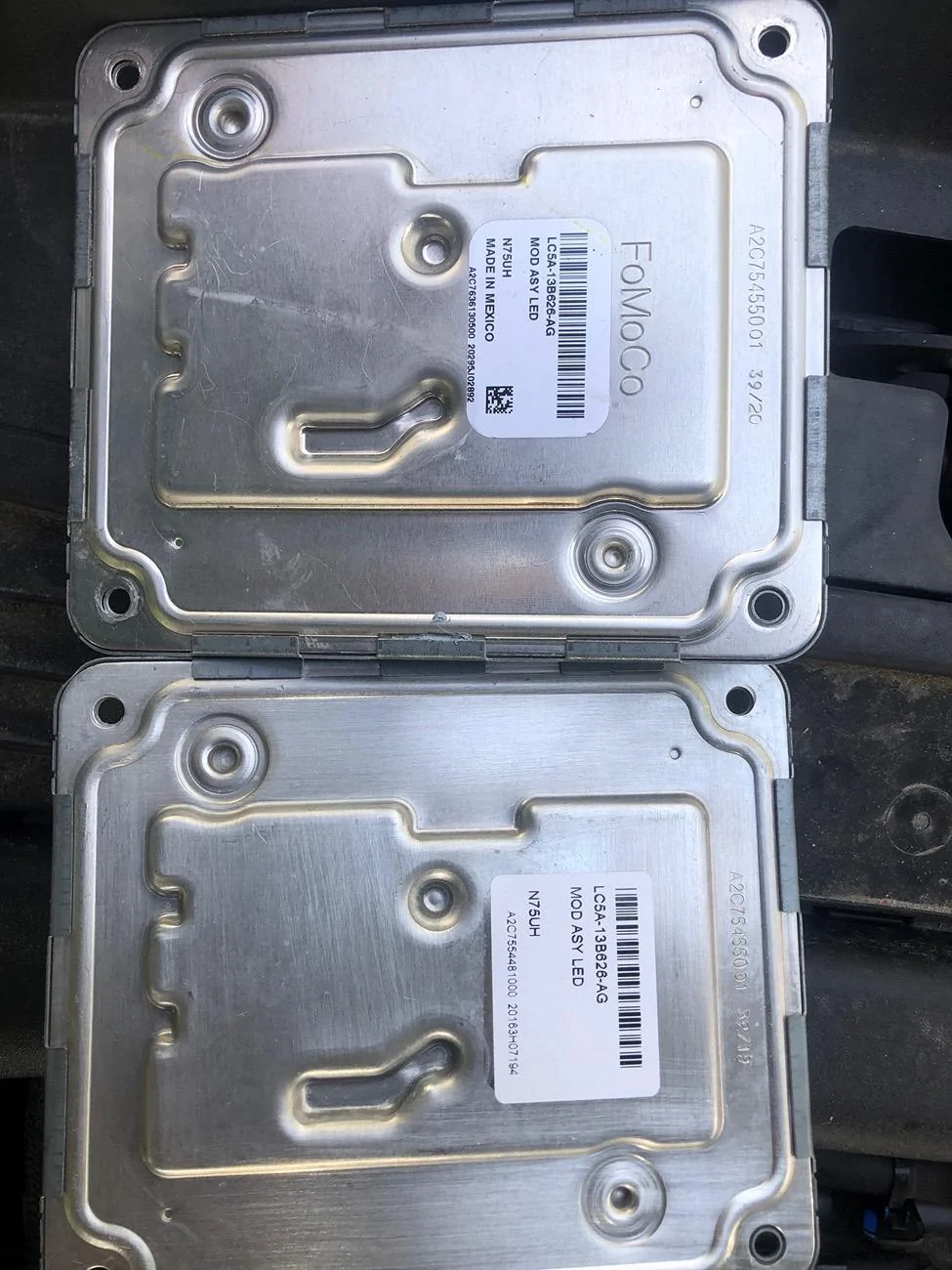

I’ve been meaning to reply for a long time but keep forgetting to update.
the module I bought on eBay did in fact restore my headlight. However, the programming was slightly different.
For Example, when exiting the vehicle and locking with the fob, the DRL would stay on for 30 seconds (adjustable in settings) then the original passenger headlight would cut out immediately, but the driver side would do a slow fade down.

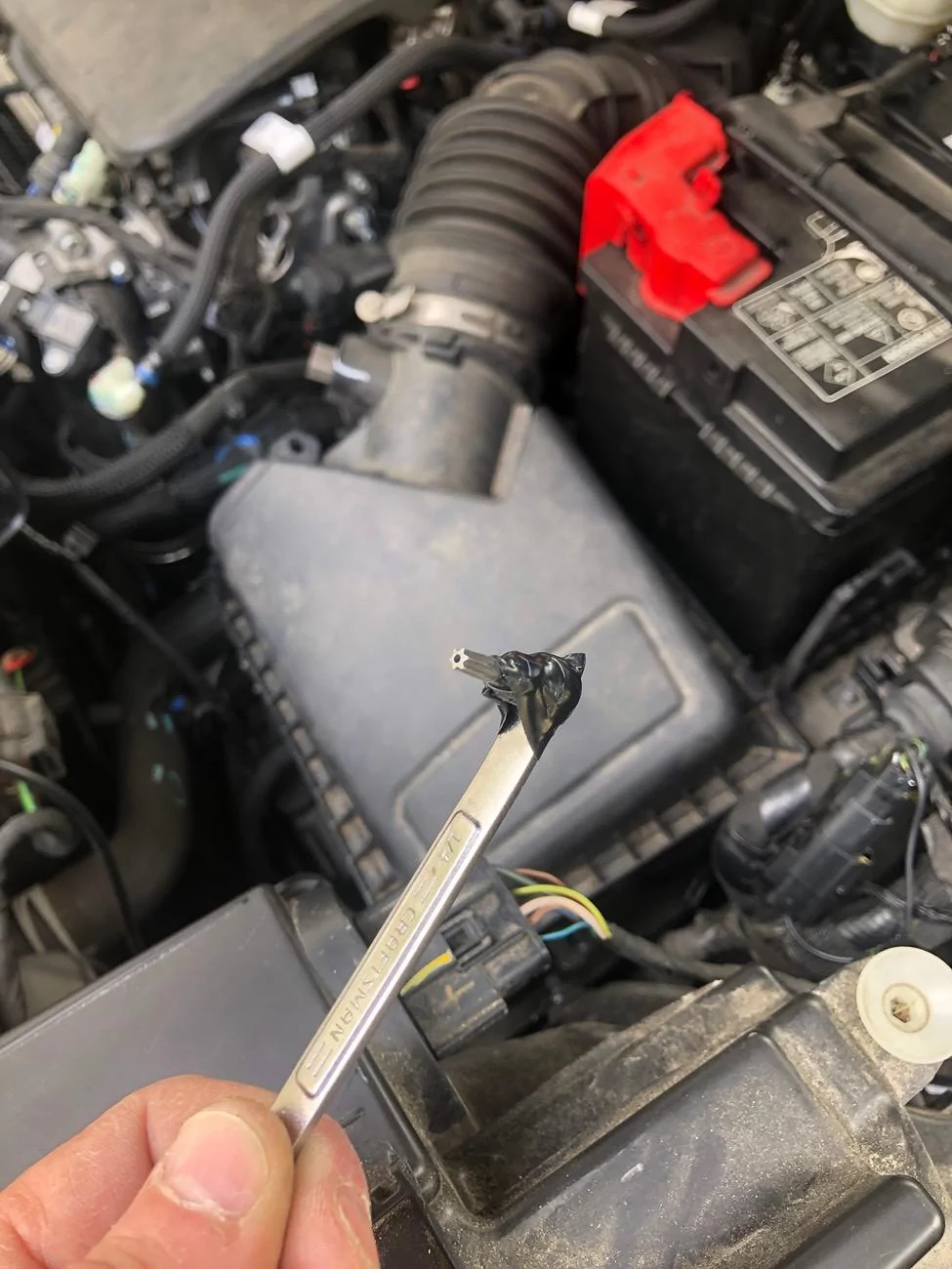

I replaced this module on Easter Day, and only had to remove the air intake box to access the screws. If you want a step by step, just let me know.

Various names for that Headlamp module including:
LC5A-13B626-AG LED Headlamp Ballast Control Module Unit Compatible with 2021-2023 Bronco Sport Xenon Ballast HID Headlight Assembly Unit
LC5A-13B626-AG Xenon HID Headlight Ballast fit for 2021-2023 for Ford Bronco Sport
Does that Headlamp module show up on the wiring diagram and if so do you know if the Headlamp module is driven by the BCM Body Control Module? (I’m assuming you were provided with the Bronco Sport wiring diagrams).
Perhaps the Headlamp module you purchased was defective in that it failed quickly. I see them on Amazon as low as $43. But is also possible whatever caused both Headlamp modules to fail is the root cause.

Yes - see pics in Post #17 for part numbers - often sites like Amazon, Ebay, etc. contain misleading descriptions but also possible the part works for various vehicles with differing hardware and configurations.
