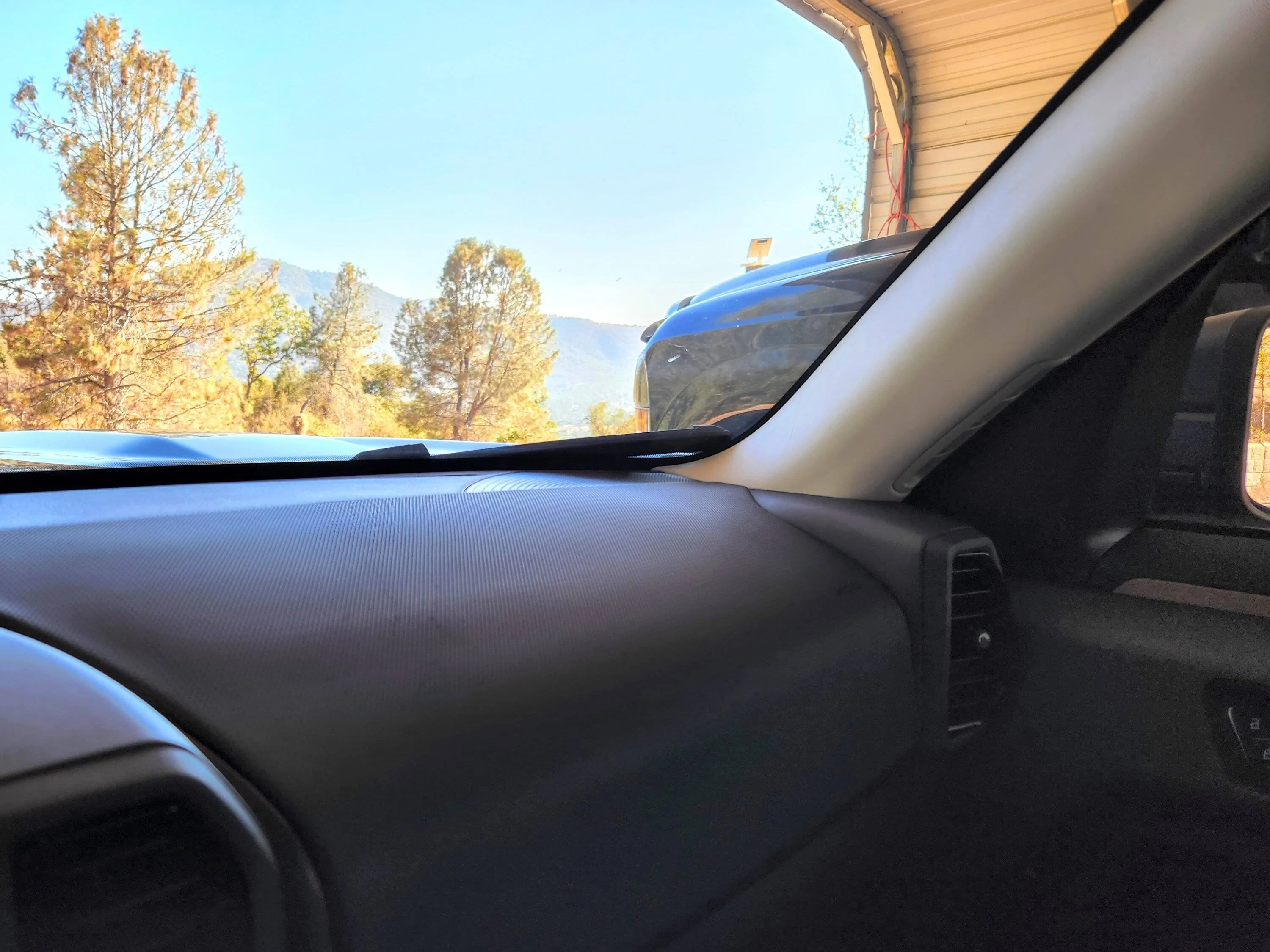

Ford Bronco Sport Windshield Replacement - Camera Calibration 20220815_173448
Just had my windshield replaced with OEM, and it appears they didn't re-install the wipers correctly as they are sitting much higher and run off the windshield when activated. Back too the shop tomorrow to have them fix the issue.
Anyone care the snap a quick pic of their wipers when at rest. I can't remember how low they are supposed to sit.
Oh, and yes, I needed a recalibration which apparently requires them to drive the vehicle for a few miles. I watched from the Ford Pass app as my baby left the shop and made a trip around the area and back. :)
My wipers sit below aft edge of the hood.
