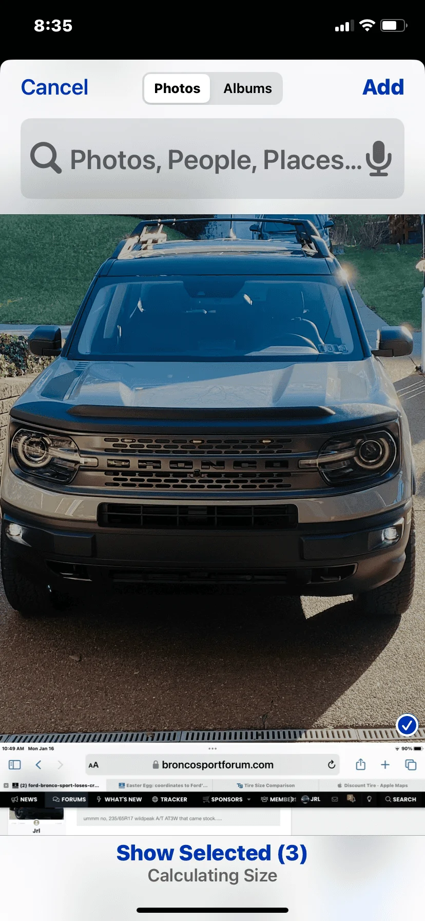

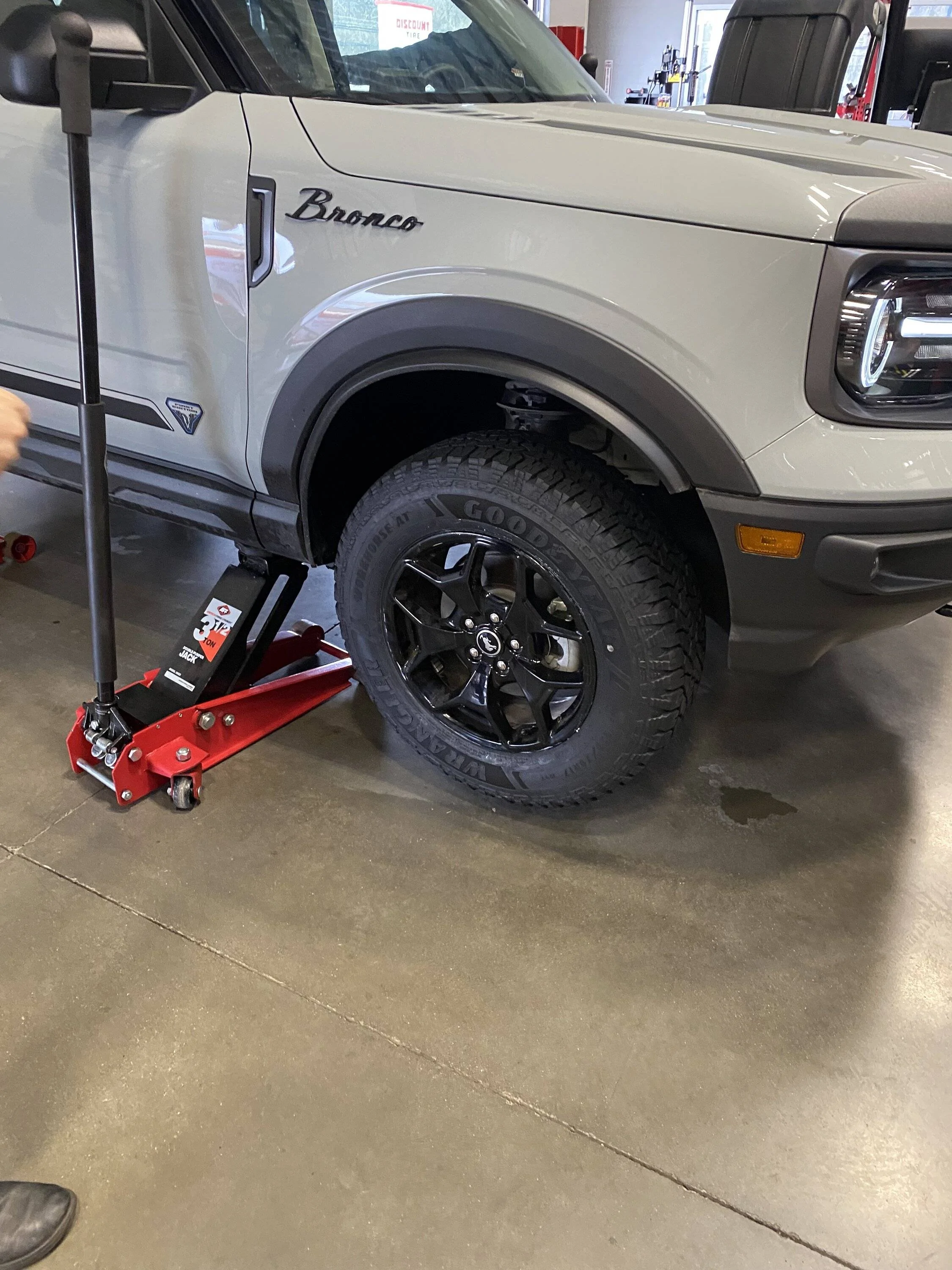

I have noticed in my Big Bend that with 245/65/17 the lack of power makes the transmission suffer and heats faster making the system to fail and go on limp mode. I will try lighter tires with gravel grip. What thoughts you have ?
You might want to look at the Goodyear wrangler workhorse 235/70/17 it is 33 lbs and the true diameter is exactly 30 inch . I have been running them on my first edition for about 5 months now , great ride with no power loss and no difference than my stock 235/65/17 .

can i rock 235/70/17s with just my lift?

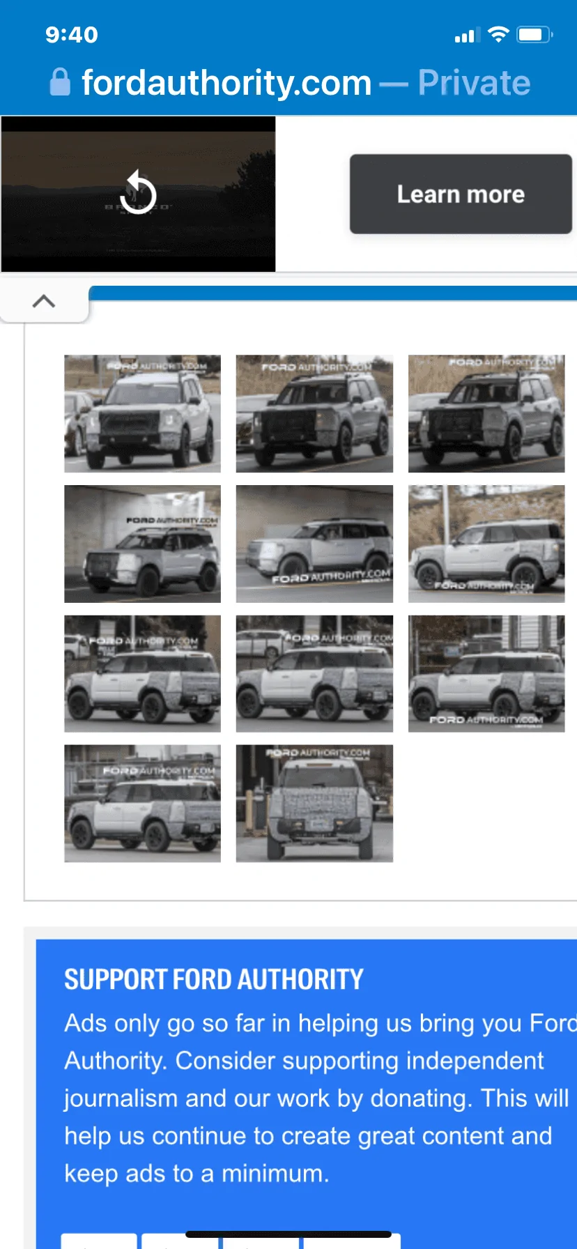

I have 235/70/17 on my First Edition badlands now for 10 months, no issues at all , mine are a true 30 inch and that is a hand measuring. I have Goodyear wrangler workhorse, they would be .a 1/2 inch taller than a 245/65/17 depending on the manufacturer. Lock to lock and compressed . No rub at all , is it close, yes . Check out my pictures. Last picture is a test 2025 bronco sport , look closely they are Goodyear 30 inch / 235/ 70/17 . Looks good and rides perfect. A 245/70/17 Goodyear wrangler workhorse is 30.6 inch true measure We installed it on my bs and it definitely rubbed the felt liners in the front at the left and right.
