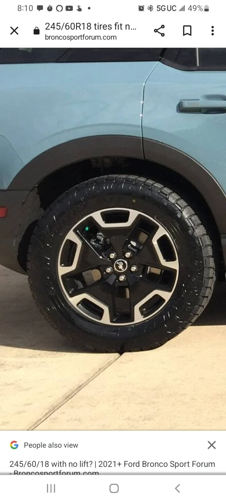

I'm curious what the whitest tire is that you can put on these rims
Ford Bronco Sport Widest tire can put on 18in factory rims? Screenshot_20230125-201051_Chrome

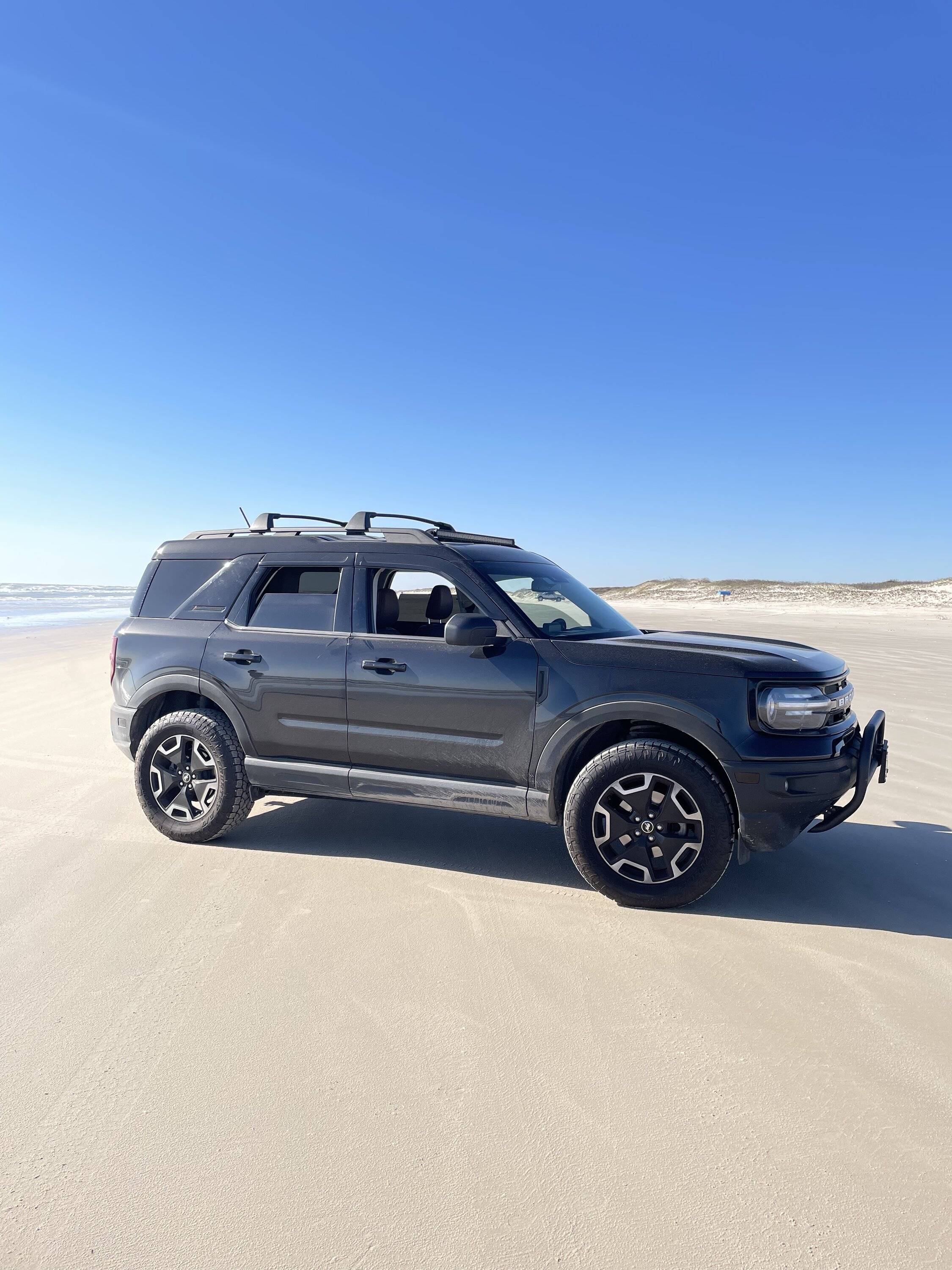

I have 255/60-18 running on mine with a 1.5 inch lift.
I had to remove the small wheel well mud flaps in the front of each tire due to rubbing when driving. Wind would push them against tires and start to melt.
I also have a little bit of rubbing in the front wheel well fabric liner. That also might be because they ripped from their undercarriage mounting due to wind as well. But I put in some 1/2” offset spacers to push my tires out a little, and that seemed to help the passenger side where the liner had not ripped yet.
All in all, there is clearance though. I recommend offsetting slightly though, just to make sure you don’t rub when turning your steering wheel.

would a 245/65r18 fit in a non lifted bronco?

Highly doubtful, you are increasing the height by almost 2 inches, plus there are not many options for tires in that size anyway.
I see. I just got my outer banks last week and i want to get some new a/t tires. Some say i should get a 235/65 or a 245/60. I’m looking for tires that will fit and can make my OB a bit aggressive looking without using any lifts. Thank you
