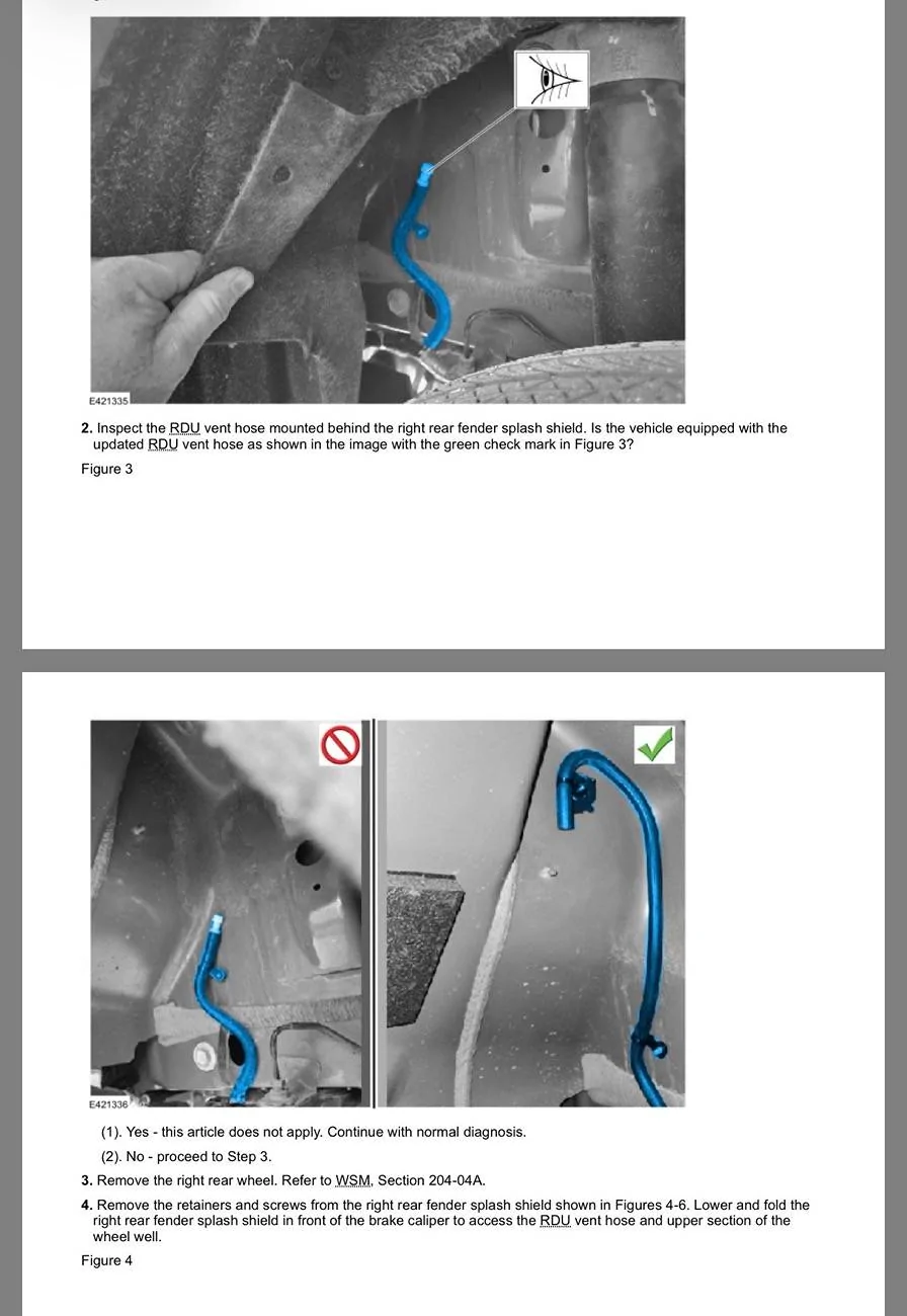

As I've mentioned other times, our local dealer wants $582 to replace the vent tube per the TSB, plus they can't get one from Ford or so they told me. I'm thinking it can't be that hard to replace? I haven't had a look but some sources say it's a $20 part, so how many hours does this take?

I've not seen the hose itself but could you simply slip a larger peice of pvc / fluid or air type tubing over the end of the existing one to extend and reroute without removing the old?

@Jube Drain tube (RDU vent hose) for the rear differential gets clogged

TSB 24-2386 Chatter/Shudder During Low Speed Turning Events
(supersedes TSB 24-2185 which supersedes TSB 23-2335)
See this link for TSB 24-2386:
https://www.broncosportforum.com/forum/threads/tsb-24-2386-chatter-shudder-during-low-speed-turning-events.16524/
“According to mechanic the drain tube for the rear differential gets clogged from road debris and dirt gets into rear differential.
The repair is rerouting drain tube (new part) and changing fluid.”

“According to mechanic the drain tube for the rear differential gets clogged from road debris and dirt gets into rear differential". So what happens if dirt gets into the rear diff? Does it need a flush? Does the dirt cause damage?
My guess is if some dirt does get in a drain and refill would be the minimum needed. Various components of the RDU to the RDU itself have been reported by owners as repairs needed to their vehicles.
