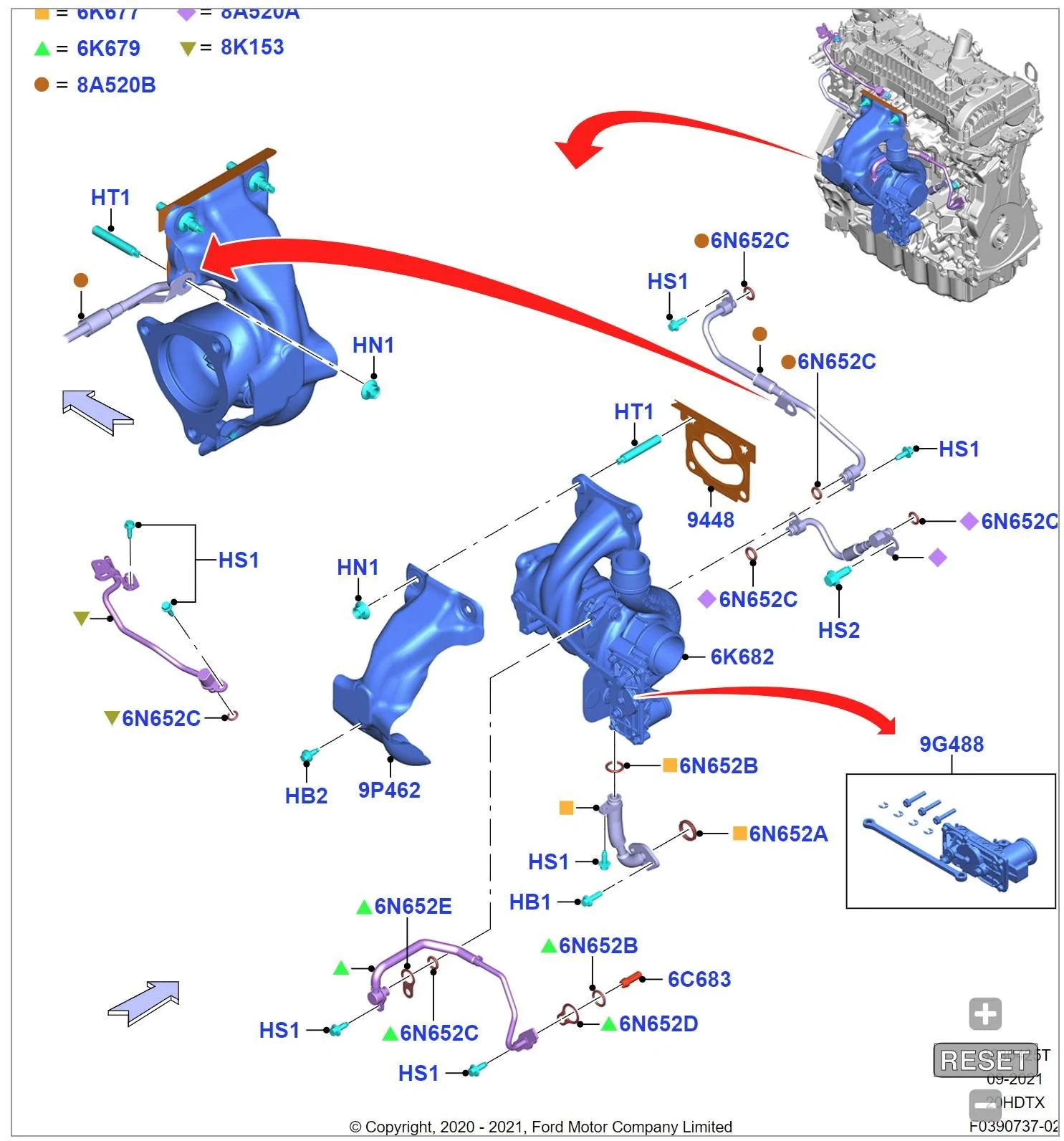

"the turbo is incorporated into the manifold as one piece. "
Not quite right. While there was a 2L turbo that had a fabricated sheet metal 4-into-1 manifold combined with turbine housing (and it was a K03 turbo), the current engine has an "IEM" head (integrated exhaust manifold), where the 4-into-2 runners are water cooled and cast into the head, and the turbo has a twin scroll turbine housing...not sure if it's Garrett or BW at this point.
From parts.ford.com... the 9448 gasket shows the 2-runner port shape at the head.

https://www.ebay.com/itm/404354761731?mkcid=16&mkevt=1&mkrid=711-127632-2357-0&ssspo=Yl6wBEtQT_S&sssrc=4429486&ssuid=&var=&widget_ver=artemis&media=COPY
According to a friend who rebuilds turbos the one in this listing has a borg Warner stamping on it.
