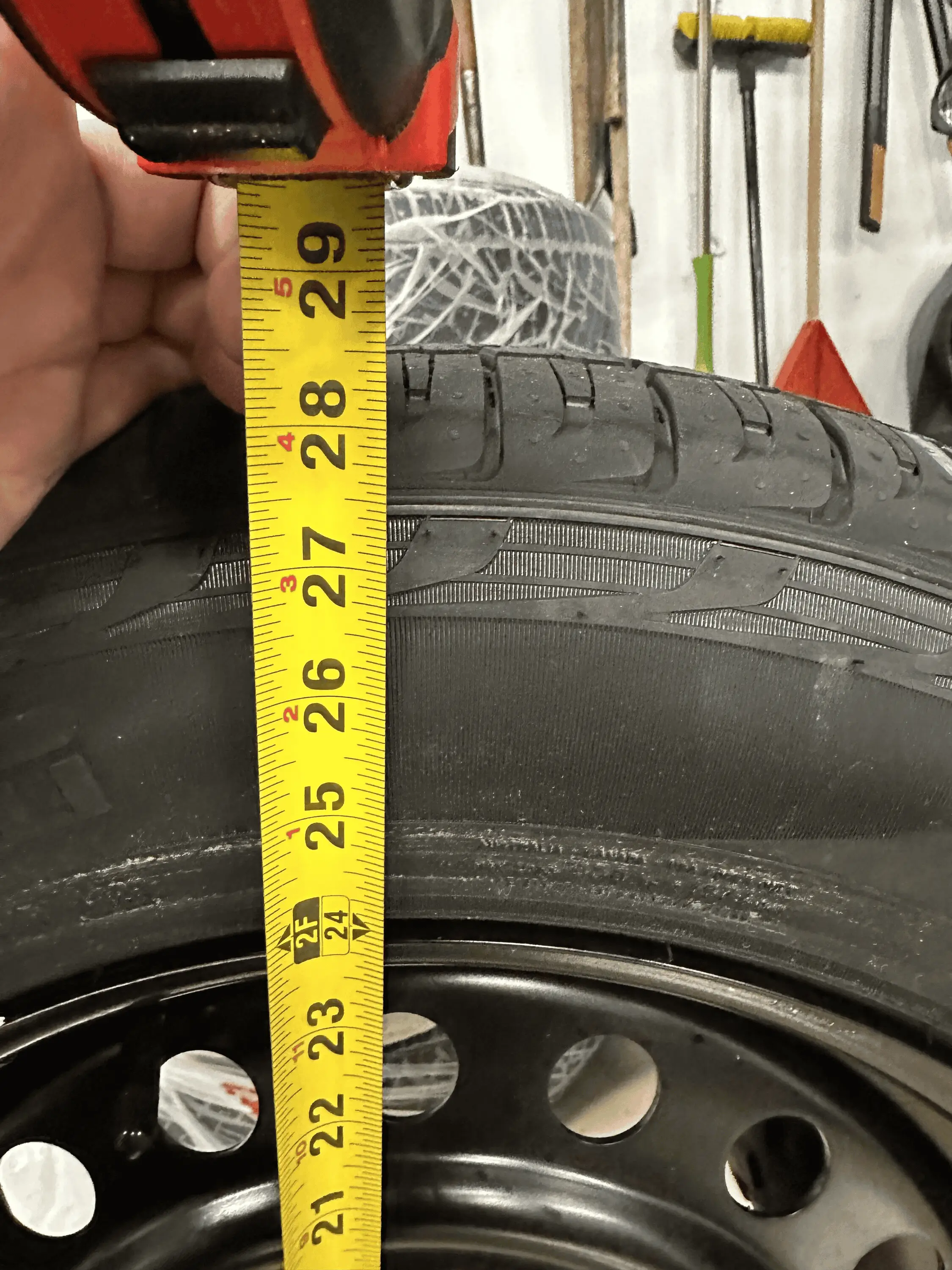

Do we know what the original diameter is, at least on a Big Bend?
1,423
1,468
My Goodyear are 30 inch exactly , my stock tires came with falken wildpeck 235/65/17 they are 29 inch. I think a Big Ben would be 28 inch .’

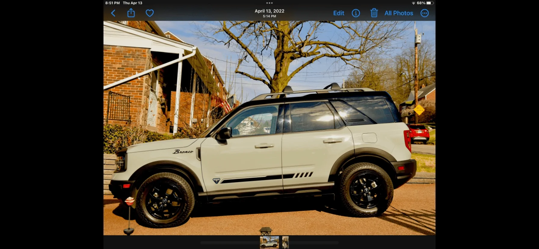

Ford Bronco Sport Which fits better: 245/65/17 or 235/70/17 ? IMG_0991
The OEM diameter on a BB would be 28.5" (225/65/17). On a BL it could be either 28.5 (225/65/17) or 29" (235/65/17 - if the optional Falkens are selected). On an OB it is still 28.5" (225/60/18).
