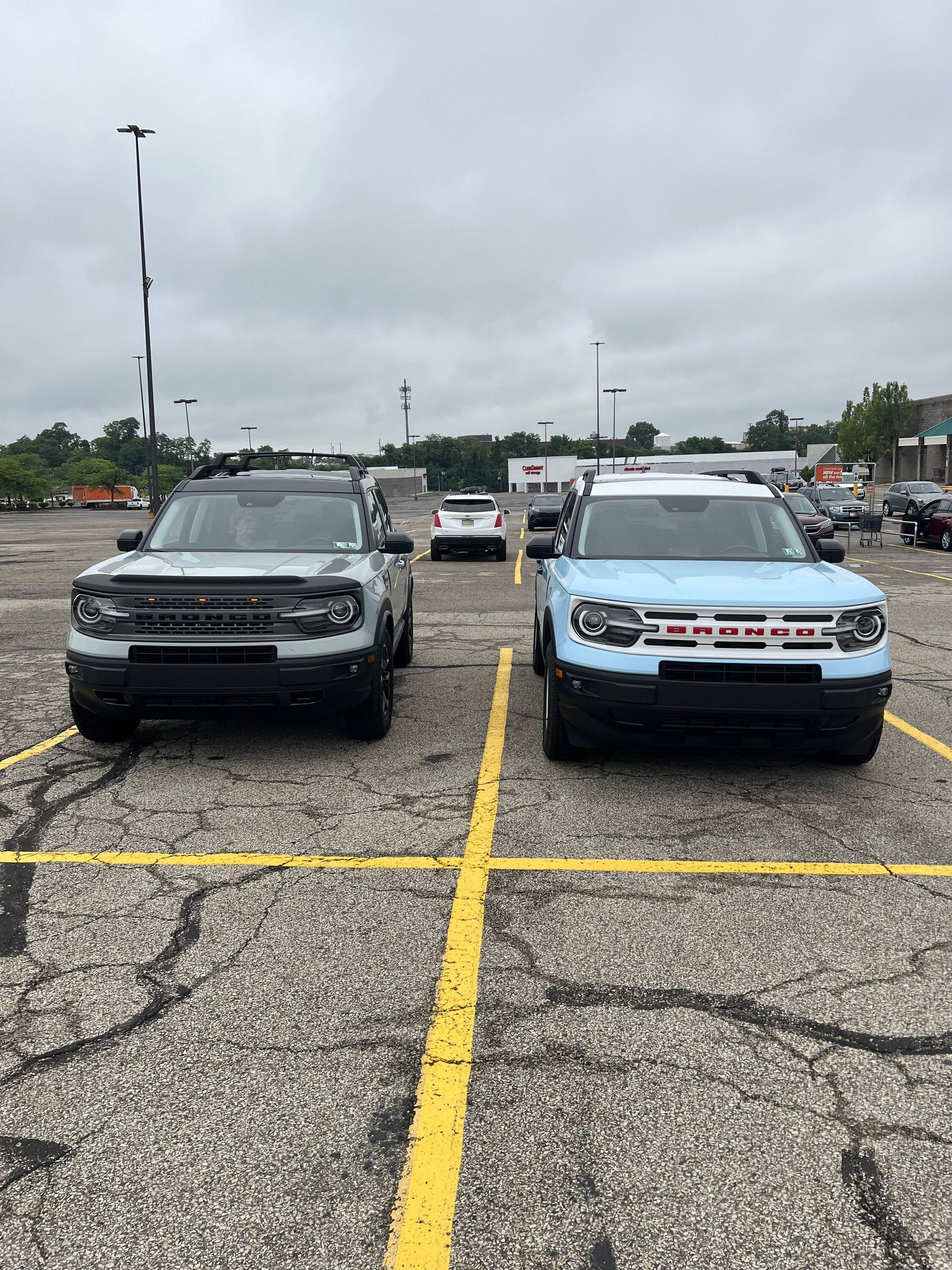

235/70/17 Goodyear wrangler workhorse. Coming up on 4 months now and all good for me ,no rub great ride and gives my first edition a very nice stance , my opinion.I do not off road at all but I did drive it up some steps with no issues.

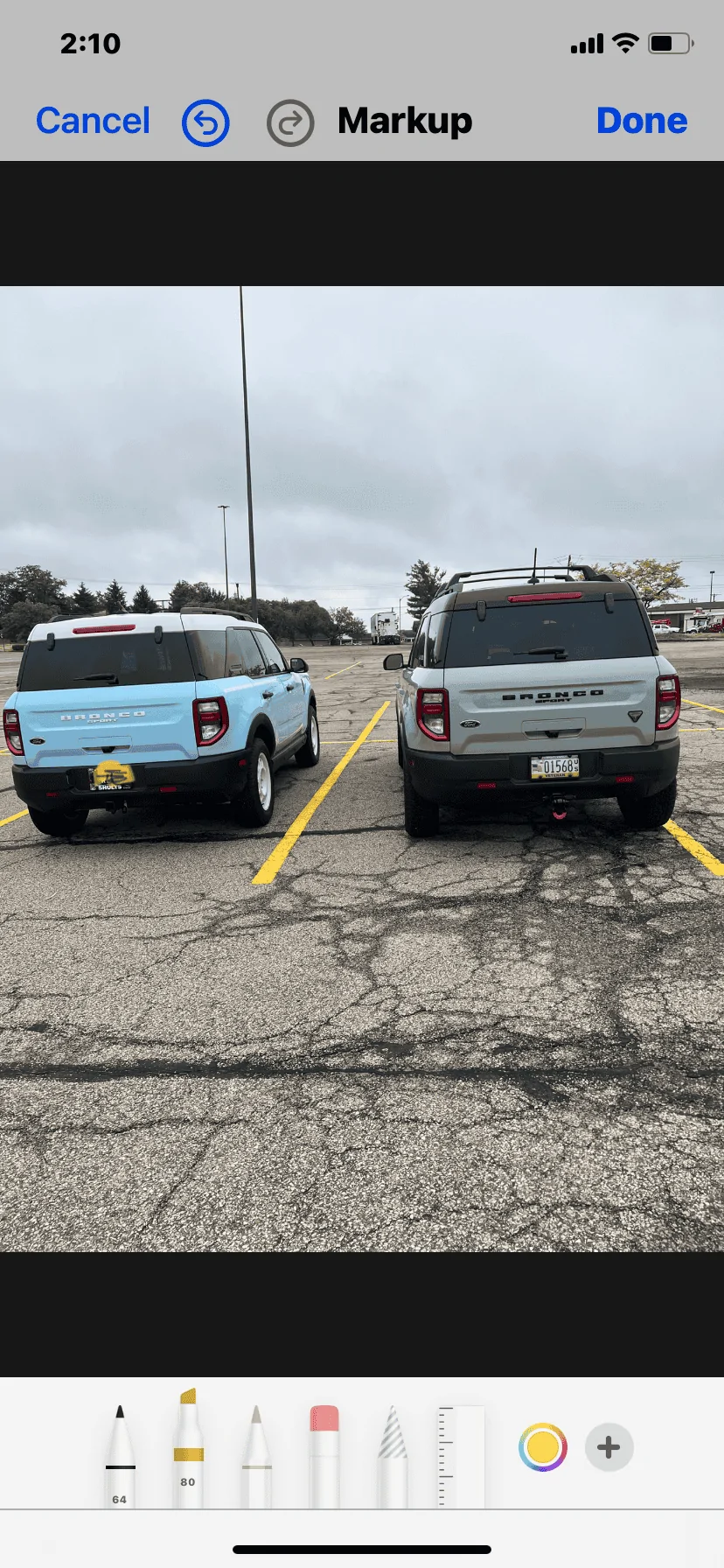

A friend has a outerbanks and he added a 2 inch lift to his and I had mine next to his and he was about a 1 1/4 lower than mine if that helps. I measured to the top of my crossbar and I get75.5 inch .

Have not gone there yet. Thanks for the reminder . Be very careful when you get your tires the one I bought is exactly 30 inch , Goodyear wrangler workhorse. We tried a 30.6 on and it rubbed on felt liner on lock to lock. My tires look pretty good and I like the full wheel well look.

Can you see the difference it is very noticeable in person?
