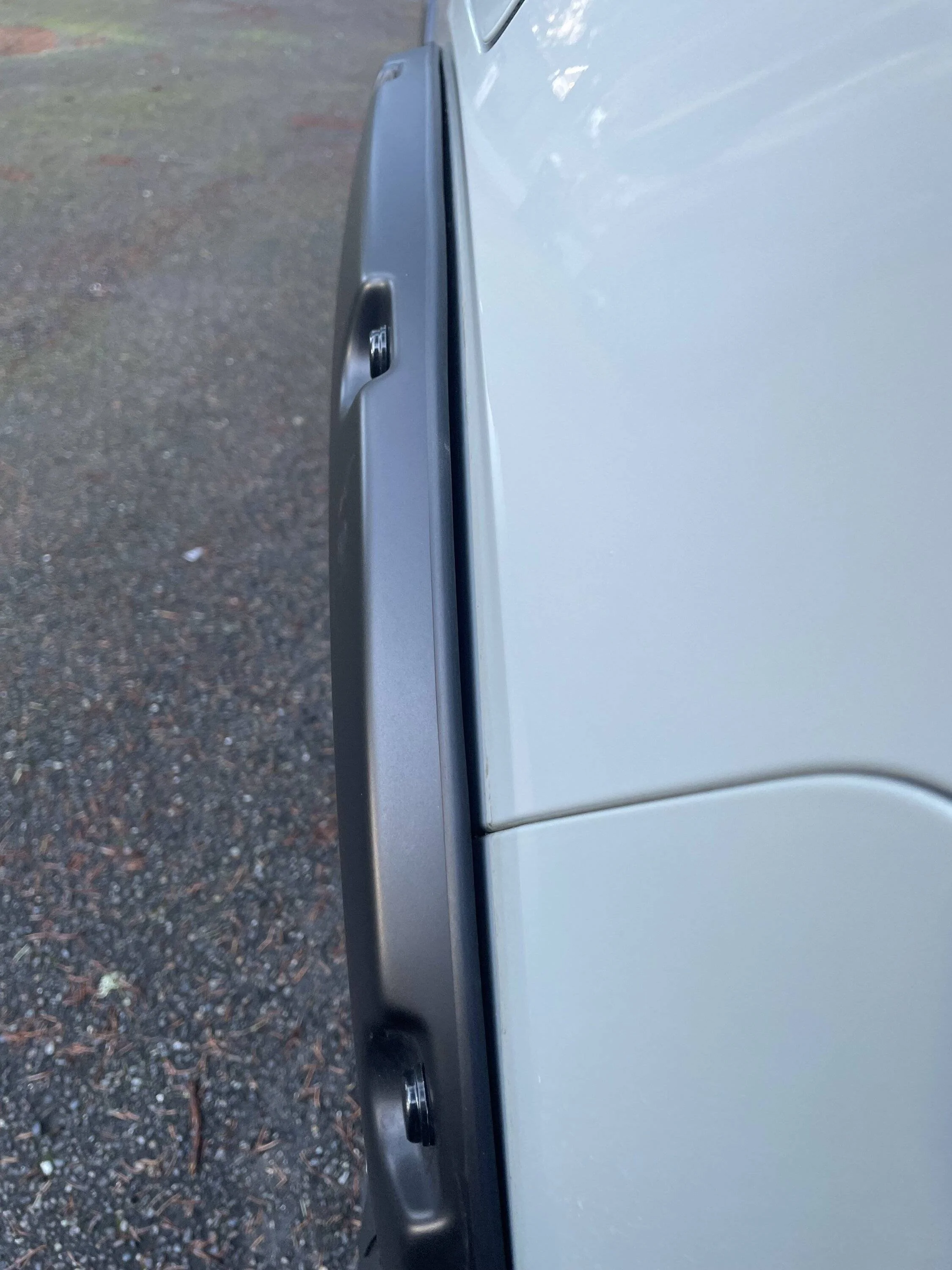

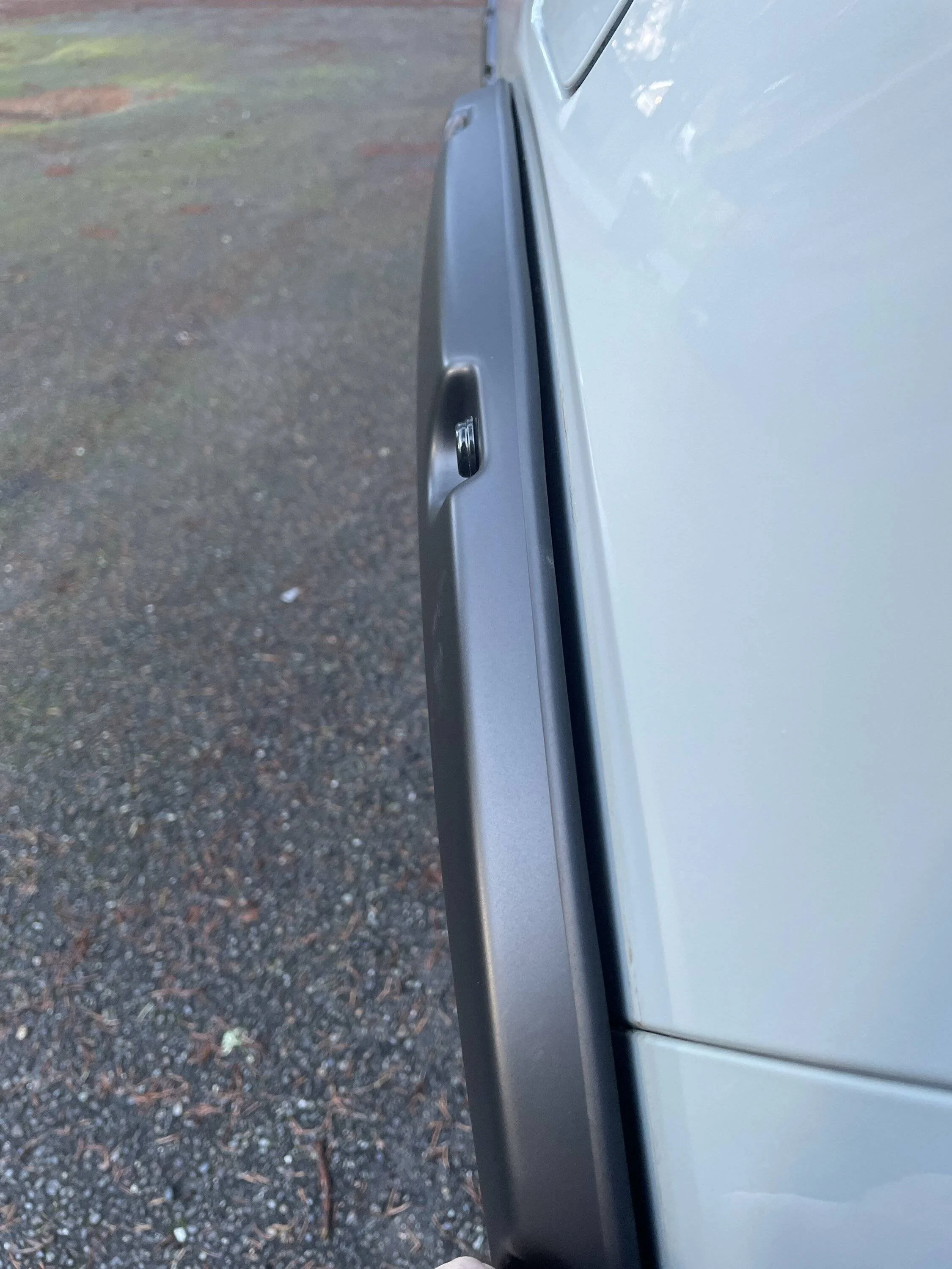

honestly was smooth but I believe they ran it through a car wash with a high powered air drier cause my rear fender flares no longer sit tight to the body anymore. Not sure what else would cause that. I let them know waiting to hear back. I won’t be able to prove they sat tight and flush before the appointment so I’m hoping they are cool about it.
minus the fender flare issue it was a great experience haha.
Update: a few of the clips were misaligned/crooked. Slid them back into place and everything is all good!

Had my first appointment today. Really my only option unless I take half a day off at work since they don’t do appointments Saturday or Sunday at my dealership.
anyone feel free to let me know if that’s me being ridiculous. I never want to be THAT customer so I’m extremely understanding but it’s loose enough that I noticed and feel like it might pop off at 70mph speeds

That’s where I may have screwed myself. He dropped it off while I was at work so I had to race outside and he did a walk around and took photos while I was talking with the driver he was gonna ride back with. I signed the papers and hurried and raced back inside and didn’t see the flares til I got off work. I’m assuming I’ll just be popping these off and biting the bullet on this one but hopefully they are cool

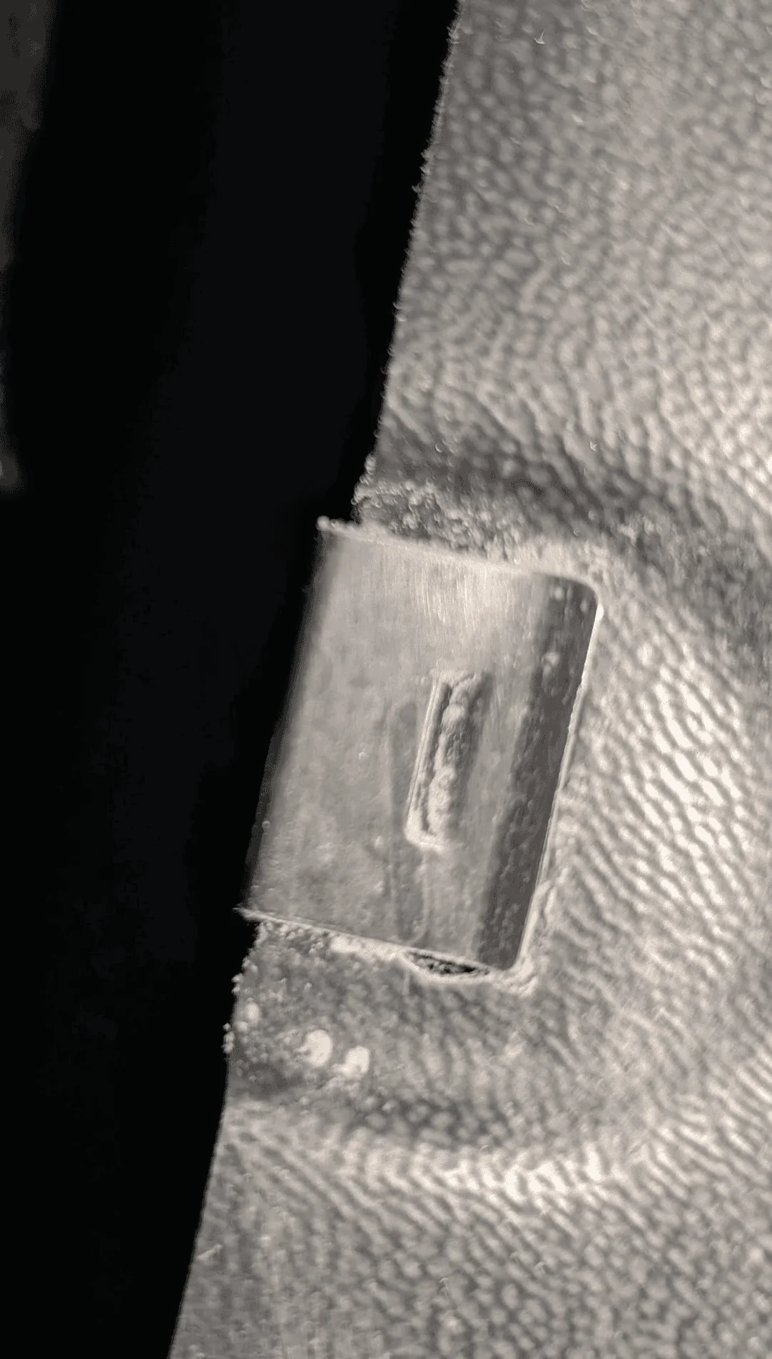

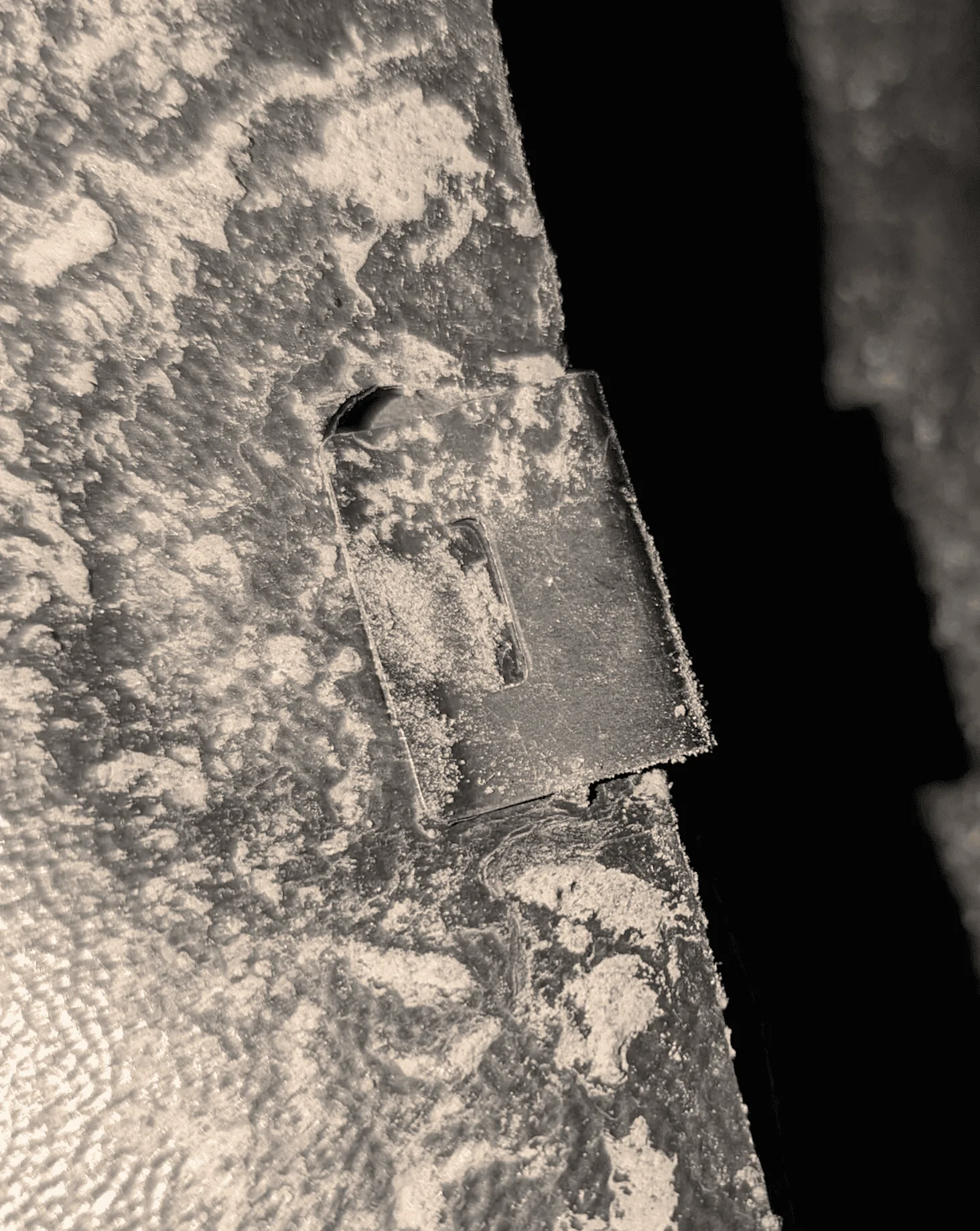

I'm with @jkeaton: check the installation clips. These work very well if correctly installed, but can easily slide off if not. The clips should slide all the way on to the edges of both the flares and the factory plastic liner. In the first photo below you can see one side of the clip is not completely bottomed. If you see a clip that looks like this you should press it all the way into position. If you can't press it on with your fingers use something hard, like a screwdriver handle. Don't pound it, just use the handle to push. If you push hard enough it will bottom out like the one in the second picture.
