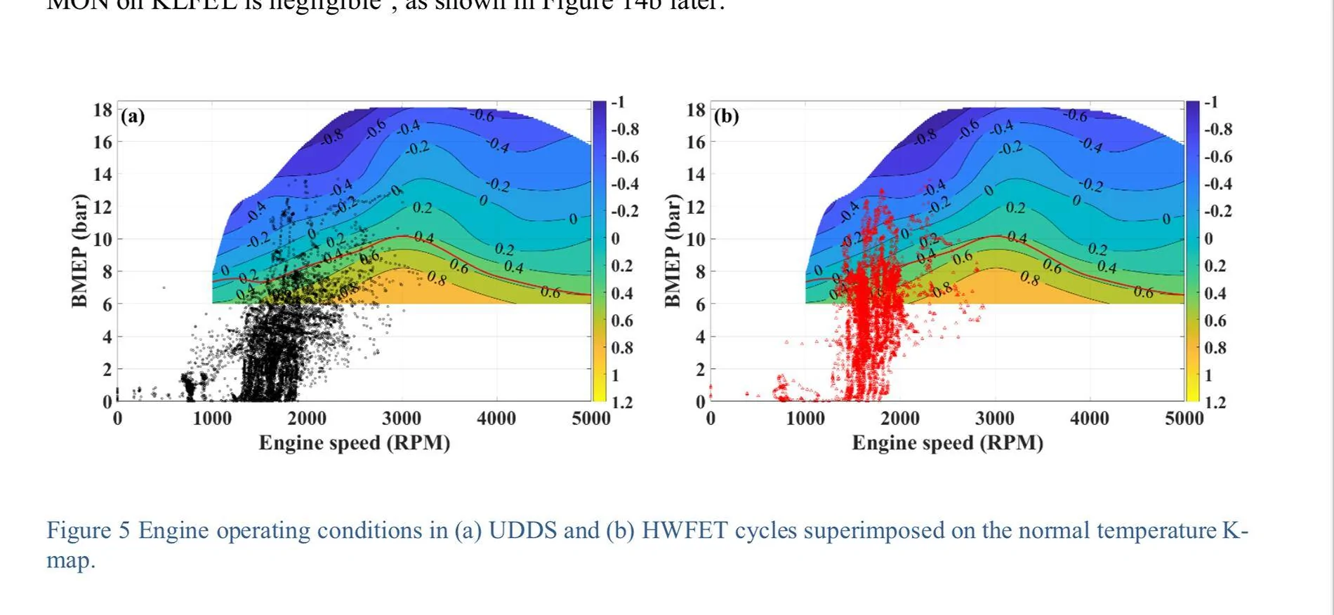

The test below (left normal test, right higher temp test) shows normal driving conditions versus the knock limit is in effect. (everything above the red line)
we are only in knock limited conditions about 20% of the time.

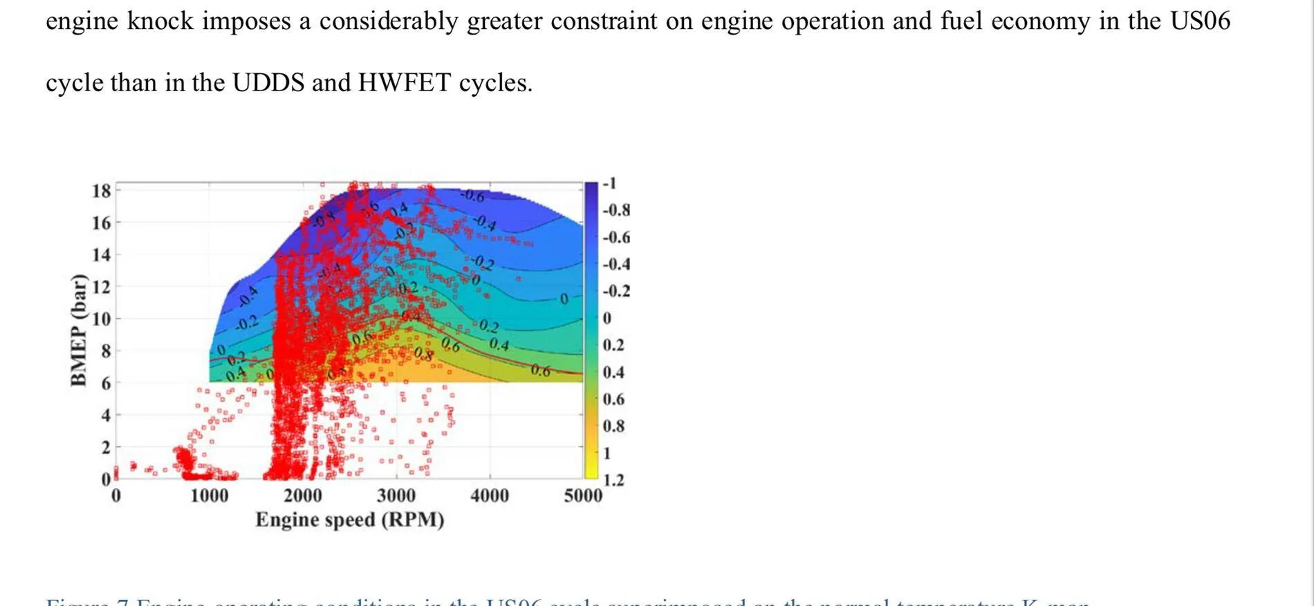

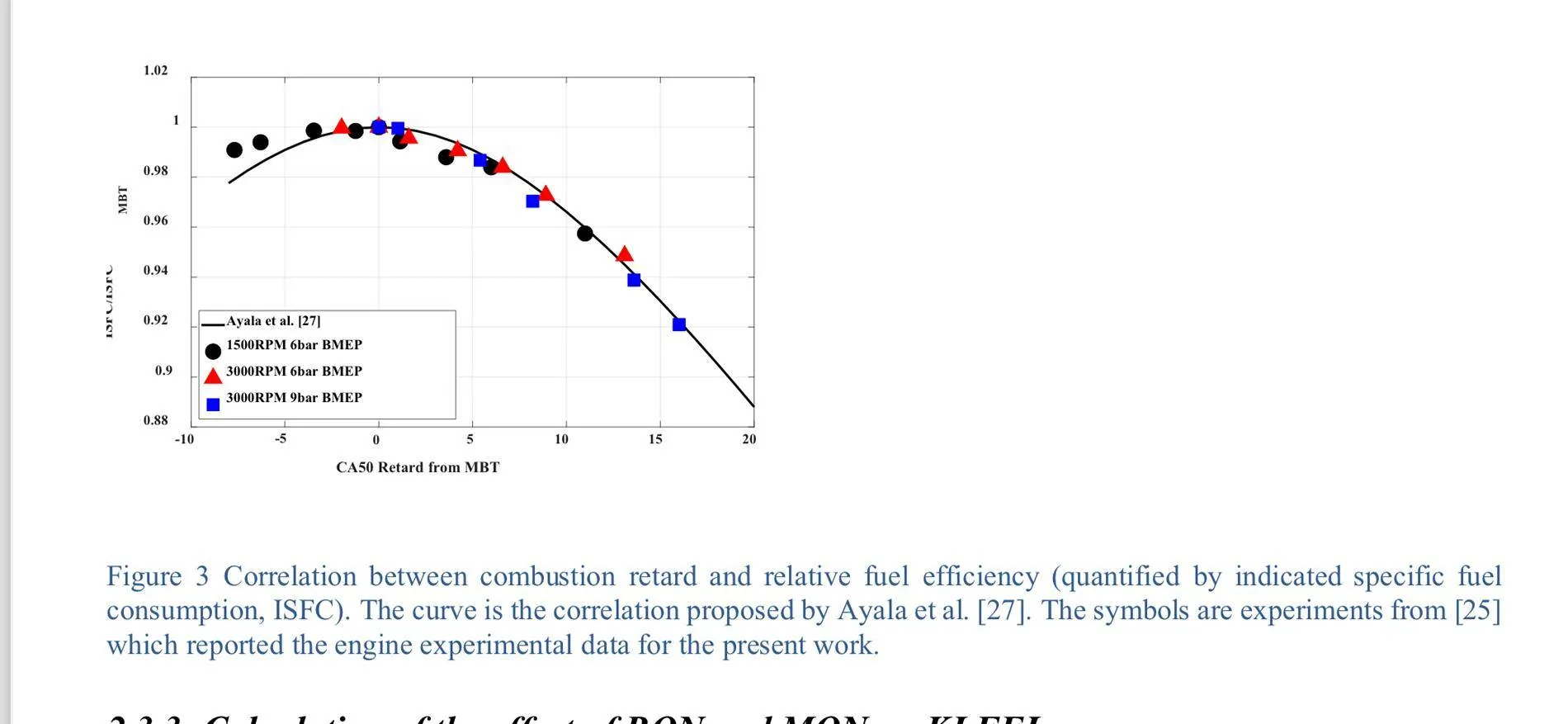

The knock-limiting has a big effect on fuel economy. Fuel economy plummets the more the limit is inplsnebted

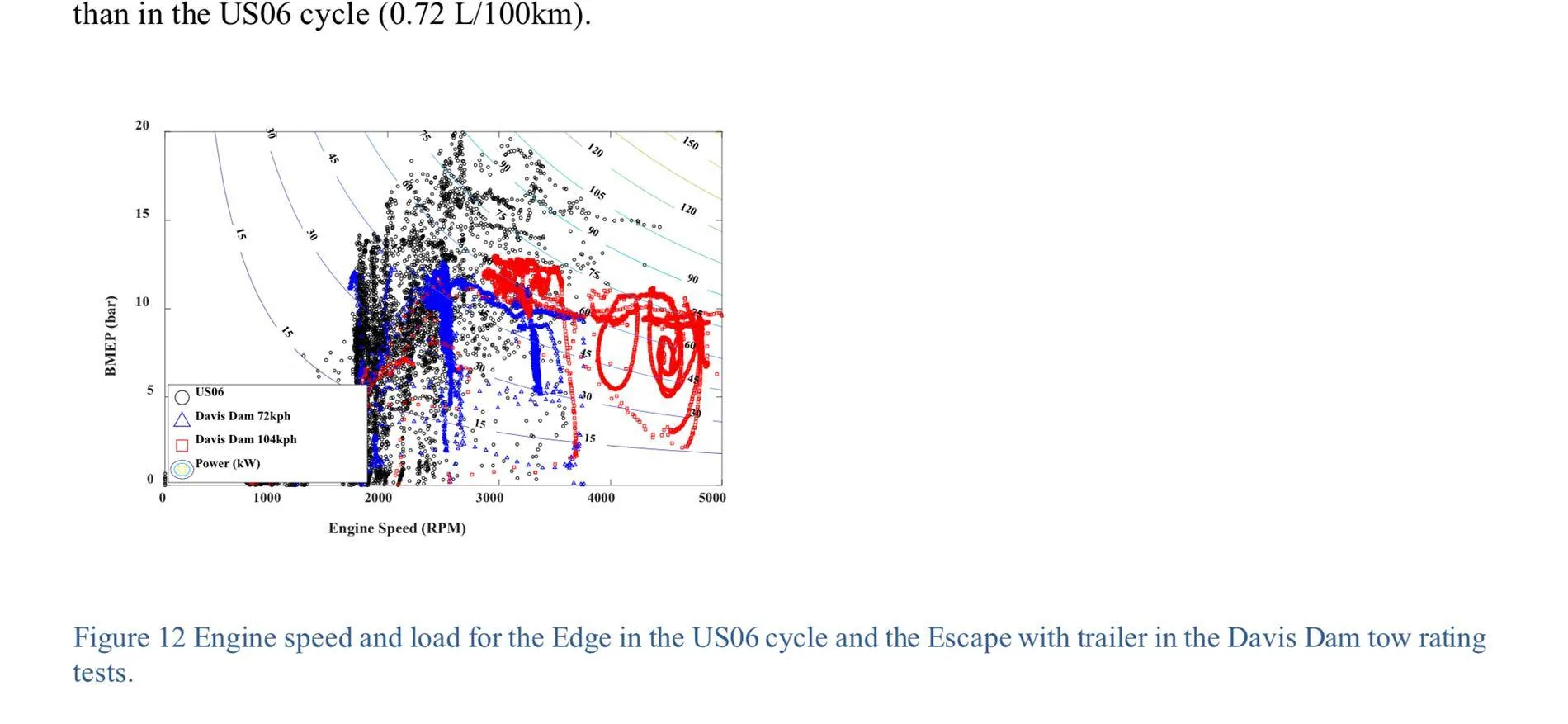

When the engine is under heavy load, the driving can be in the knock-limited range for up to 70% of the

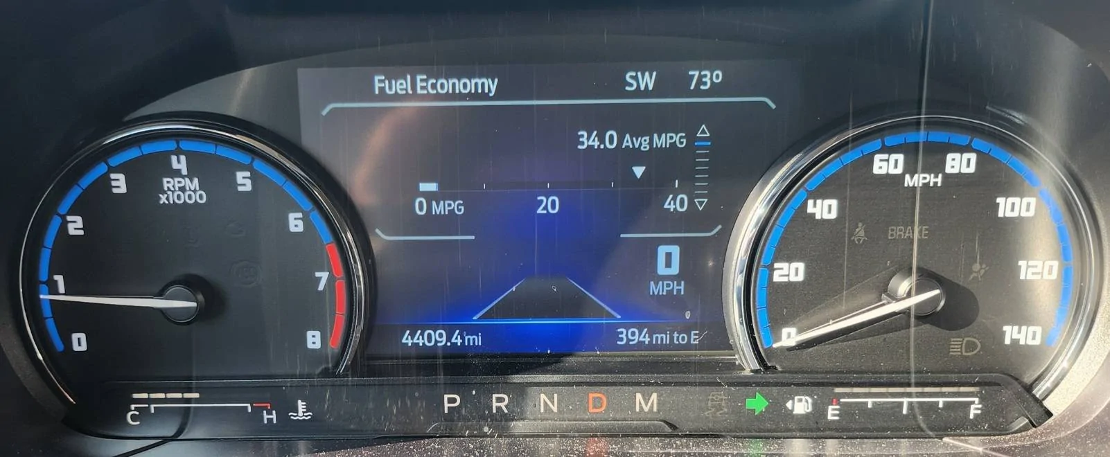

Very Nice. That would be th4 2.0 L, 4-cylinder engine with an official 20/24 MPG rating.
- You got 33.4 MPG for 3/4 of an hour at 58 MPH.
My husband filled the tank on his way back home, so the time was short.
He also took this shot, so what is true mpg from the trip?
There are far too many variables affecting fuel economy to answer this question with accuracy. The most accurate way measure fuel economy is over several tanks of gas in a variety of driving conditions. This averages out all the variables and yield the greatest accuracy.

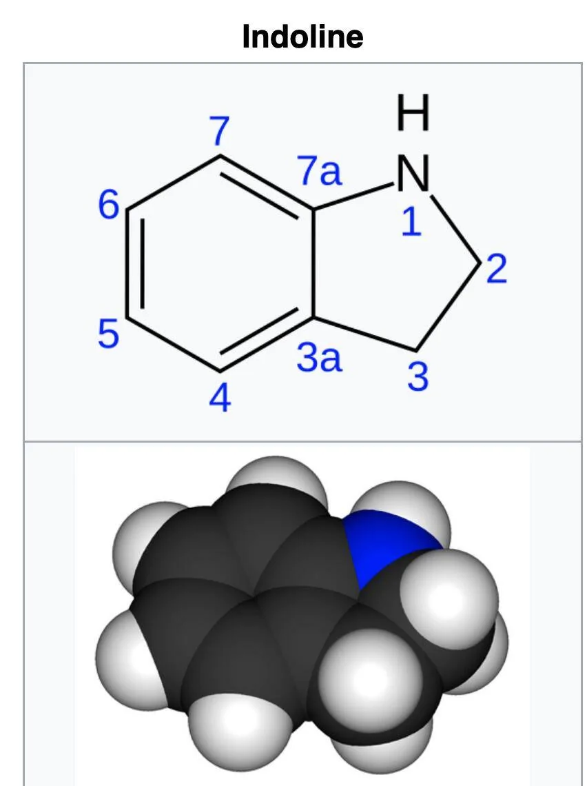

Testing fuel:
Indoline is an aromatic heterocyclic organic compound with the chemical formulation C8H9N. It has a bicyclic structure, consisting of a six-membered benzene ring fused to a five-membered nitrogen-containing ring.
Yes, but only when:
...the engine is under heavy load...
From the report (see Section 3 Results and Discussion):
Overall, the total [fuel efficiency loss due to knock mitigation] ... [is] only 0.3% for the [city driving] cycle and 0.5% for the [highway driving] cycle, corresponding to 0.028 L/100km and 0.036 L/100km in fuel economy penalty, respectively.
To put this in perspective: 30 mpg equals 7.8404 L/100km. A .028 L/100km penalty reduces that to 29.9 mpg; a 0.36 L/100km penalty reduces it to 29.8 mpg. One or two tenths mpg is all but unmeasurable outside of laboratory conditions, and is far cry from claims of 10% or even 20% improvement in fuel economy when using premium fuel.
IMHO, this report validates my claim, which is based on my real-world measurements: under normal driving conditions (engine not under heavy load) with the 2.0L EcoBoost engine, there is no mechanism or physical process under which the use of premium fuel can increase measurable fuel economy.
If you drive with a heavy foot you might see a slight improvement in fuel economy burning premium, but I don't believe it will be enough to justify the increase in cost.

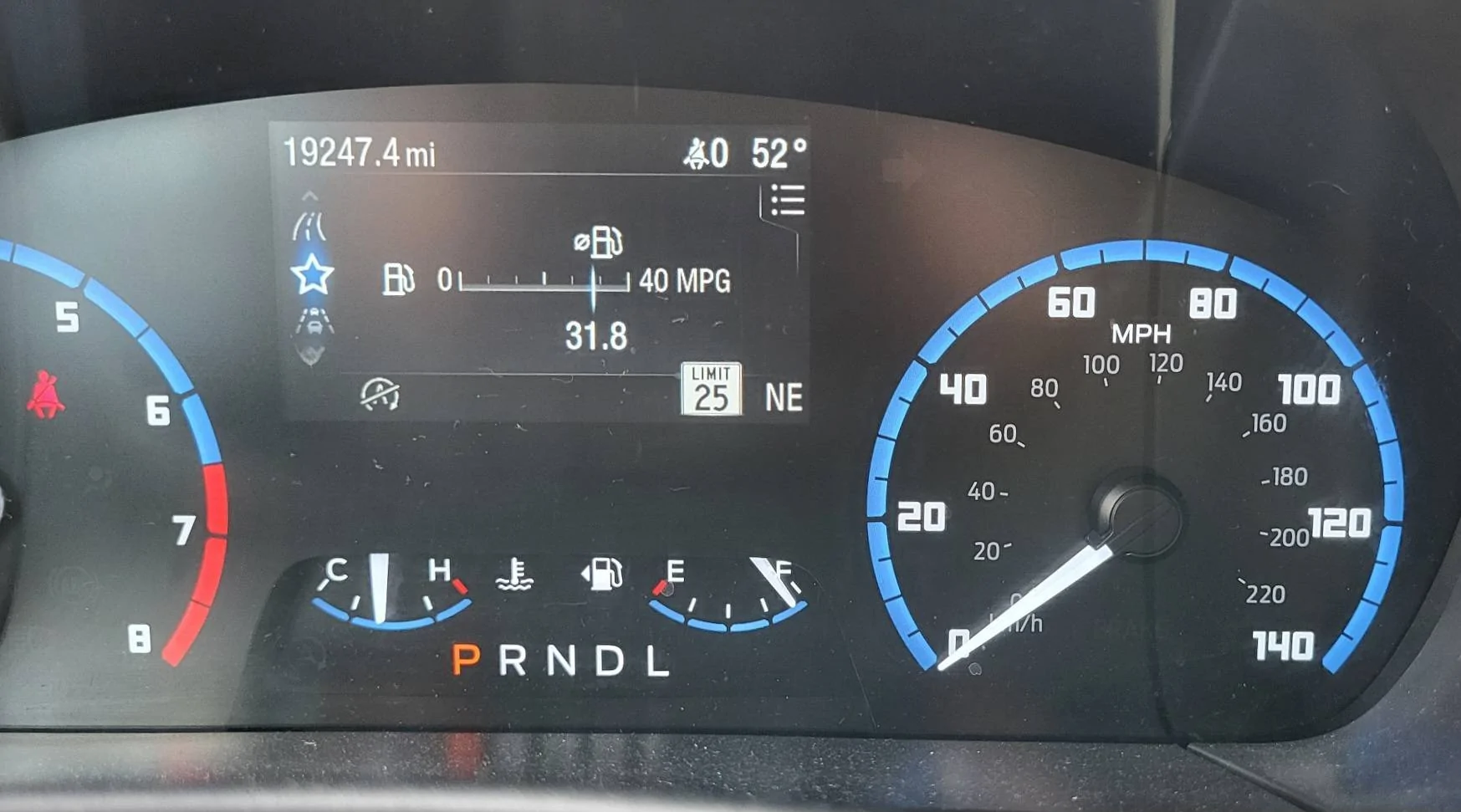

I'm getting anywhere from 28-31 mpg on my Badlands, it's had 93 octane from the get. Even made the dealer fill it with premium, got 32 mpg on the way home.
Turbo engines need premium fuel, probably why they recommend it. ?
No complaints here!
