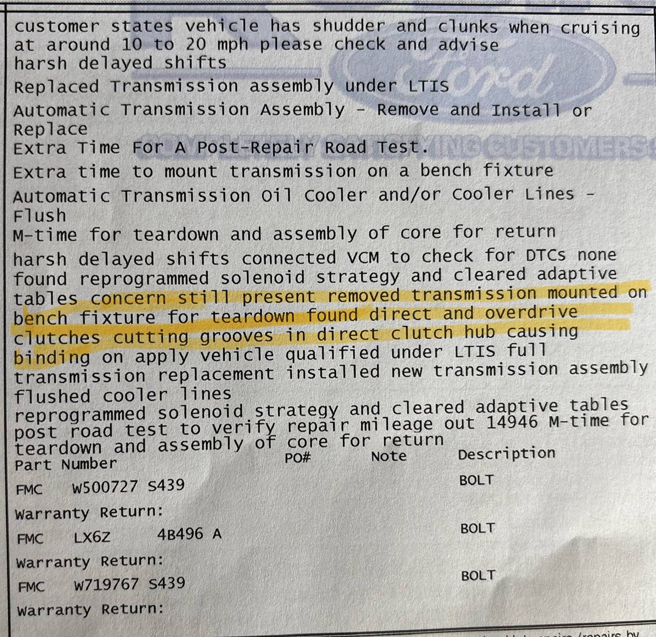

Update
I received a call today stating my bronco was done and that the transmission was replaced under warranty. I was a bit surprised seeing as though I was told it would be ten days and they would be starting yesterday, bad information from the service advisor. Here’s what was found:
Ford Bronco Sport Waving white flag - I think I'm done Ford IMG_1362
Ford Bronco Sport Waving white flag - I think I'm done Ford IMG_1363

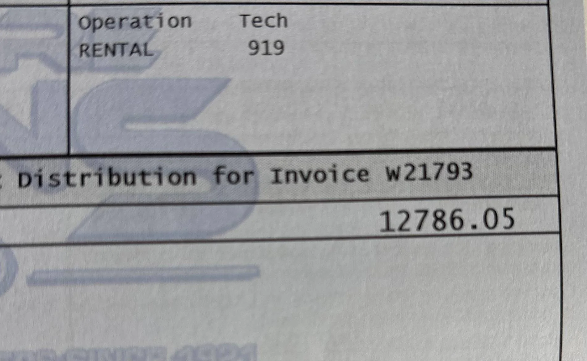

Is that a total cost of $12,786.05 ? (Under warranty for you so no out of pocket)
fourthgear
Jan 31, 2021
533
594
florida
That's one expensive Tranny replacement , good to hear it was at no cost to you .
