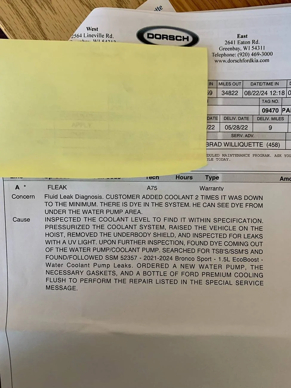

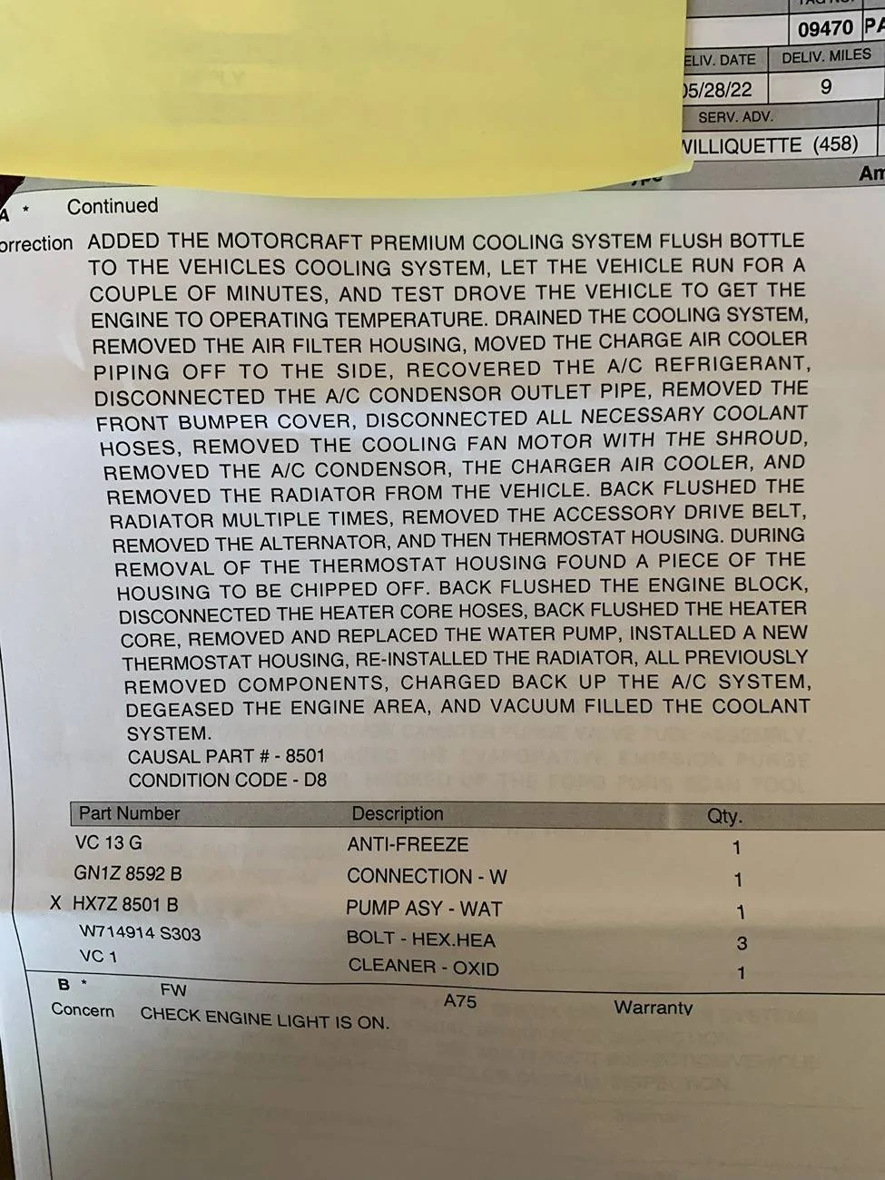

Well, had the pump replaced. Took a couple of days - gave me a loner. I've
Ford Bronco Sport Water Pump/reminder thumbnail_IMG_3954
Ford Bronco Sport Water Pump/reminder thumbnail_IMG_3955
attached the service pages to show what they did. All under warranty.
