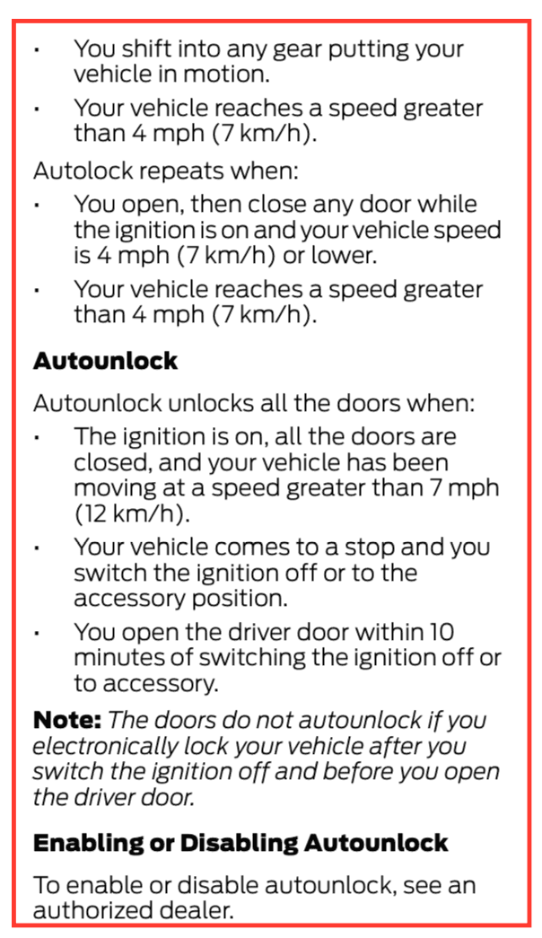

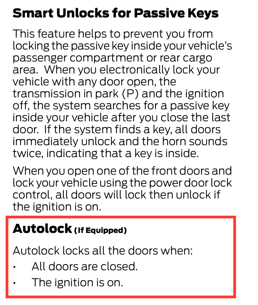

I located the following sections in the Owners Manual and these do not cover the exact scenario described by @DesertRat19
Ford Bronco Sport Warning: Doors auto lock with key fob inside 1687221450835
Ford Bronco Sport Warning: Doors auto lock with key fob inside 1687258197707

Also, there is the ā€œAutolock repeats when:ā€ section in the Owners Manual which i pasted in below. But this requires vehicle speed to reach a speed of greater than 4 mph.
Finally, I recall there is an auto lock configuration under Settings.
Autolock locks all the doors when:
ā€¢ All doors are closed.
ā€¢ The ignition is on.
ā€¢ You shift into any gear putting your vehicle in motion.
ā€¢ Your vehicle reaches a speed greater than 4 mph (7 km/h).
ā€¢ You open, then close any door while the ignition is on and your vehicle speed is 4 mph (7 km/h) or lower.

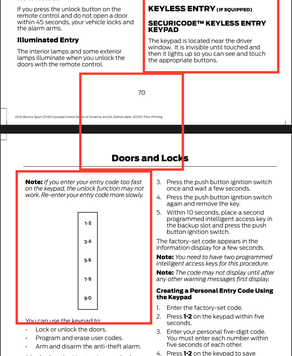

@davidg4781 .. i saw a different post where you inquired about the Ford aftermarket stick on keypad but just FYI the factory installed external drivers door keypad is nearly invisible but lights up when touched which is the one most people will have if their bronco sport was built with the factory installed optional keypad ā€¦ as described in this pic from the Owners Manual:
