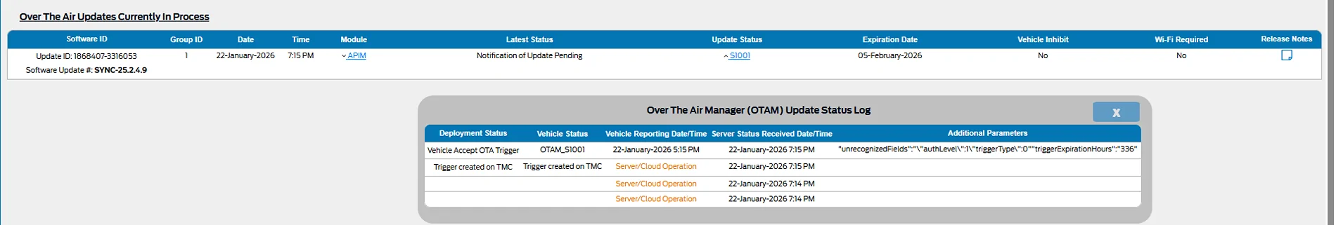

Code is for improper wake-up of the ABS module after a key cycle. Nothing to worry about it all. The code shows a 28 at the end which means it is a stored code and not an active fault. You can ignore it.
Ford Bronco Sport U3012-68 dtc code 1769211641054-v8
Also, you have an OTA for the APIM sitting in your queue since yesterday. All you need to do is start the truck and check for updates to give it consent to download and install.
Ford Bronco Sport U3012-68 dtc code 1769211750009-gr
