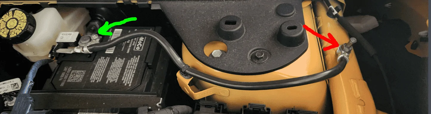

The Bronco Sport (and essentially every modern vehicle) is *negative* ground. This photo shows the negative battery terminal connected to the fender:

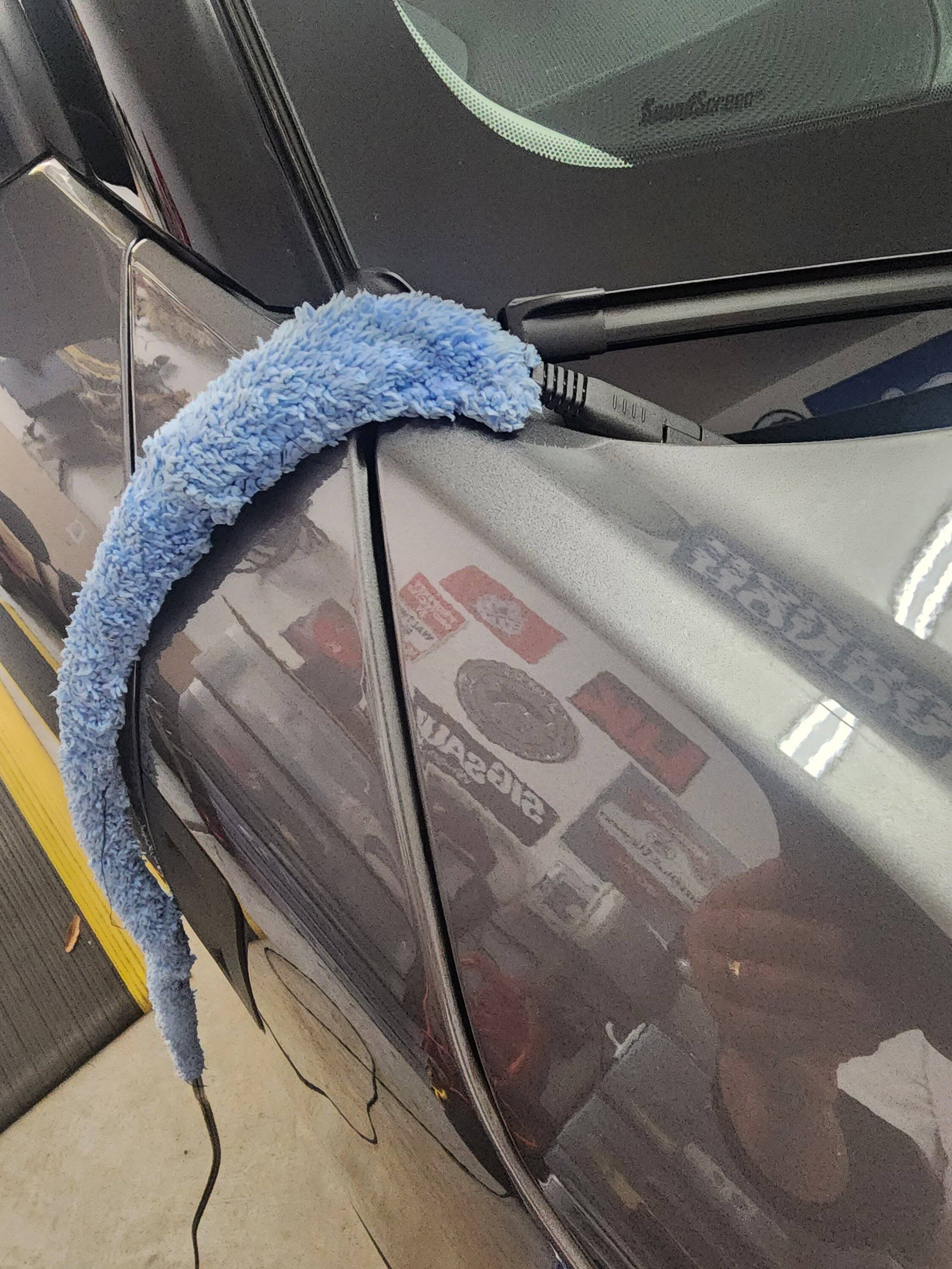

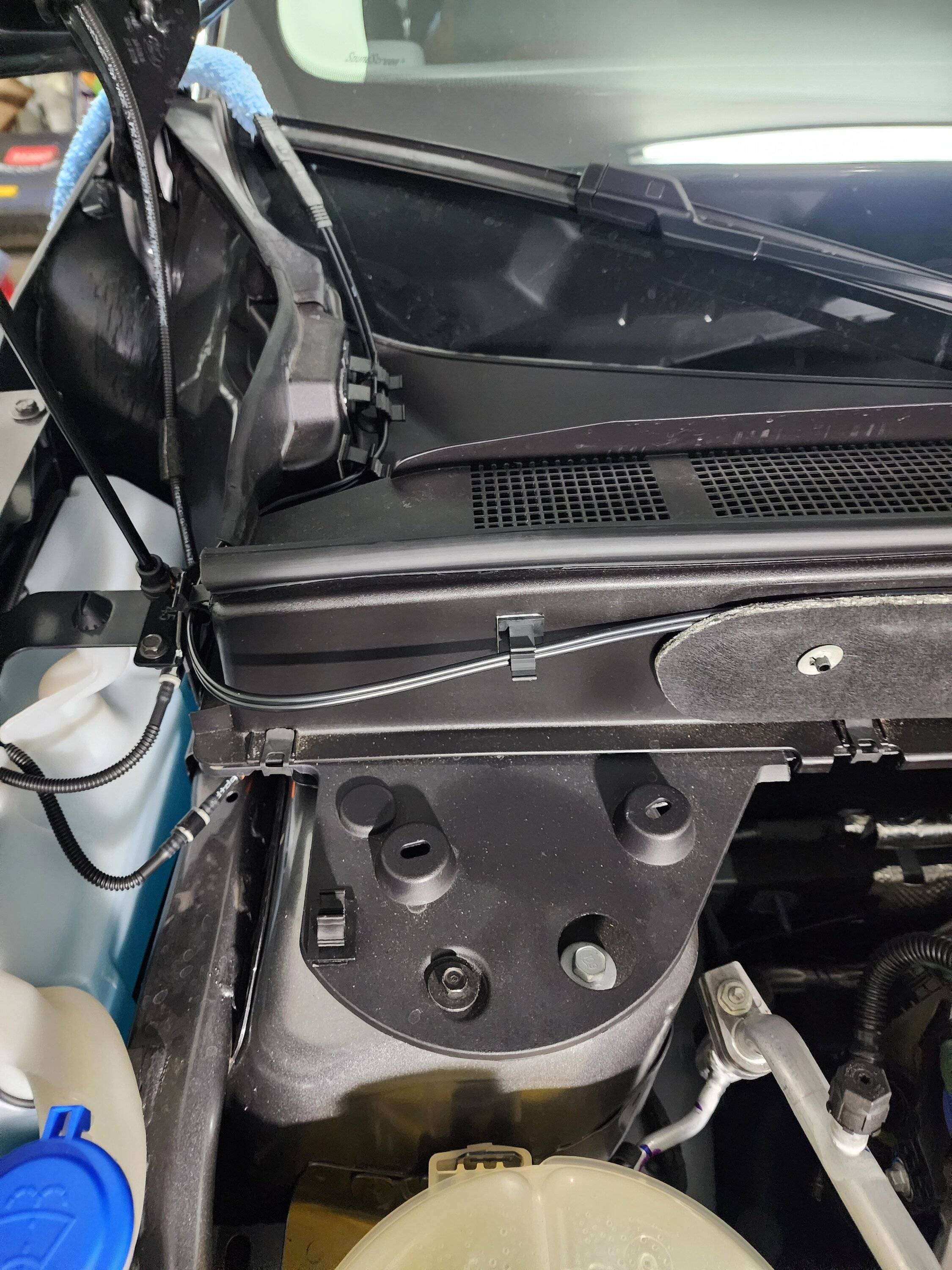

No opening the hood here. I have the wire coming out from under the hood. When not in use, I cap it and just push it back under the hood. On a trip, when I'm not going to use the battery maintainer, I push it even more under the hood onto that lower clip to keep it even more out of possible rain.

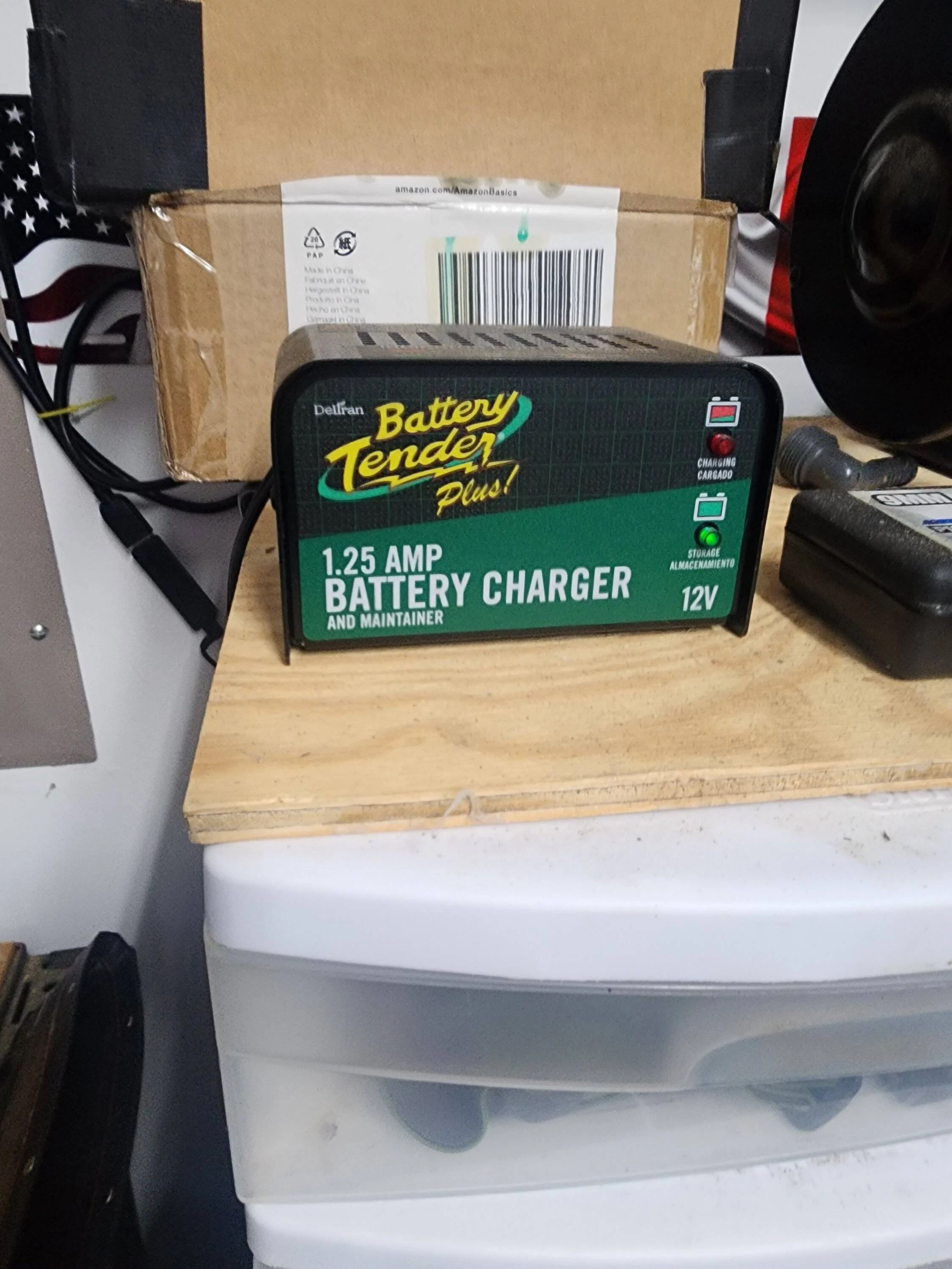

I've used Deltran Battery Tender Plus models for over 25 years without a problem. Replaced one after 20 years just to get a new one. 20 years was enough.
Ford Bronco Sport Trickle charger advice 20230811_151934
That's the model we use to maintain our RV's chassis battery. We won it at a RV show in Hershey about 15 years ago. It's been in almost constant use since then.

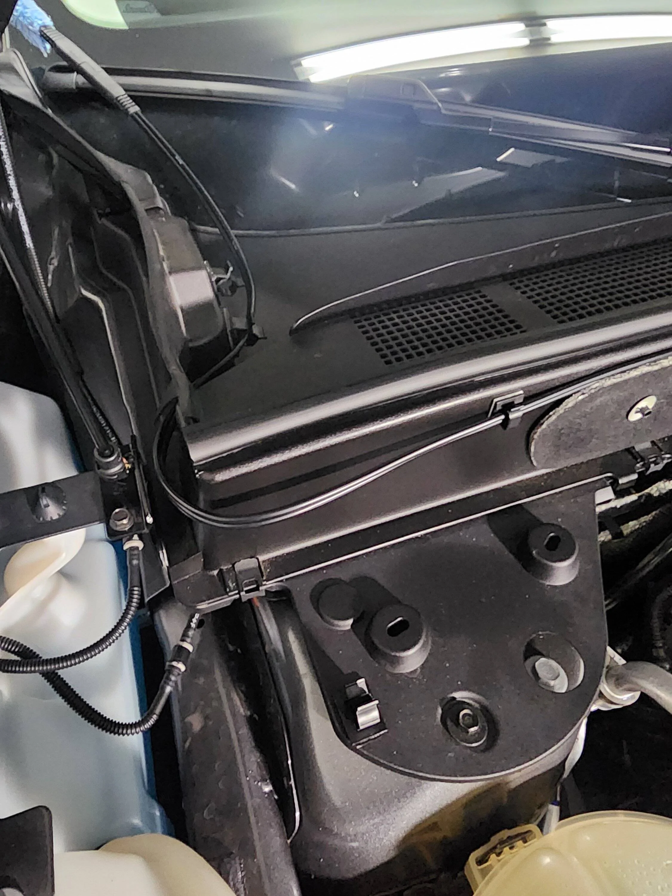

Ford Bronco Sport Trickle charger advice 20240116_175829
Ford Bronco Sport Trickle charger advice 20231029_143825
