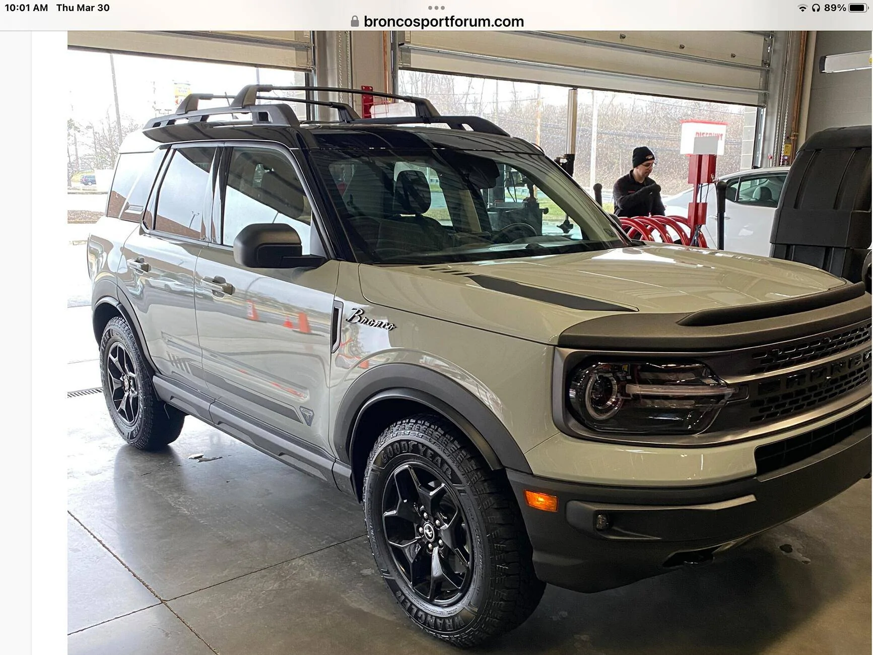

I ended up with Goodyear Wrangler Workhorse ATs. They are 30" tires. I tried to fit it in the spare tire space, and even with the sound deadening pad taken out it doesn't quite fit. It leaves a couple of inches of space below the tire, so it raises the cover a couple of inches. Not a deal breaker. I'm willing to lose a little cargo space for the added clearance. I'll figure out something I need to store under the spare. I do turn the spare upside down to get storage space.
