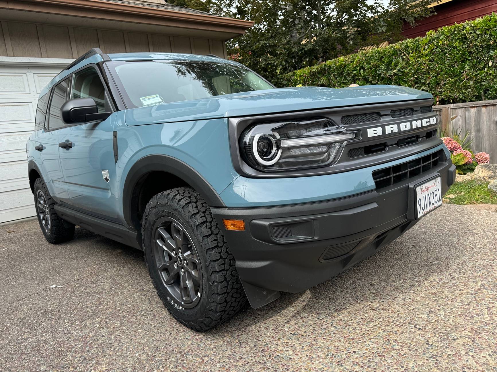

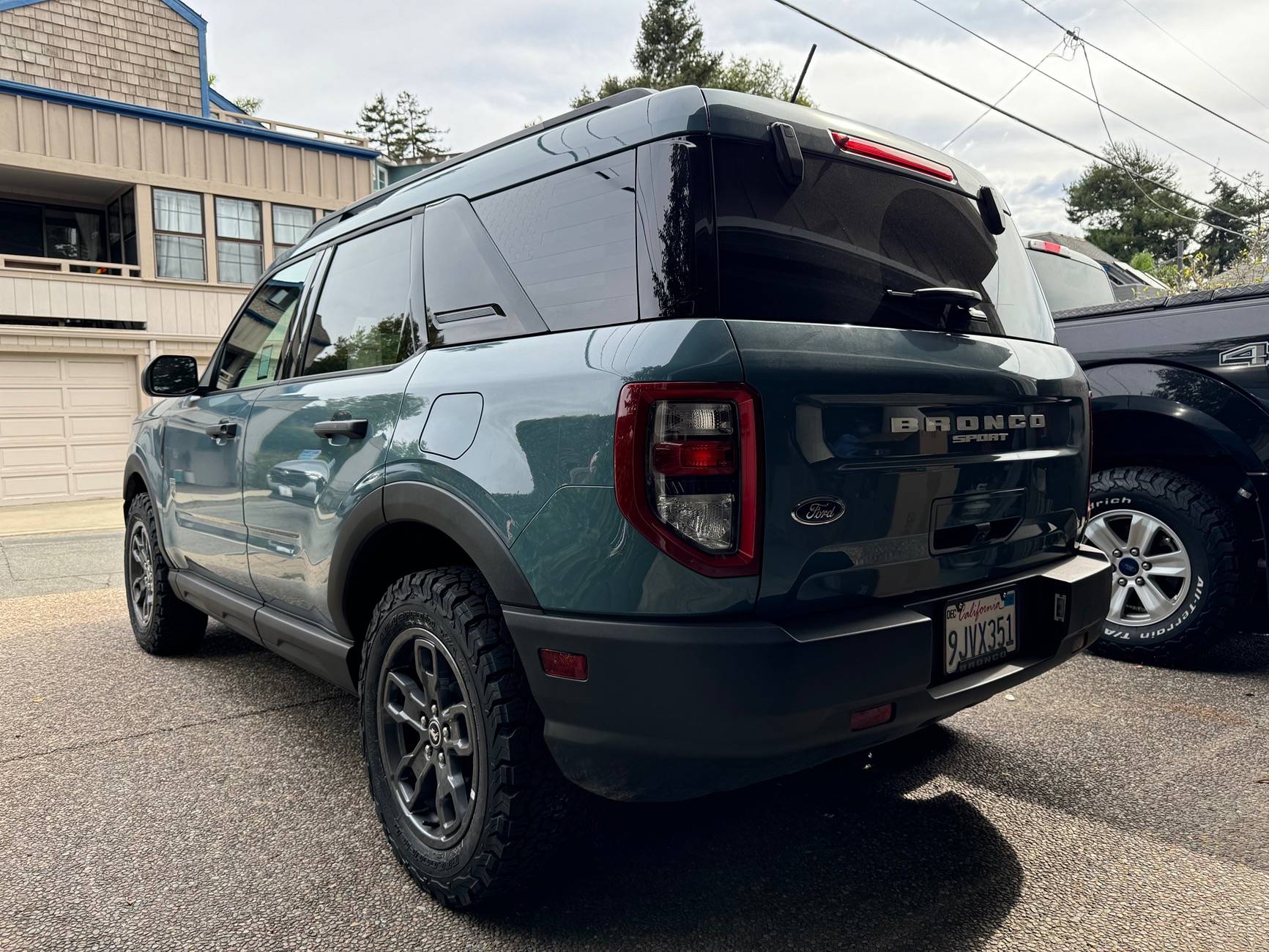

Here are some photos. Stock Big Bend, stock K02’s (225/65-17).
Ford Bronco Sport Tires, again...225/65R17 IMG_1835
Ford Bronco Sport Tires, again...225/65R17 IMG_1832
Ford Bronco Sport Tires, again...225/65R17 IMG_1831
