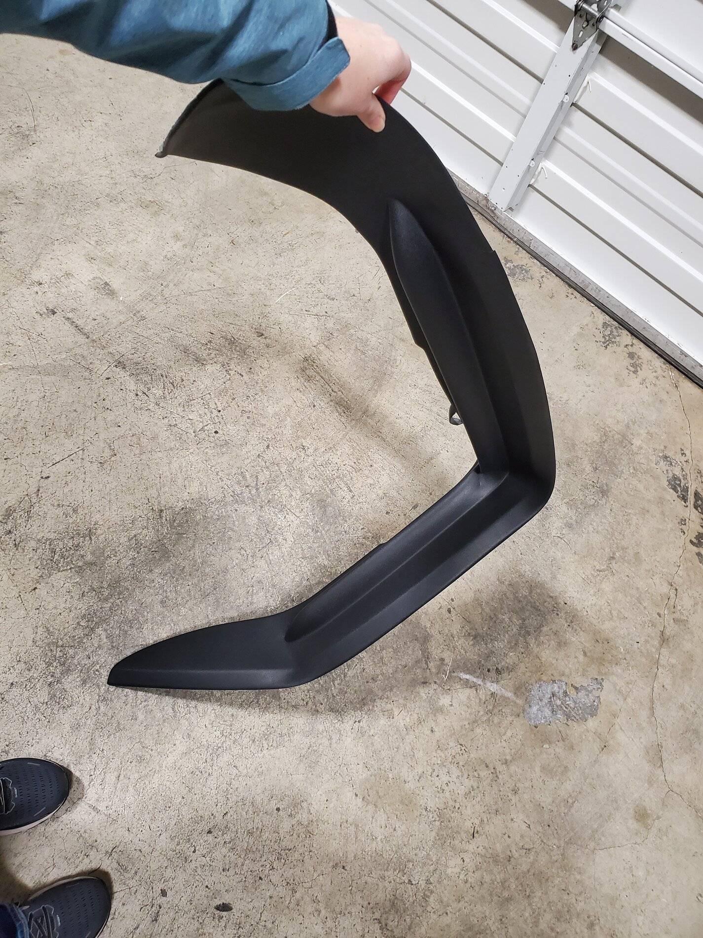

Good to hear you were successful in removing , how much time did you have into it ? If I might suggest why not try one of the clear raps for the front end check out some u tubes on that . Good luck . Enjoy
I am considering a clear wrap. Removal probably took 30-40 minutes using a hair dryer to warm up the adhesive, and then having a friend help peel it off. The deflector didn't exactly make it out alive, but the Bronco did so I'm satisfied!

Did you have any paint fade or any change in the look of the hood .Do you happen to have taken a picture afterwards . Good information to have , thanks jim from Pittsburgh

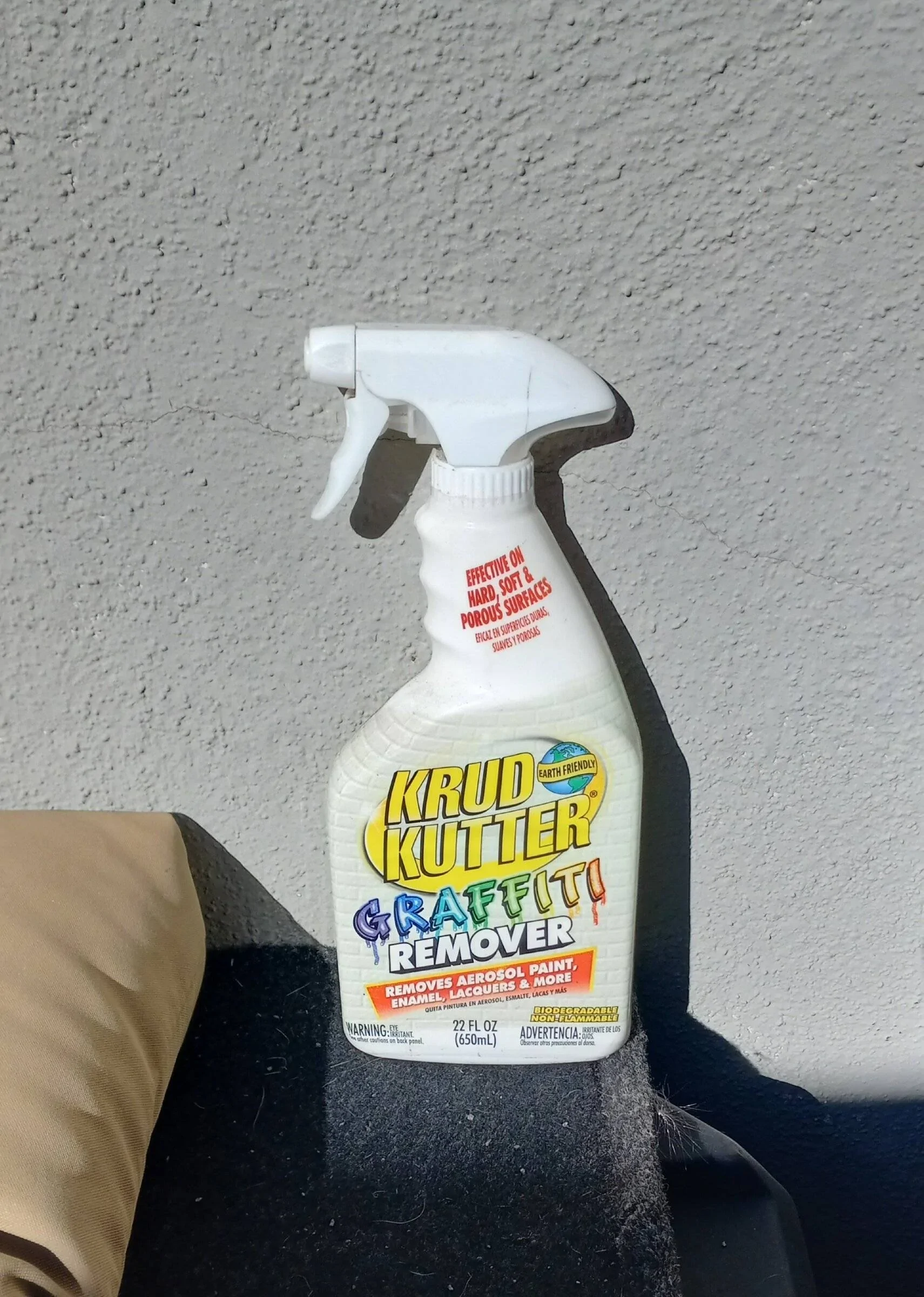

Glad you removed okay!
Just to add
Had spray can overspray on my truck that had been there and dried. went and put this on. sprayed some on a Q-tip just to see in a small spot how it would do. took off the spray paint overspray. No problem to my original paint.
Just sprayed it on Let It soak in for a moment 15 seconds wiped it off with a cloth. Little rubbing. Bingo!
It will work on removing sticky adhesive also like gorilla tape, duct tape, 3m tapes.
Ford Bronco Sport Tips for removing Aeroskin II Hood Deflector? 20220125_134136
Have used it when brushed my trucks bumper up against a dumpster blue paint scuff...took the blue paint off of my front bumper. Used it on a neighbor's lower Valance where he had scraped a red curve. in no situation did it disturb the paint on the vehicle.
* do your own research before applying. Test small sample.
Purchased at Home Depot
