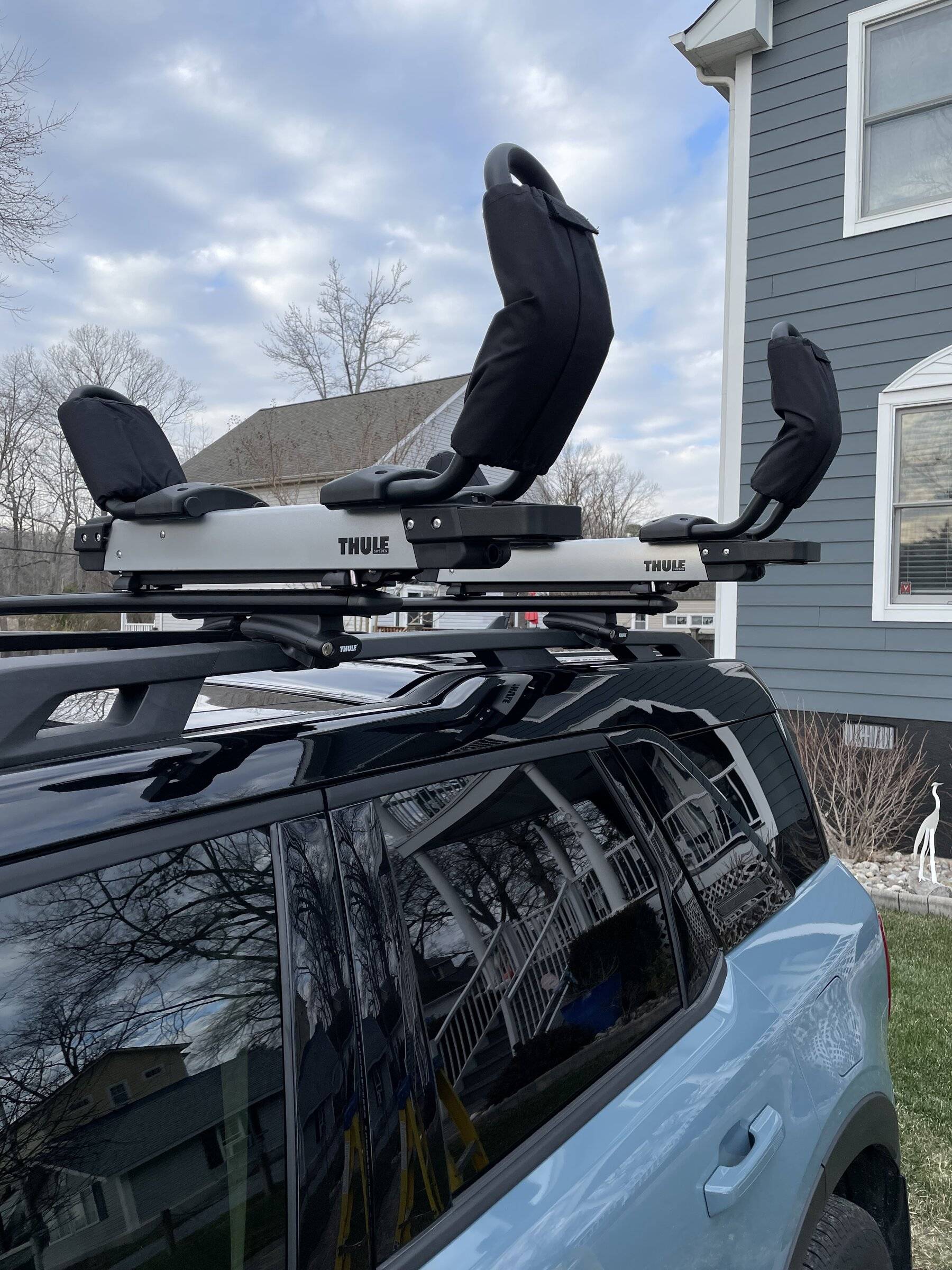

To answer some questions, especially the OP's, I have the opposite rig: Thule Wingbar Evo crossbars on Thule feet, and Yakima kayak assist. I already had the feet from a previous car that used 43" bars. These bars are 53" and I have no issues with the length. Not sure of the height of the Yakima vs the Thule (the Thule seems higher in pictures), but the BS is fairly tall as is. Add the bars and the carrier, and you'd have to have pretty high garage doors to fit everything. Anyway had a 4 hour road trip last to Vermont week. Everything was rock solid there and back. You may not have tightened the feet enough. My assist works great. I just wish it were a little shorter so I could fit 2 up there without having to buy the 60" bars, but then I'd be way over the weight limit anyway.
Ford Bronco Sport THULE or YAKIMA - LIFT-ASSIST KAYAK CARRIER? IMG_2067
