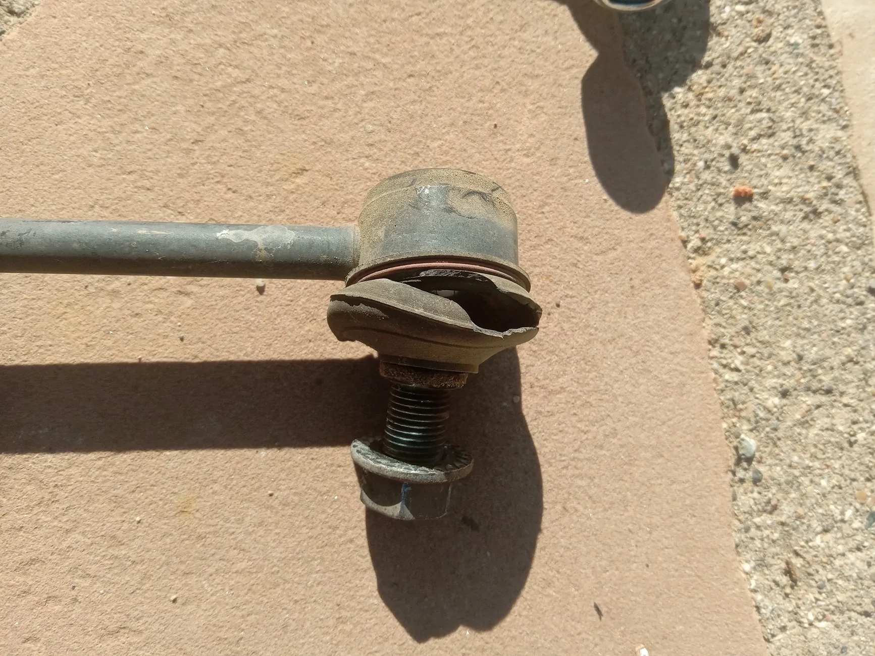

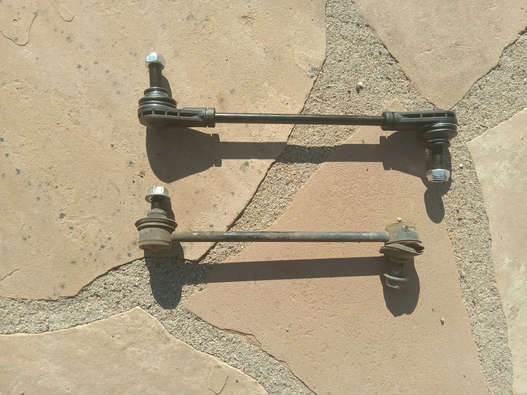

I received the HRG Offroad end links a couple days ago and today installed them.
The driver's side old link was the worst, the right one wasn't shot but the rubber in them was flattened and cracked.
Maybe they failed early because they weren't the right length ? The old links are a good 1.5 inches shorter than the new HRG ones. When the lift kit was installed at the other Ford dealer, they should have used the new longer links that came in the kit, looks like maybe they didn't.
The old links have regular nuts that don't stay tight, so maybe they were the Rough Country links ?
The new ones have Nylock nuts.
I took it for a test drive, no more annoying clunk. :D
