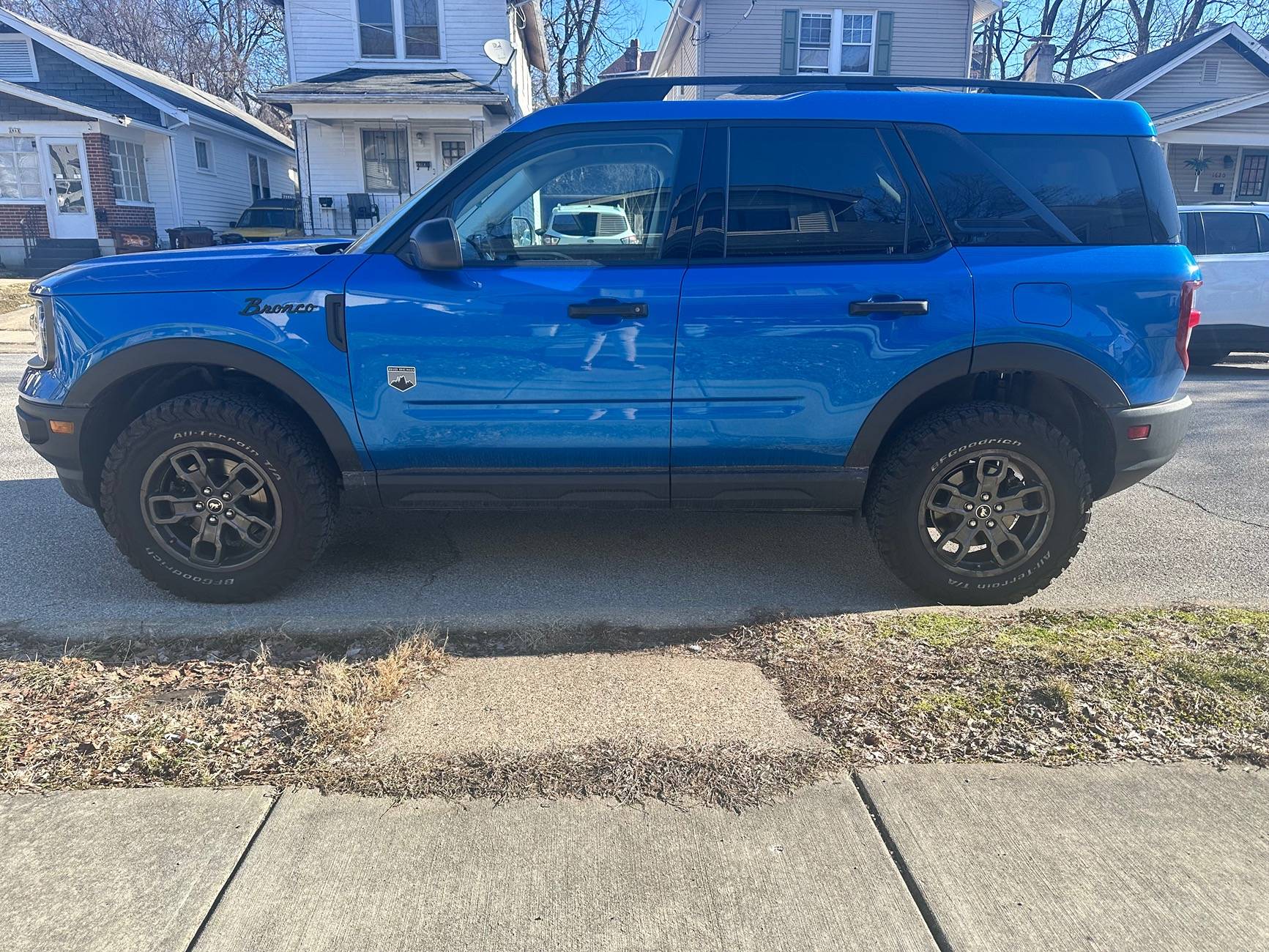

Not really sure what the tire size will be at this point, was basically going to decide that once the springs are in place so I can have my tire guy let me know what will fit without rubbing. If one tire is a bit smaller/shorter (the spare) than the other three, won't it mess up the AWD system?
I have a 2.0” Eibach spring lift and I can confirm that it does not matter as far as tire size goes. I have been running 245/65 even before the lift and they do not rub lock to lock at all. Here is a pic of my Baby Bronco after the lift was installed.

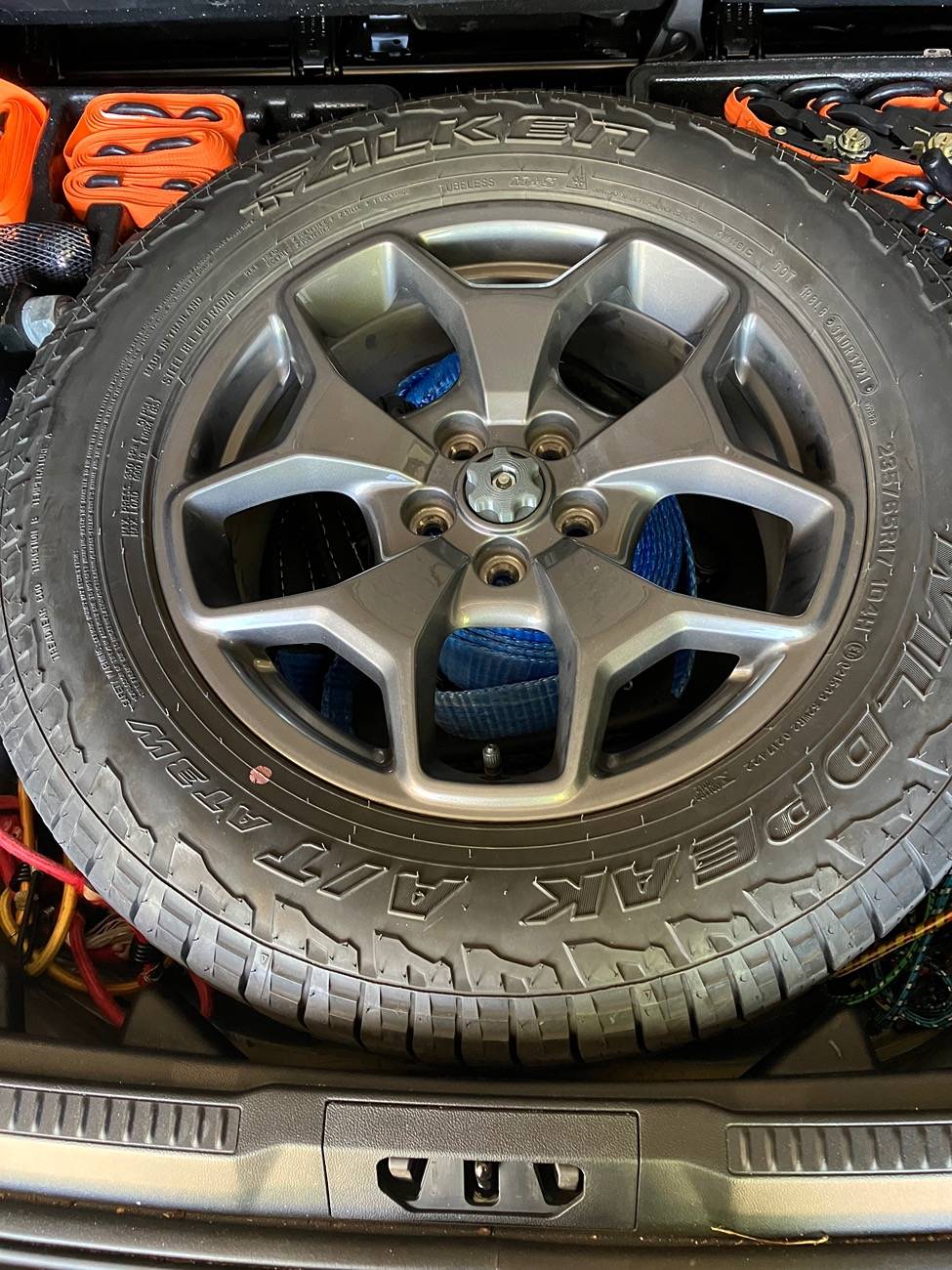

The 235/65-17 fits fine. The only issue is the threaded rod holding down the tire isn’t long enough with a spec wheel. I just designed and printed out a nut. You do need to use the upper cargo mat shelf but that was the same with the 225/65-17 spare.
