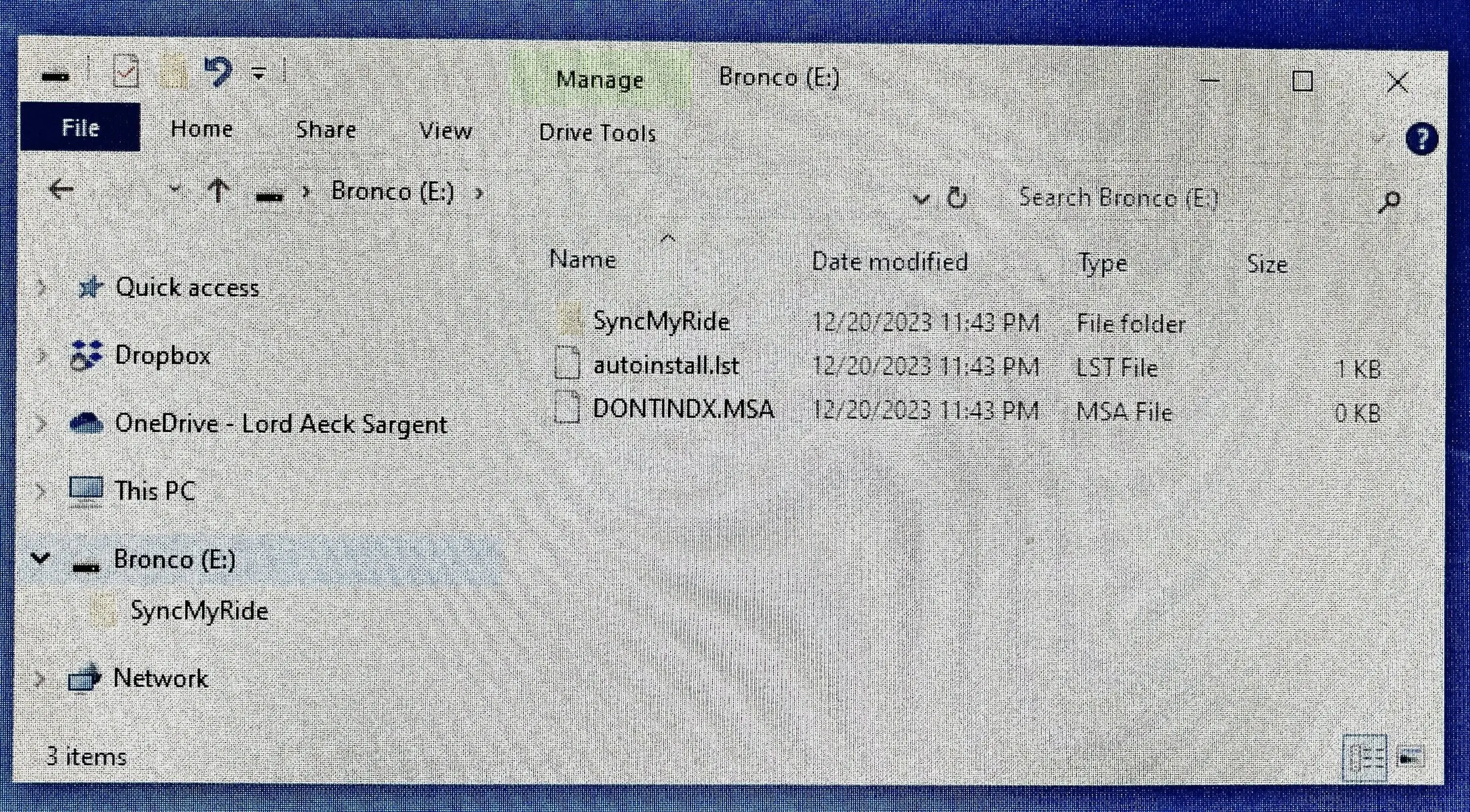

Please post screen shots of both folders on the USB Device so we can see the folder names, folder contents and file sizes (in step 3 you stated “…3 downloaded files” which would not be correct)
Some screen shots regarding my USB and what is on it when I head to the car.

@SeaJay your files and the one folder are a 100% match in filenames and file sizes to my 23188 USB Drive except two in the SyncMyRide Folder:
Yours:
5U5T-14G391-BS.tar.gz 1,511,368 KB
HB5T-14G386-VAB.tar.gz 25 KB
On my 23188 USB Drive downloaded from Ford Navigation Website 9/5/2023 is:
5U5T-14G391-CS.tar.gz 394,753 KB
HB5T-14G386-VBB.tar.gz 25 KB
I also checked to the 22251 USB Drive and it has the same 5U5T-14G391-CS.tar.gz 394,753 KB file and HB5T-14G386-VBB.tar.gz 25 KB file (other files differ from 22251 to 23188 just not those two).

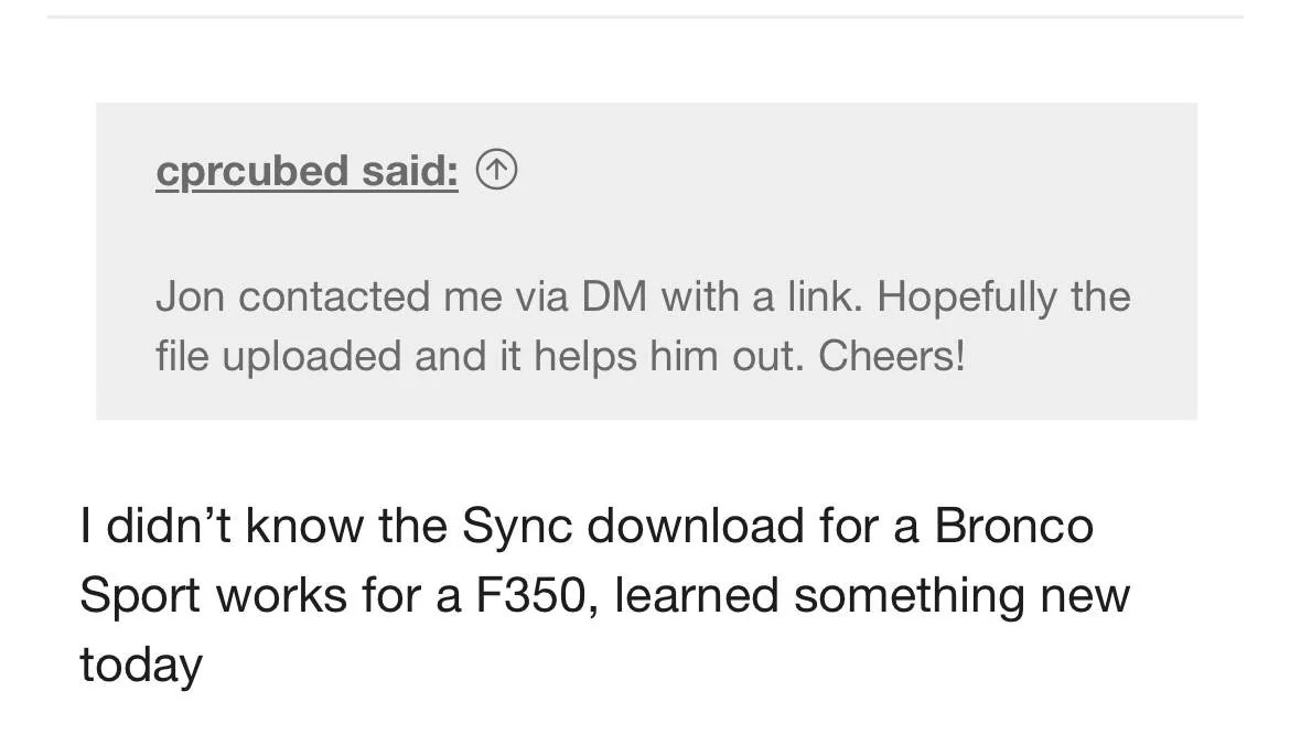

As cprcubed mentioned, a number of people successfully used the provided Google drive files including this person that apparently installed on an F-350:
Ford Bronco Sport Sync 3.4 Build 23188 Now Available 9/2/23 1703300422413

@SeaJay more info and I see the issue, the autoinstall.lst file is indeed looking for the 5U5T-14G391-CS file and in your SyncMyRide Folder you do not have that file… you have the 5U5T-14G391-BS file.
You will need to track down with @cprcubed if the provided Google drive contains the incorrect 5U5T-14G391-BS.tar.gz file or contains the correct 5U5T-14G391-CS.tar.gz (394,753 KB) file.
If Google drive is correct, you will need to find out how you got the incorrect 5U5T-14G391-BS.tar.gz file on your USB Device.
Once you delete 5U5T-14G391-BS.tar.gz file from your USB Device and add the correct 5U5T-14G391-CS.tar.gz (394,753 KB) file, then your 23188 installation should work ok.

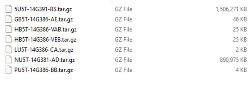

@cprcubed .. can you check the autoinstall.lst file in your Google drive to see if it refers to the 5U5T-14G391-BS file?
if it does then SeaJay like all the others that used your Google drive files should be able to install 23188
(it just seemed odd to me that the 5U5T-14G391-BS file is present in your Google drive but is only odd because my download had a different file: 5U5T-14G391-CS with a much smaller file size - I don’t know why there would be this difference)
These are the files I had in mine after the download.
Ford Bronco Sport Sync 3.4 Build 23188 Now Available 9/2/23 Screenshot 2023-12-23 at 8.51.47 PM

My files in SyncMyRide Folder match @Jmuns … there are two different filenames in @cprcubed list (see Post #125 for the 2 filenames) which appear to be “older” files based on filenames but later when I get time I’ll use the Ford Sync decoder ring to check the 2 different files.
The autoinstall.lst file (one level up) controls the installation and since cprcubed files work for several people I am assuming autoinstall.lst matches the list of the posted Google drive files but since I don’t have the autoinstall.lst file from @SeaJay I am not able to see if that’s the source of SeaJay’s install failure.
