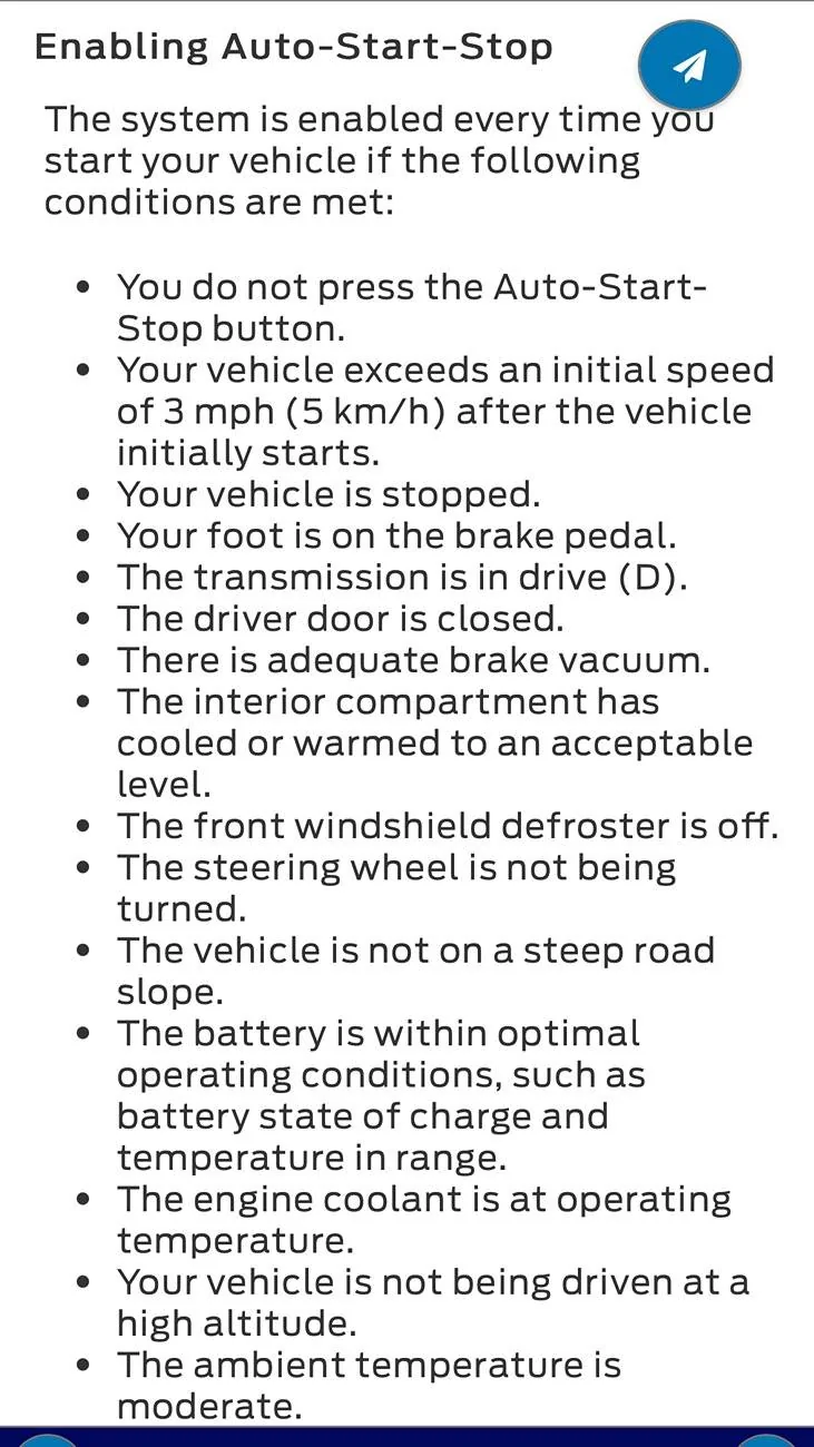

see posts #4, #40 or your owners manual for a list of reasons why auto stop start does not engage
