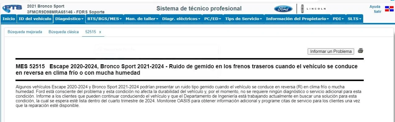

I have a 2021 Bronco Sport Badlands, I get the noise only i the mornings when I reverse. I read in these forums about a TBS the dealer here in the Dominican Republic first confirmed with Ford that it applies here, then they said there isnt a solution yet...
quote: "Some 2020-2024 Escape and 2021-2024 Bronco Sport vehicles may experience a whining noise when the vehicle is driven in reverse (R) in cold weather or high humidity. Ford is aware of the problem and this condition does not affect the durability of the vehicle and at this time no additional diagnosis or service is required for this condition. Inform customers that they can continue to drive the vehicle and that the Engineering Department is currently working on a solution for this condition, which is expected to be ready within the fourth quarter of 2024. Monitor OASIS for additional information and schedule service appointments. service for customers once repair is available"
