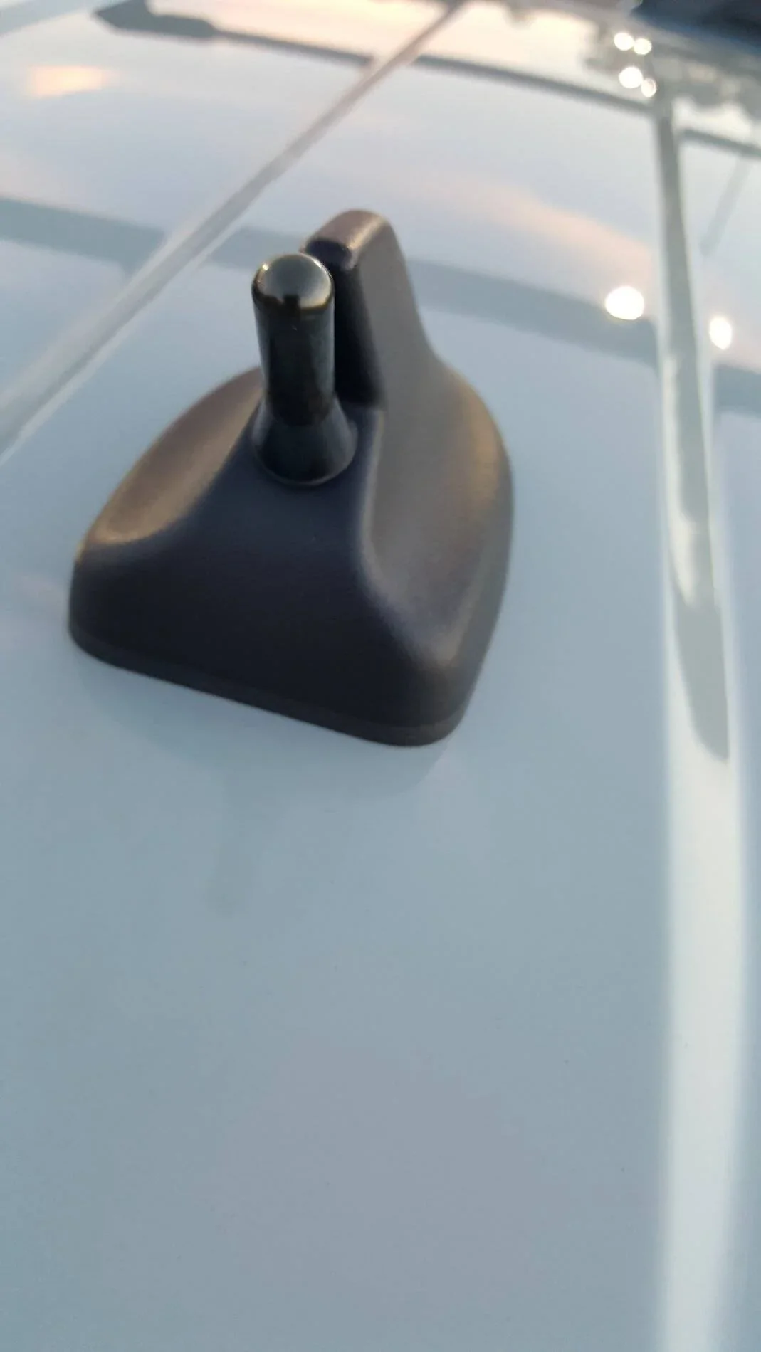

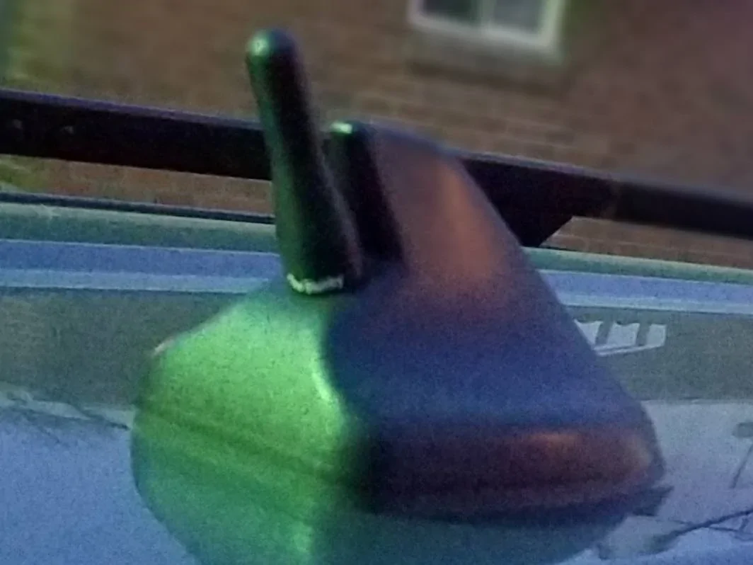

It worked! If you are looking for a shorter Antenna, this is the one. It's about 2-3 inches shorter than the stock antenna and the signal does not change. I live in an extremely hilly area and all stations (AM/FM/HD/XM) all work just as well. Use the smallest gold screw when you install it and have a pair of plyers with you too. Screw the gold part into the car first then attach the antenna on the gold screw. Attaching the gold screw into the antenna first makes it a little more difficult since the thread on the screw is better where is makes contact with the car and not the antenna if that makes sense. The plyers are for get the screw out of the roof in case you pick the wrong one.
Remote start and auto windows also still work. I don't know if they use the same antenna but just as an extra assurance.
